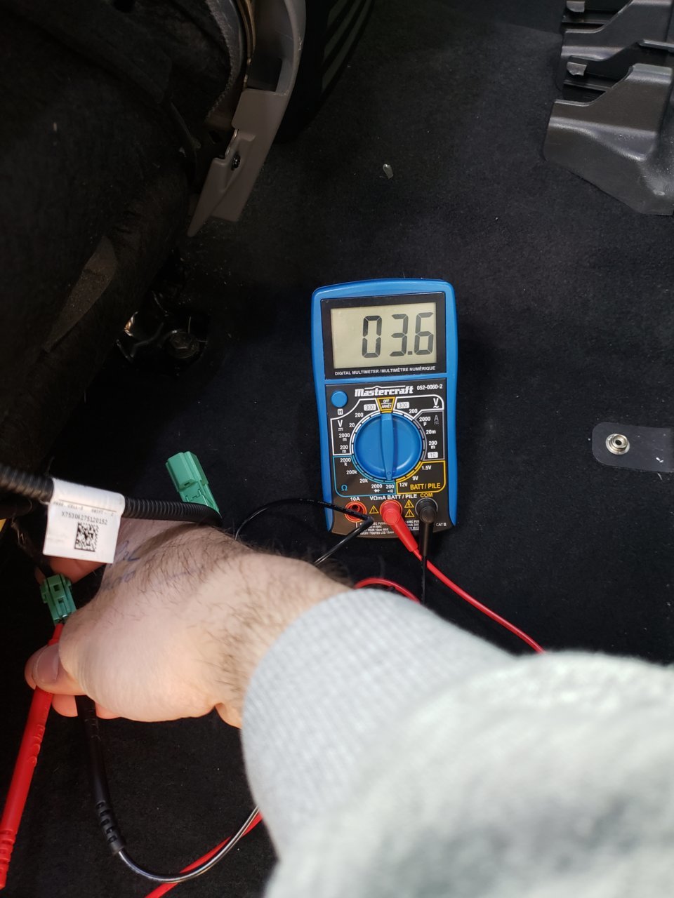

    Couple questions.
    1. Test the input and output of the other seat heater, do you get the same resistance?
    2. You have resistance, I’m assuming you have continuity, but I assume and then I feel dumb for assuming.
    3. Do you get 12 volts to the seat end of the harness when the switch is on? Maybe you have a breach in the power supply to the heater but the heater element itself is fine.

    1. Same resistance
    2. My dumbarse should've tested continuity prior to posting. 12 volts to the seat end of harness on passenger side. 0 to the driver side. Must have a breach.
    Not too sure where to go from here?
    (Mechanically I'm alright, electrically that's a different story... any help is greatly appreciated).

    The first place I'd look at is the owners manual for the truck or the underside of the fuse box cover to find out if the driver and passenger seat heaters use a separate fuse. If they're separate fuses check the fuse for the driver's side. The second place I'd look is actually the same place, I'd be looking to find out if the factory seat heaters use seperate relays which would also be in the fuse box. If the fuse(s?) and relays (?) are good then there is a breach in the wire somewhere.
    To look for a breach I would first find out what aftermarket accessories are on the vehicle. If anything is mounted to the floor that's where I'd look first. Then I would see what electrically those aftermarket accessories were attached to. Next I'd follow/trace out the harness that the heater wires are in and when I came across a plug I would unplug it and look at both sides of the connection terminals. After that first plug it'll probably be very difficult to trace and a wiring diagram would probably be needed.
    I would also check the resistance to ground on the seat heater with it unplugged because even if it shows the correct resistance within itself that doesn't mean that it doesn't have a short to ground inside the seat.

    @61FunGun I assume you checked the fuse. Did you compare that resistance measurement with the other seat?
    If the fuse is good and the resistances are close, I'd swap the switch.
    I don't have the factory heated seats so I'm not totally familiar with their wiring for it
    The ones I installed in my truck, have a variable control vs high/low. The variable switch, if you have it, could be the issue.
    Edit. Compare voltages between the seats as well. If you can do that with everything plugged in, even better.

    3.6 ohms to both driver and passenger.
    12 volts to passenger. 0 to driver.
    Fuse is good.
    Going to try swapping the switch and see what happens!

    If that doesn't work, listen for a relay clicking when you turn on the working seat. Could be that as well.

    Is there a separate switch/fuse/relay for each side?
    If so, check fuses for continuity and swap relays.
    If not, you have a breach in the wiring on your driver’s side.
