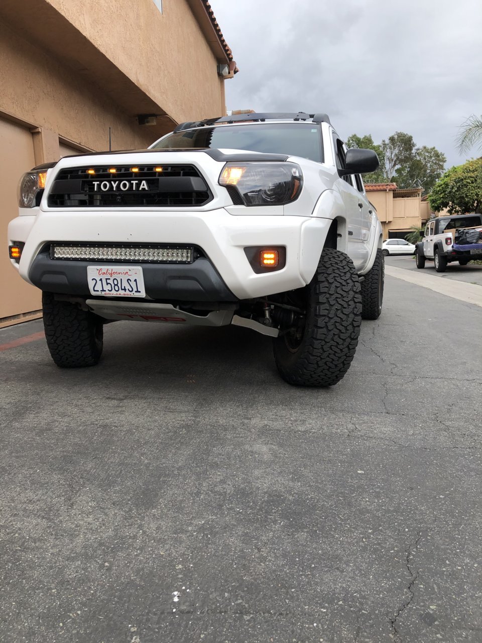

    Installed some RCI Metalworks lower control arm skids. Had to modify them to be able to fit with the TRD skid plate. Also installed some retrofits I just had done.

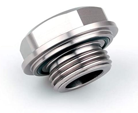

    I hear these get hot as a mofo!

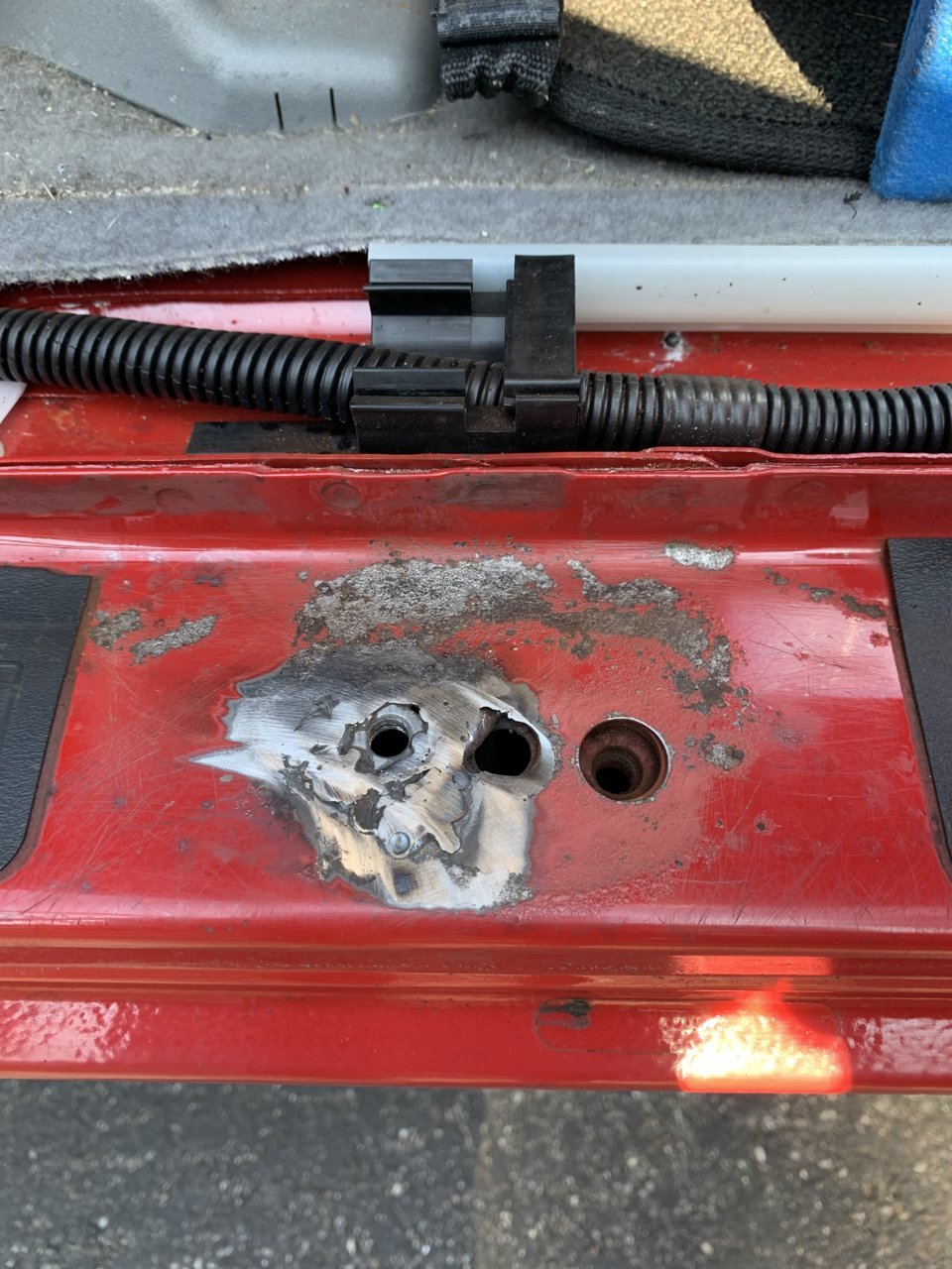

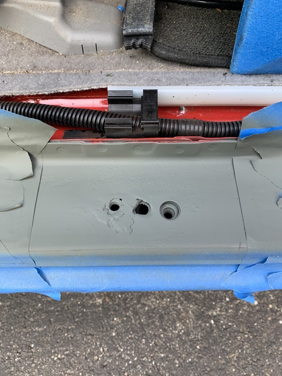

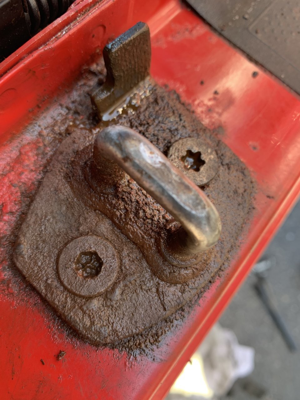

    Did some rust prevention today, which turned into far more of a project. Bolt was stripped out (assume from previous owner attempting rust prevention... wasnt me!) and had to drill it out. That insert then snapped and bent down inside. Welded a new bolt in (yes its offset but it fits well and door shuts perfectly). primed and ready for paint as soon as the colormatched paint comes in.

    Yea , it didn’t take me long to figure something would go wrong . I’d worry about it vibrating off while driving or something worse .

    Is there a problem with them? I haven’t noticed any yet

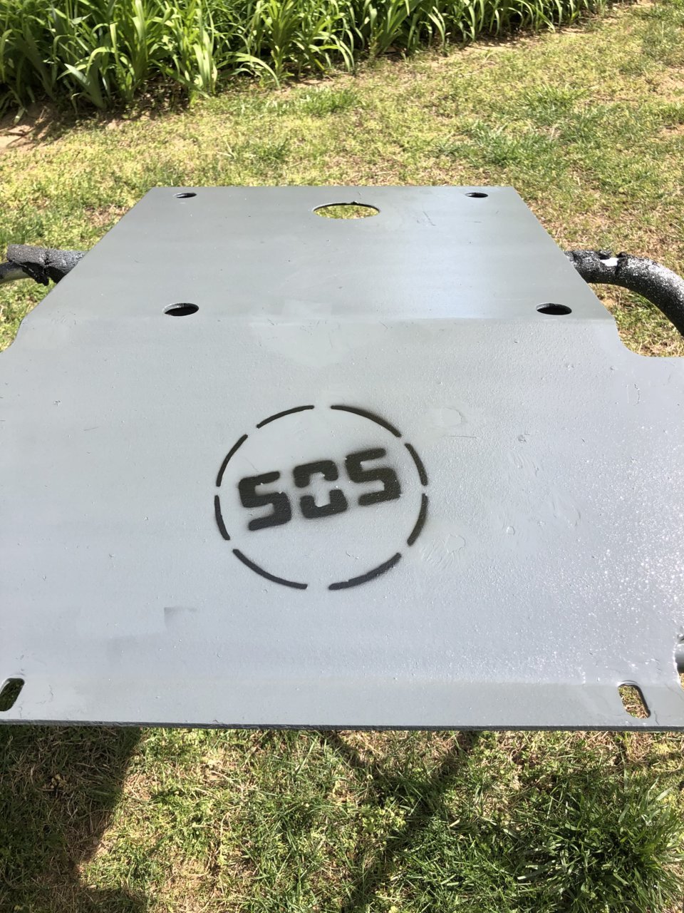

    Bored so dropped skids, greased driveline, painted skids, and reinstalled. I did have a little fun with it

    @Bigpat_ca says he heard they get real hot !

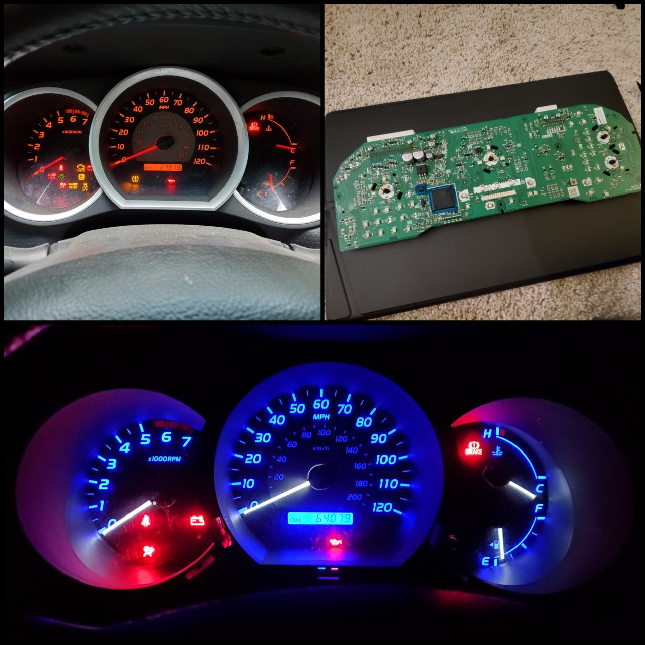

    Got some Taco power shots

    Is there a certain size of leds to use? I’d like to start this project soon and starting to do some research on it.

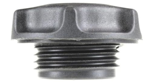

    It's going to get hotter than the OEM cap because it's made of Aluminum. Aluminum is a better conductor of heat vs the Plastic OEM Cap.
    As far as the cap backing out: The Aluminum cap and the filler tube are made of dissimilar materials. I don't know, It's possible. You add heat, oil, vibration and dissimilar materials... It's possible. It's not under pressure though. You could check it's tightness for a few months just to see if it's an issue
