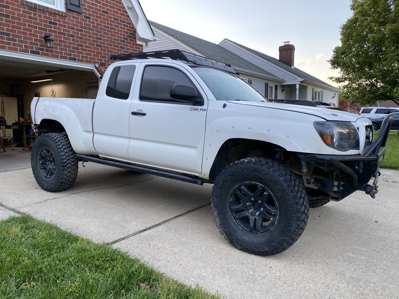

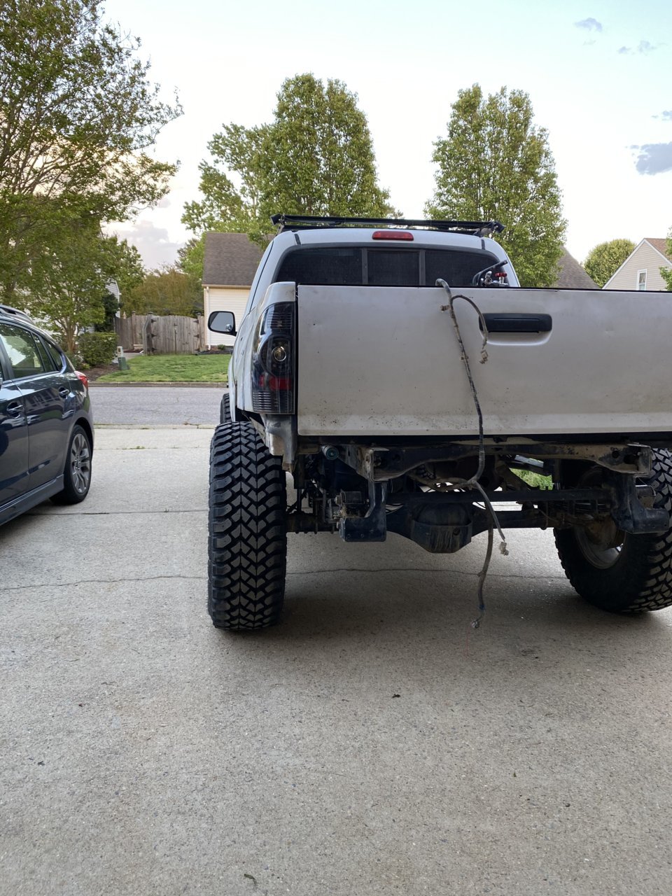

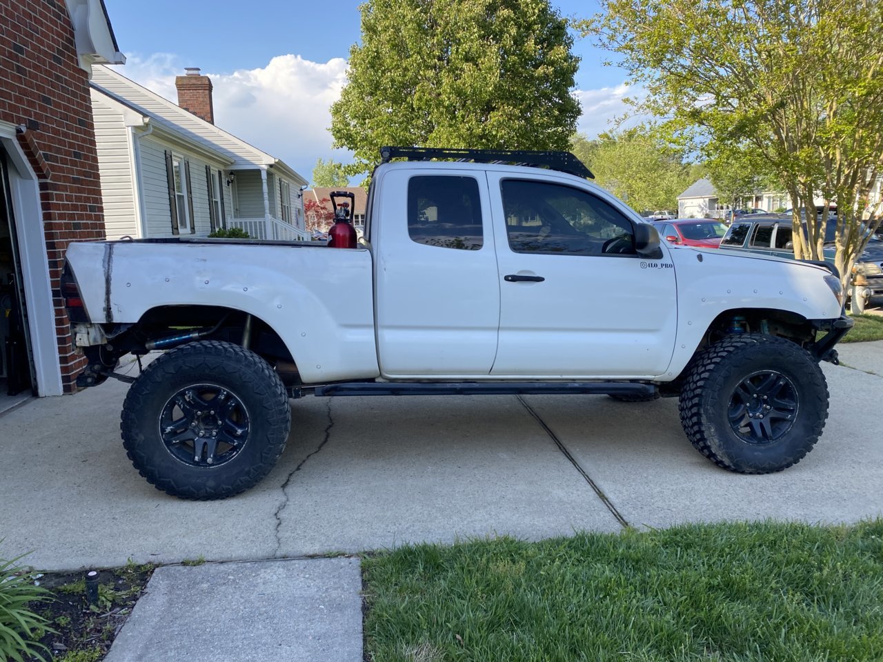

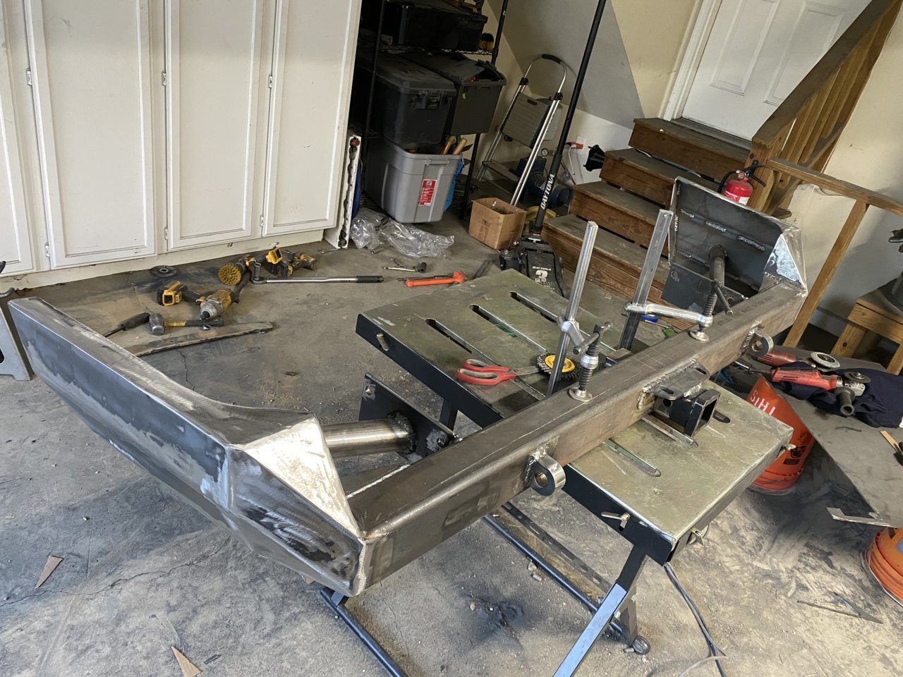

    Removed the AAL+one overload from my Dakar’s to drop the ass end down from 4.25” to 2.75”. Once I put my bumper and spare in the back it should drop a little more. Also did more work on the bumper, about 99% done.

    Did you coat/paint yours?

    Making your own? Also, why the drop in height?

    The Dakar’s were meant for 3” lift over stock with 660 lbs In the bed. Once I took all the stuff out of the bed, chopped out 14” and built a smaller bumper, I desperately needed remove some leafs to drop the height and weight capacity back down. Too much rake. And yeah I built that bumper myself, I’m pretty darn proud of it!

    bumper is sweet my friend
