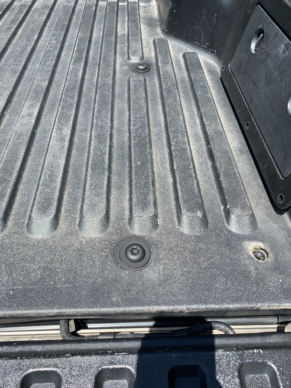

    How easy did your T55 bed bolts come out? I’ve been trying to get mine out for the last couple days with no luck. Gona have to dremel the head into a hex for a socket I think.

    My bolts were pretty bad. All but two came out with out an issue. the last two I took to my mechanic. They were able to muscle one out, but the last one they used an electric induction tool to break it loose, no flame involved with that.

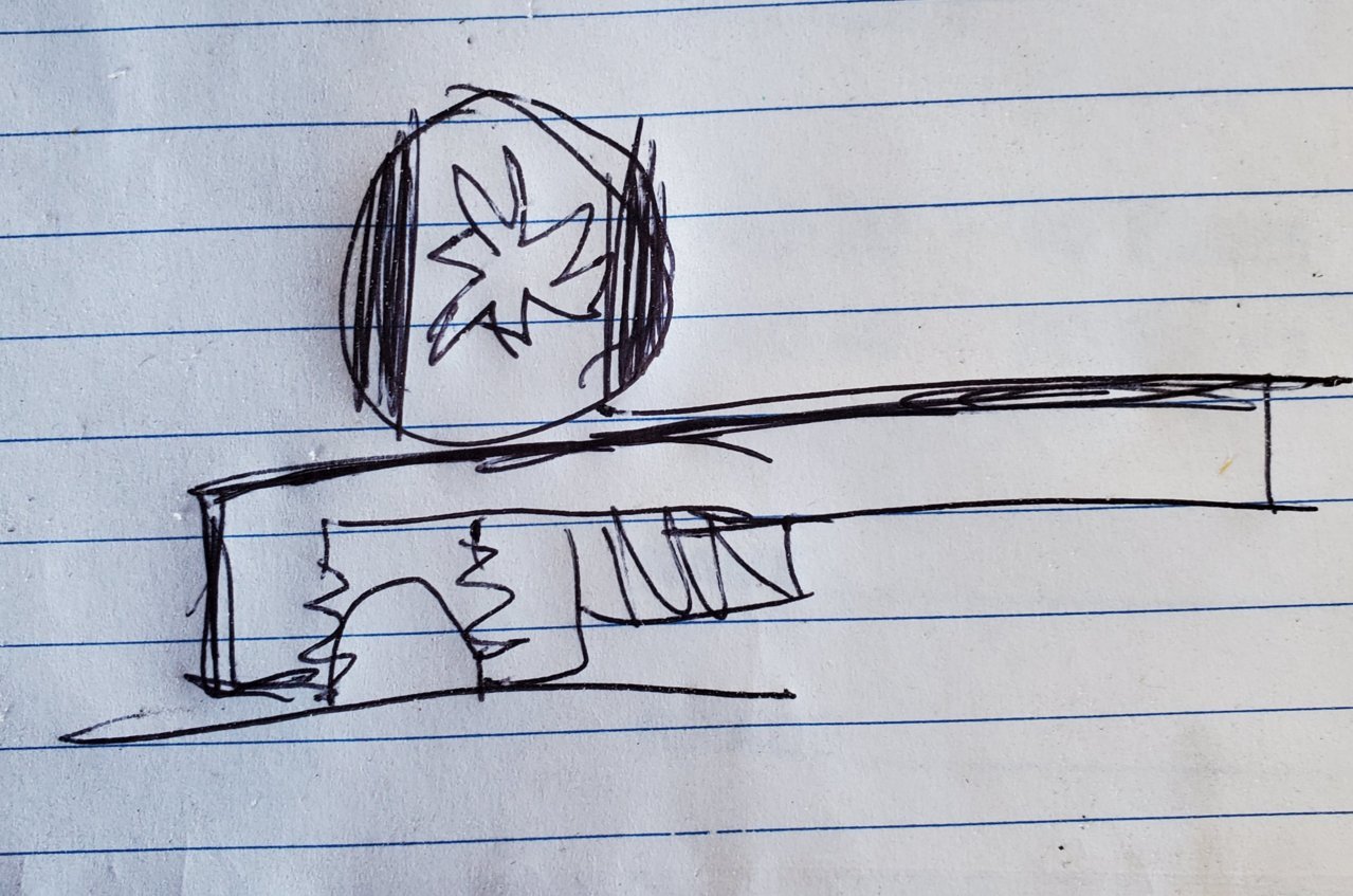

    You can get a pipe wrench on it if you strategically place the wrench and push down on the wrench to keep it on the bolt. If that doesn't work instead of a hex head chop off 2 sides and stand the pipe wrench on its end.
    Yes I am a true artist. Unfortunately I can't draw worth a damn. Lol

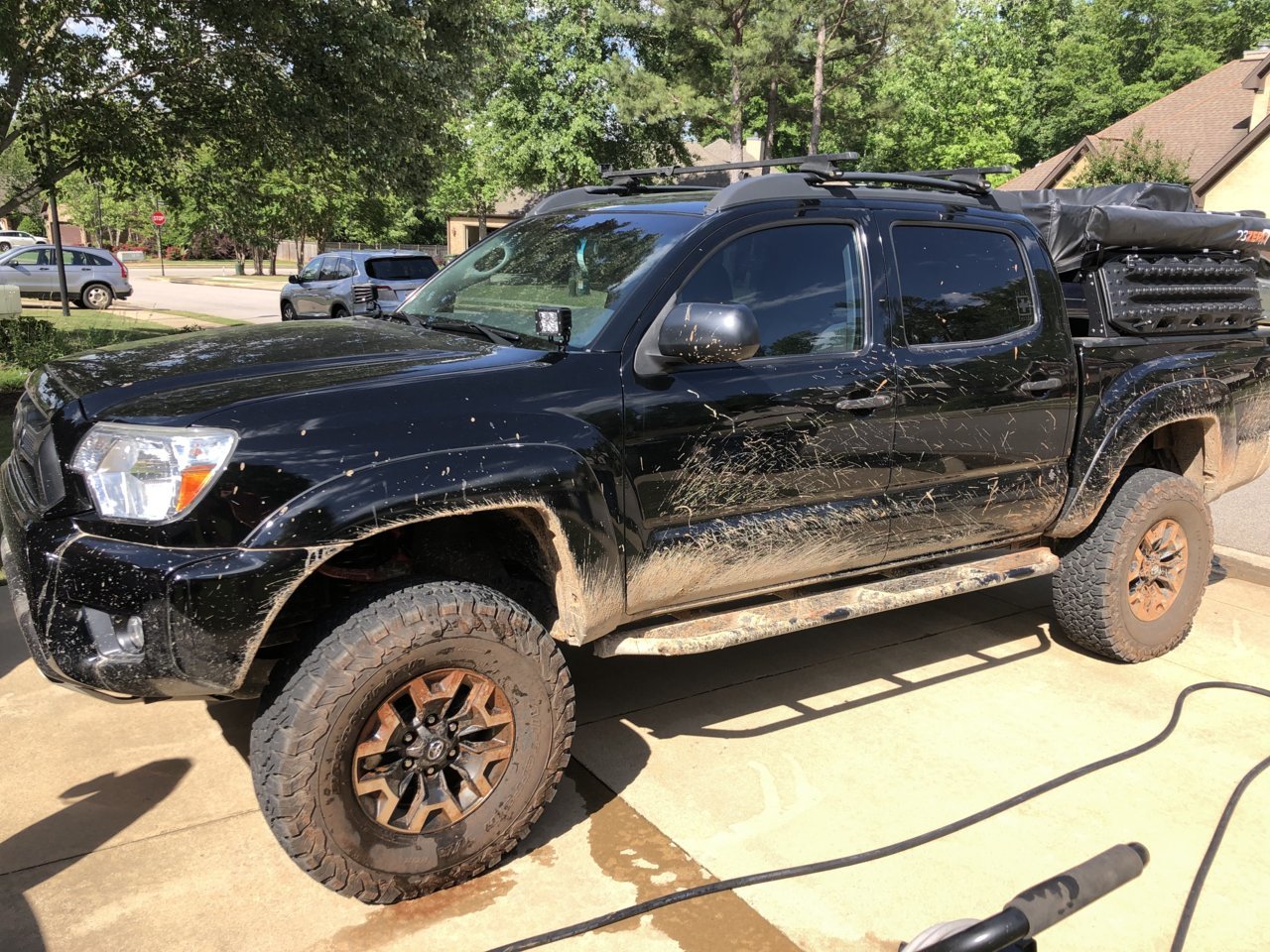

    Had a awesome day riding trails with other TW members! Figured I better go ahead and give the taco a bath when i got home.
    Before:
    After:

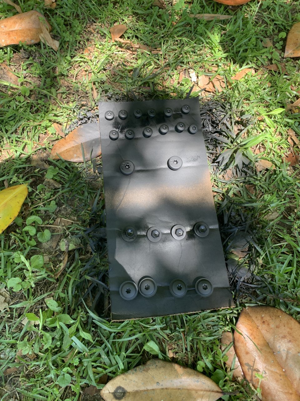

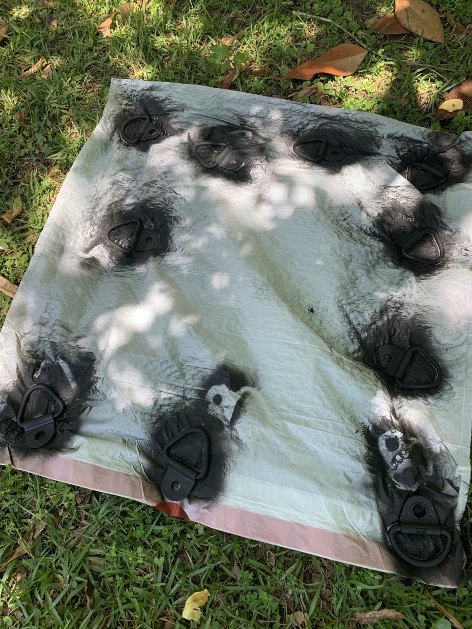

    I left mine in place, masked around them, and painted them in place. I had a feeling they would give me trouble so I left them installed this time around. Tiniest bit of overspray in the bed but hardly noticeable.

    When i took the front ones out in order to fix the bed clunk issue it maybe that i have the Truck Krown'd every year but i also used a 1/2 inch drive T55 impact socket/air impact wrench and it came out easy...
