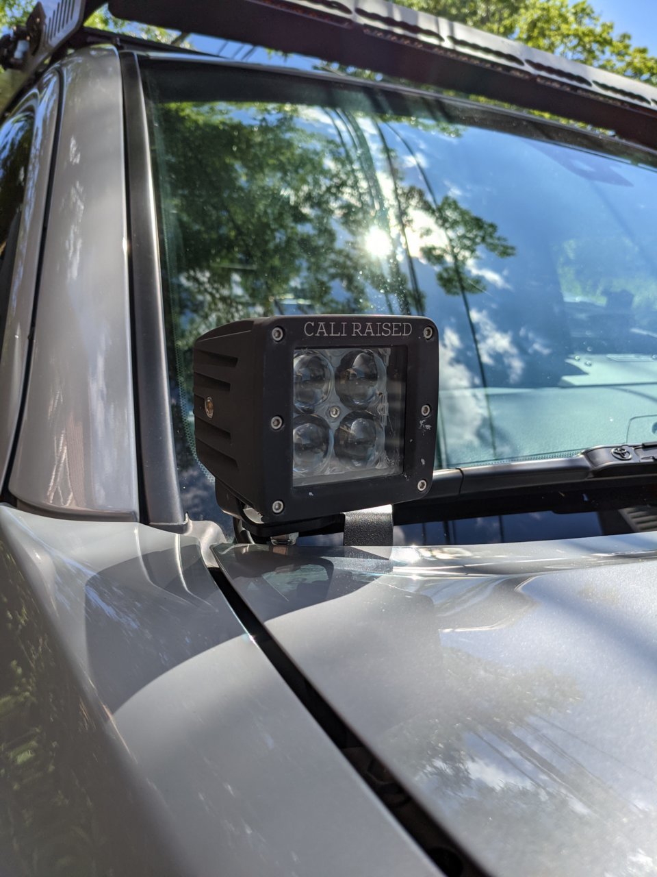

    Swapped out my CaliRaised Spots for Diode Dynamics SS3 Max Driving

    yea i was thinking of swapping out my caliraised pods. Im not extremely happy with them.

    The pods were decent but I wanted a change in lighting focus. CaliRaised is a decent option on the lower end of cost. I had some moisture issues with the amber pods but to their credit they replaced them and let me keep the old ones which I later fixed. However I have since moved on to ExtremeLED, Diode Dynamics, Baja Designs and KC. My 30in light bar from CaliRaised is still going strong though.

    yea i may go a different way and remove the ditch light all together. Still thinking about it.
    I agree their 30inch LED has been great

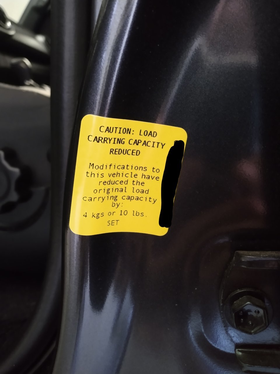

    No idea because I have added more than 10lbs with just the MX4 Backflip tonneau cover that was on when they did the fuel pump. Not even adding the tools and tie downs behind the back seat. So I have no clue how they come up with the modification weight. I have read on here they only put that sticker on for things the service dept adds. But like I said I had the fuel pump changed and the software updated. That's one heavy fuel pump or lots and lots of 1's and 0's.

    It's to protect themselves, a liability thing...as if anyone places a sticker for every time they add a sticker :D
