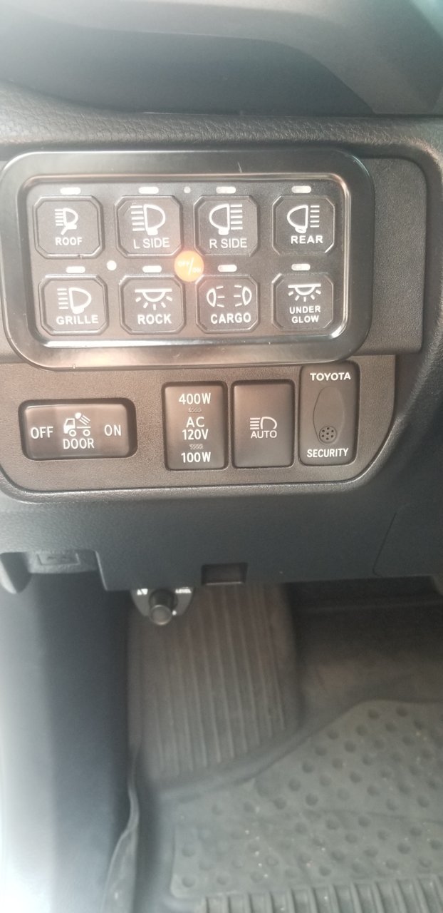

  1. Aug 1, 2021 at 1:57 PM
    iLLFadedBowl
    iLLFadedBowl Well-Known Member
    Jun 5, 2021
    #367742
    210
    2019 Super White TRD Offroad Tacoma
    Remote start w/ vehicle control and locator, Prinsu rack w/ Cali Raised Light Bar and 360 LED lights, LED Bedlights, Tailgate lock, 3" Lift, Wheels and Tires, Raptor Lights, LED headlights and fog lights, Blacked out LED taillights, Front windshield eyebrow tint, Rough country bed molle, 8-gang switch to control LEDS, Dominator D6 running boards/side steps, Blacked out sequential mirror turn signals

    I have the factory alarm. Is the GBS not available by itself?
    Edit: Lots of good info here: https://www.tacomaworld.com/threads/glass-break-sensor-add-on.664387/page-2

    Yeah that's the part number for the GBS add on kit. It gets confusing when its titled vehicle protection intrusion system and places like sparks call it the VIP security system for that part number. With that wording it makes you think it's the entire alarm system kit but it's just the GBS kit.

    So with the factory alarm there is no need for Techstream to enable. Just plug and play, correct? I have a kit on the way and I have a glass break tester and will test it after install.

    I didnt need techstream and most posts I've read others havent needed it either. I didnt think mine was working because the LED on the GBS doesnt come on when you already have the alarm system installed, and have the other alarm blinking light on the center dash. I also didnt realize the sensitivity was set to 0 out of the box and wouldnt pick up the taps on the glass. I cranked it all the way up and works with a light tap. Just wish it was even more sensitive and went off when you pull on handles and bump the car. But it is a glass break sensor so not designed to pick that up.

    Did you have to add a harness or anything to make this work ?

    The toyota OEM kit comes with the harness, the module, and the sensor.
    Edit: Nothing extra needed to install. Someone posted the install instructions above. It says to disconnect the hood latch from the dash panel but that's not necessary, and more a pain in the ass to reconnect than to work around it. And always disconnect the negative from the battery before unplugging any harnesses in the truck.
