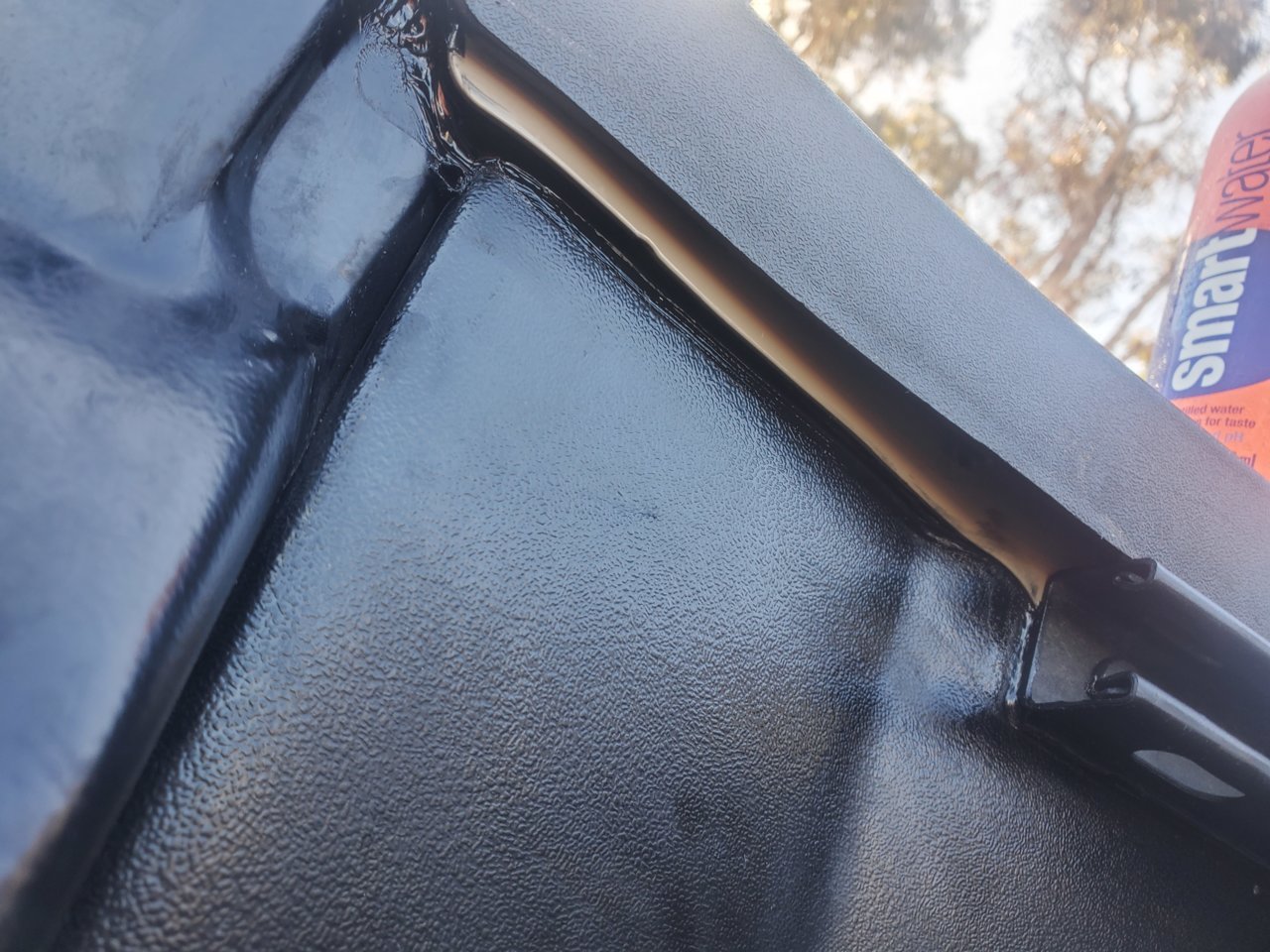

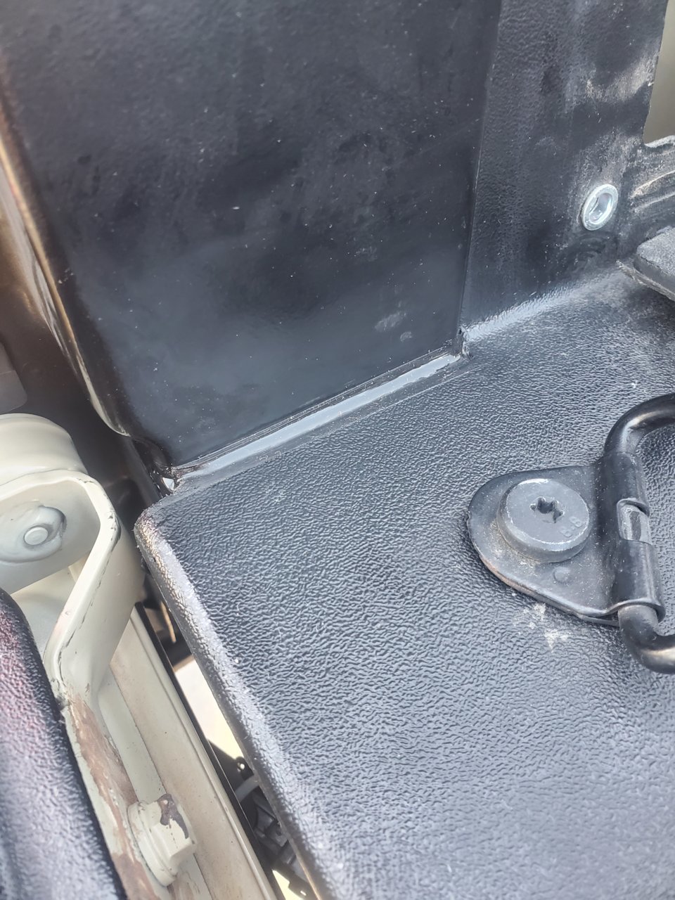

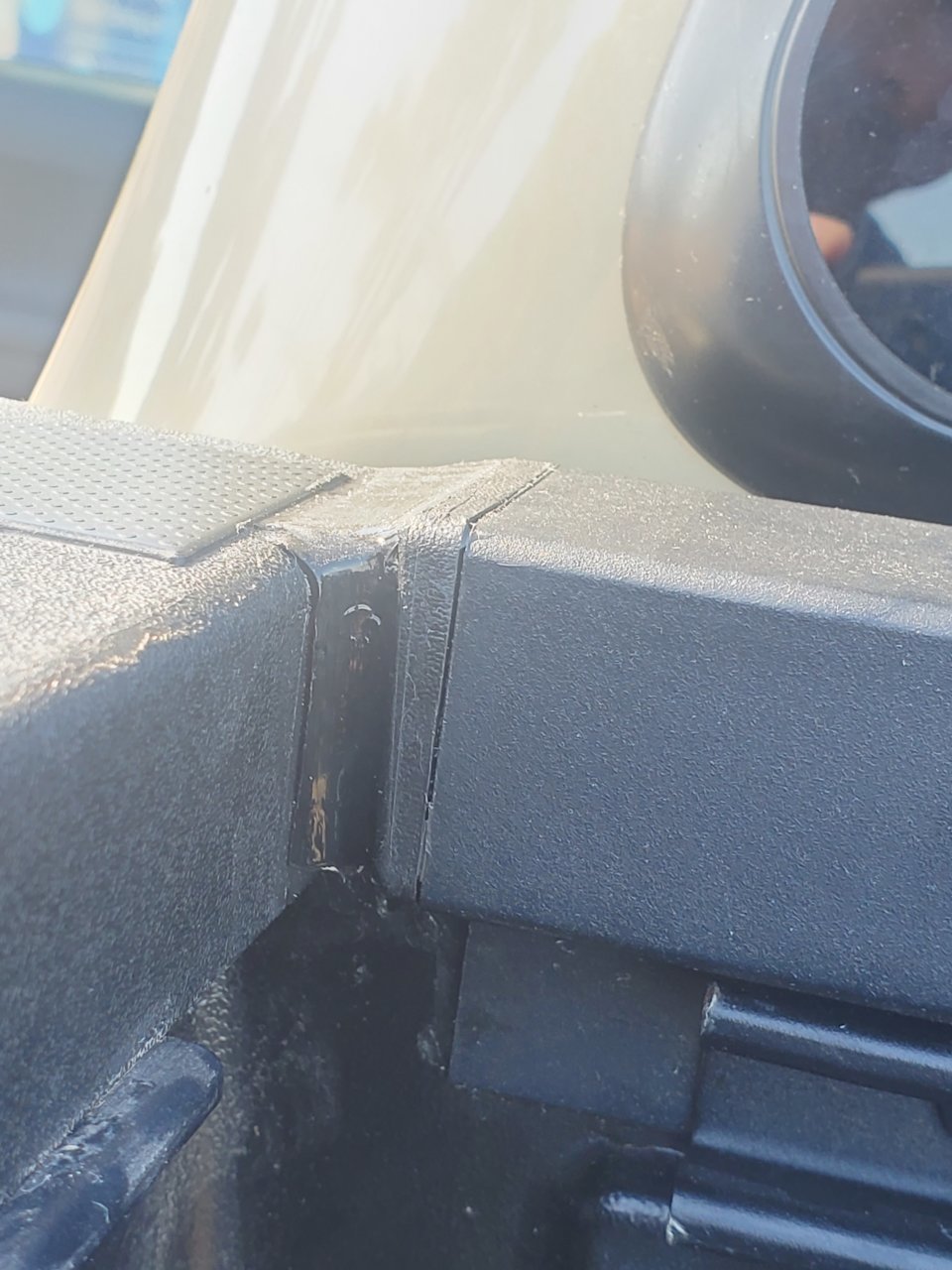

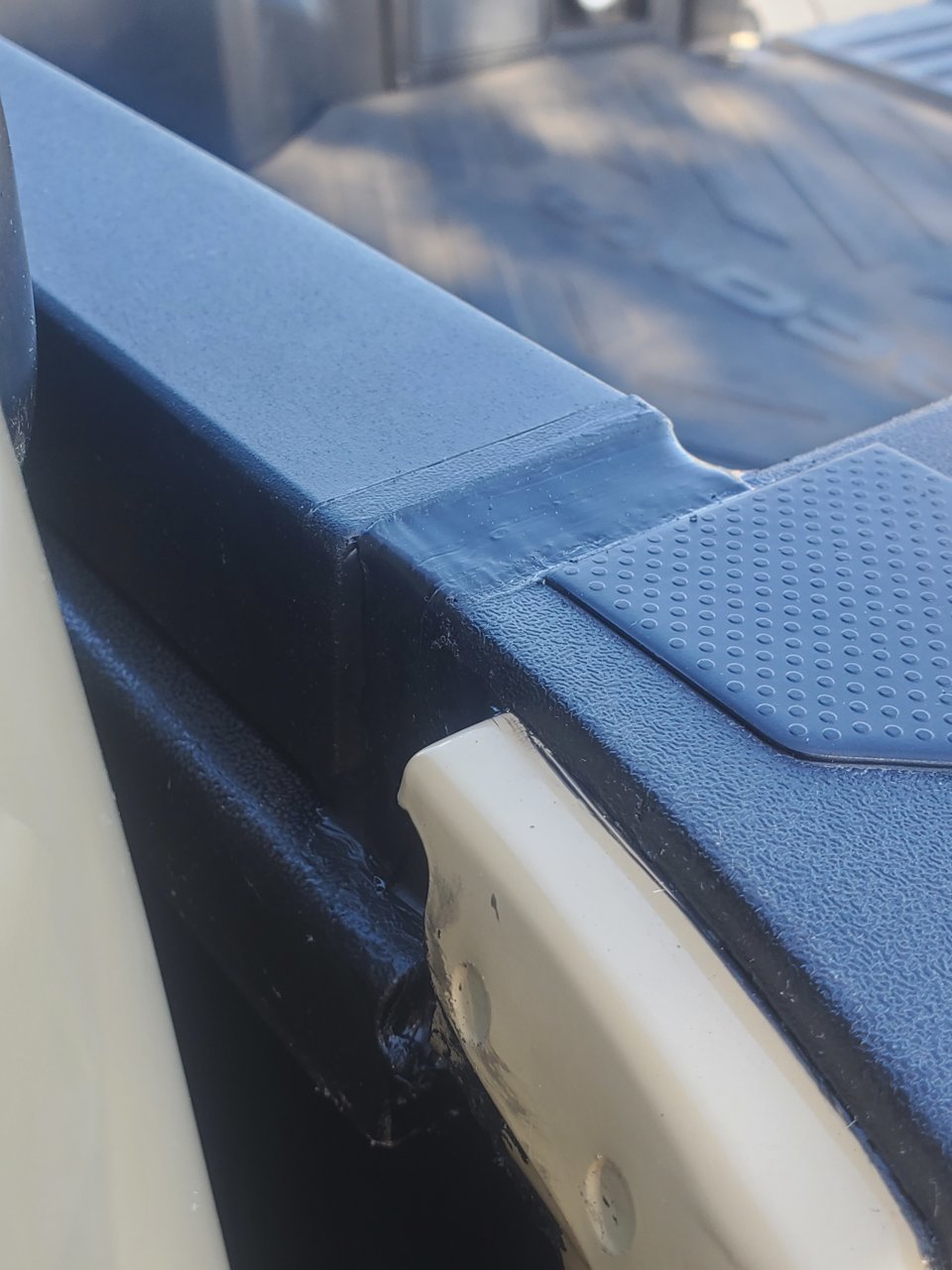

    Not a great deal of work, but kind of a pain in the ass.
    Doing prep work for the incoming RLD canopy.
    Chasing down potential dust and water infiltration points and sealing them up.
    Sealed under bed rail caps, bed transition under the accessory rails, tailgate cap, front bed rail, and front corners.
    Next up cubby and tailgate dust and waterproofing and running wiring harness for the canopy for following roof rack and interior mounted accessories:
    - 4x BD S2 Sports (side area work scene, 2 ea. side)
    - 2x BD S2 Pro (rear area work scene)
    - 3x BD Rock Lights and magnetic door switches and relay (interior canopy lights)
    - 3x BD Push button Rock Lights (Door area camp lights).
    - 12v convenience outlet and USB ports.

    Looks great. Did you just use black silicone with masking tape around the front corners? Much cleaner than the butyl tape I smashed down into mine (which has been melting and dripping down onto my driveway over the past couple of weeks)

    Yes, black silicone and masking tape, then tool the top edge at front rail with a flat edge, or slight damp finger the concave edges. Tape off, apply silicone, tool, make sure I've got a clean joint, pull the tape, and done. Also used foam "backer rod" in the gap at the front rail, under the openings at the bottom corners of the bed, and at the front upper corners of the bed before I applied sealants.
    Doesn't quite look like it there, but I did pull the front rail caps, silicone under the caps, then re-inserted the rail caps. May have to hit them with a smidge of sealant just to be sure as there is the tiniest of gaps there. With all the odd openings to the bed though, that little minute gap will be the least of my worries.
    Not sure I can achieve it, but goal is to have a nearly completely dust free bed without needing to use the positive pressure vent on the RLD canopy. That could be a pain during summer monsoons, opening and closing that vent continually as conditions dictate. Can't see how that vent won't allow ridiculous amounts of water into the bed during rains. Going to water and dust proof anything I can possibly find and hope for the best. If I still need to use the positive pressure vent on longer dusty runs, so be it.

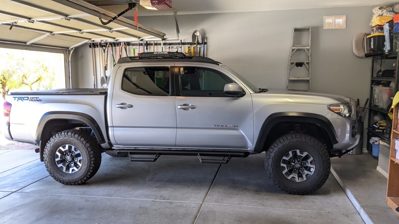

    Got the KD Max Tune / Eibach Pro Truck lift / JBA Upper Control Arms. I think i'm good with the setup now. PXL_20210802_173325530.jpg

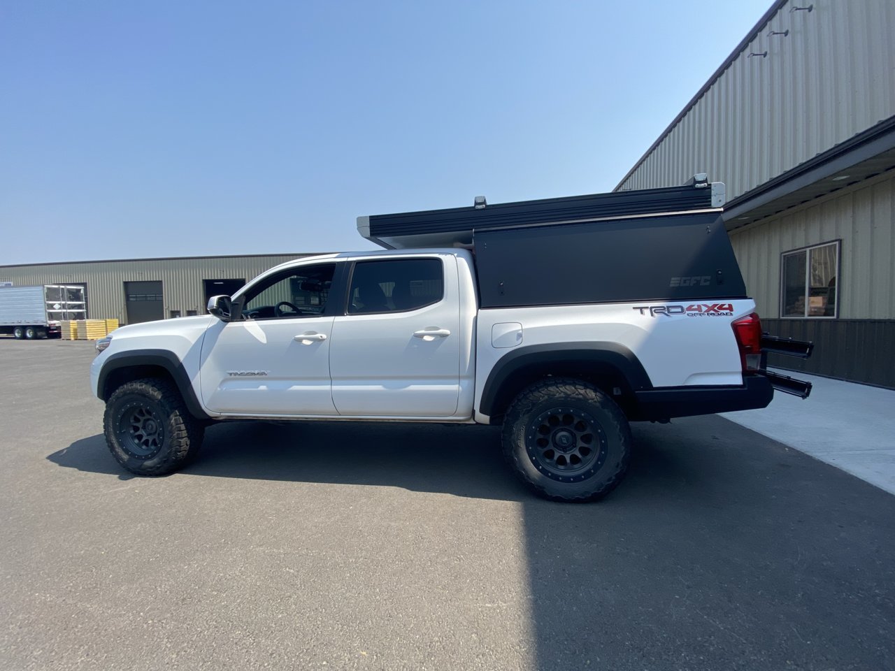

    Try the white camper shell with horizontal gold and orange stripes at the base of the camper interrupted by the window. Either thick or thin stripes might look good.
