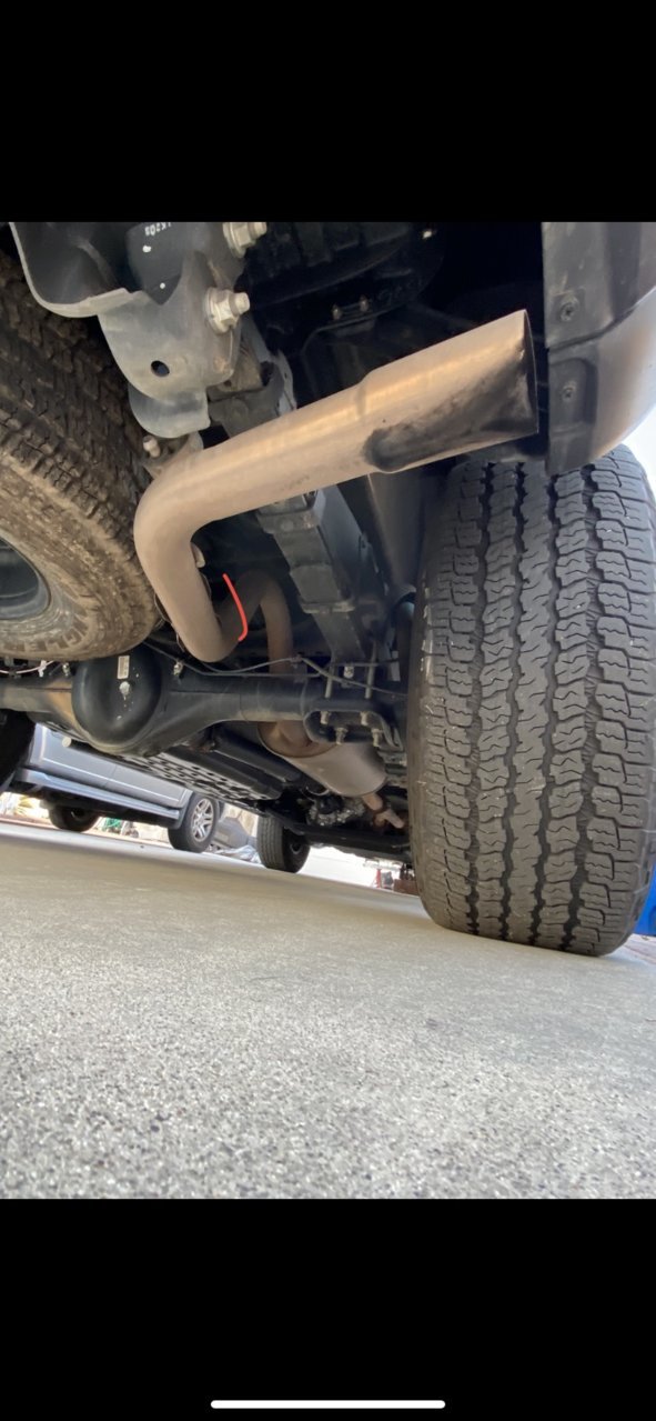

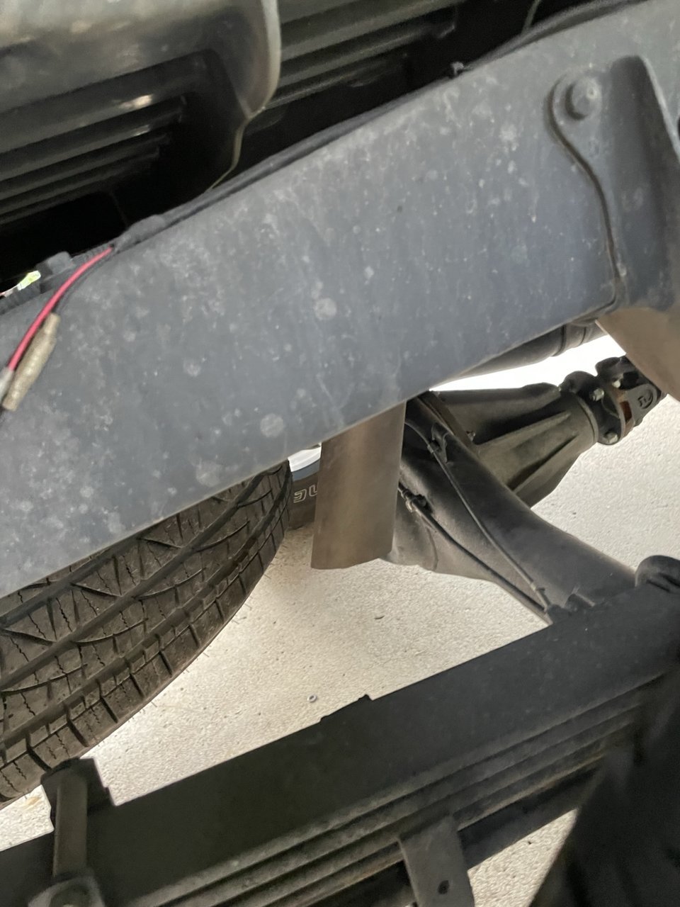

    Do you have any images of this? Also has it been fine?
    will my spare tire be fine with the heat?
    Will the piping be supported enough
    Weight wise.
    I’m thinking of cutting mine right here:
    Abominator and AmateurTaco1313 like this.
  14. Dec 22, 2022 at 7:37 PM
    AmateurTaco1313
    AmateurTaco1313 Next truck will be a Hilux
    Dec 9, 2020
    #349116
    1,243
    ROK
    2018 TRD Sport 4WD DCSB
    Enough for now
    yes to all your questions and see photo.
    you’ll need to cut one of the exhaust hanger bolts too to fully release it. Found that part to be more annoying than the actual tail pipe

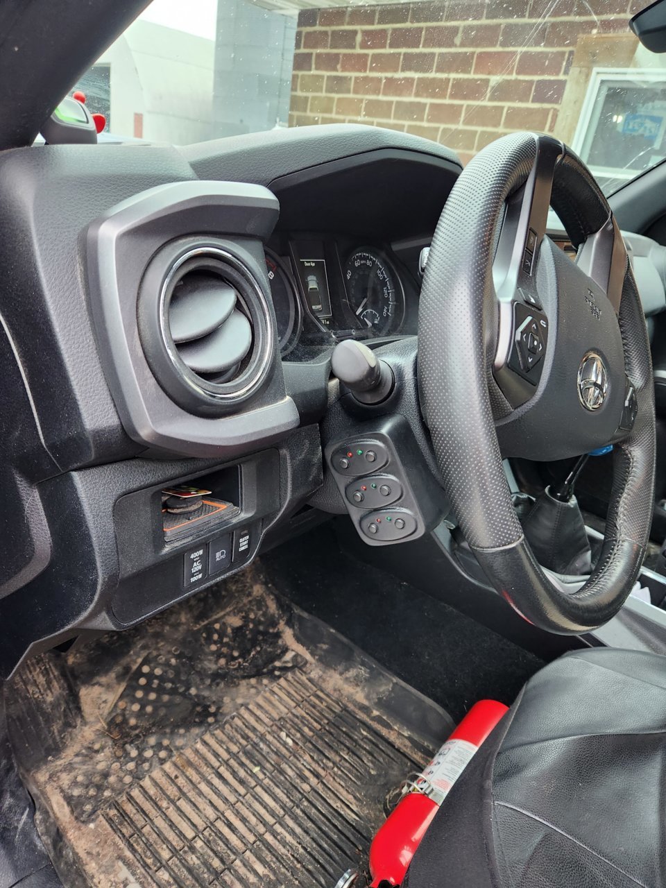

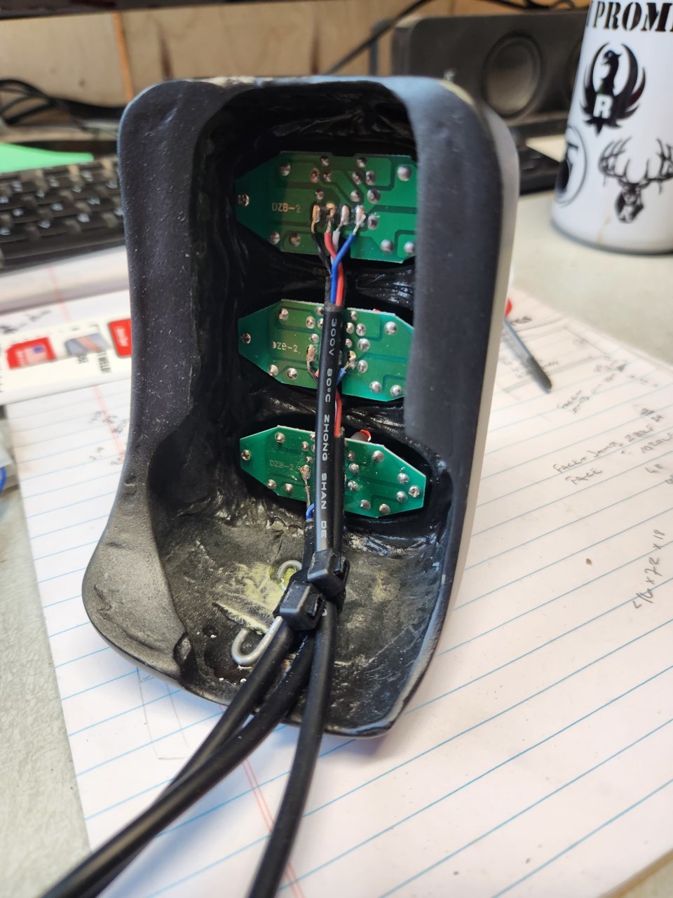

    the switches location are genius
  20. Dec 22, 2022 at 8:29 PM
    CalvaryBlueTRDSportA.C.
    CalvaryBlueTRDSportA.C. Well-Known Member
    Jul 19, 2020
    #334986
    55
    Jordan
    '19 Cavalry Blue 6spd TRD Sport Access Cab
    Eibach suspension, nitto ridge grapplers (factory size with 1" spacers), Ripp coils, k&n blackhawk intake, magnaflow exhaust, magnuson sc, j&l catch can, optima yellow battery. ARB onboard twin woth tank ordered. ECGS front and rear with 5.29 and arb lockers coming next.
    Thanks. I didn't want anything permanent so I glassed a new housing to fit the proprietary switches for the lights. Used some automotive dbl side tape to stick it. Wires feed in through the steering column adjustment lever.
    Few drops of isopropyl should take it right off if I need.
