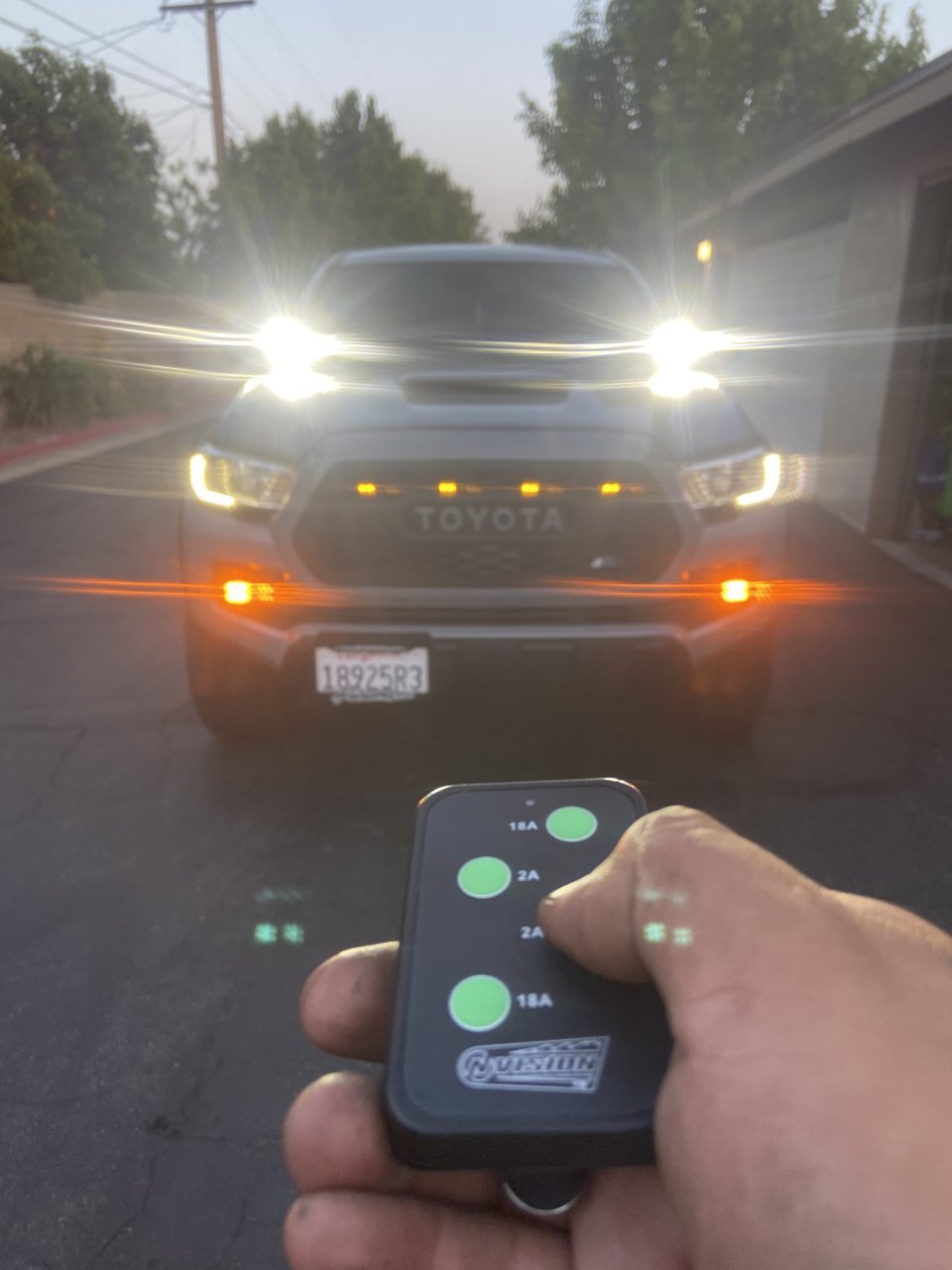

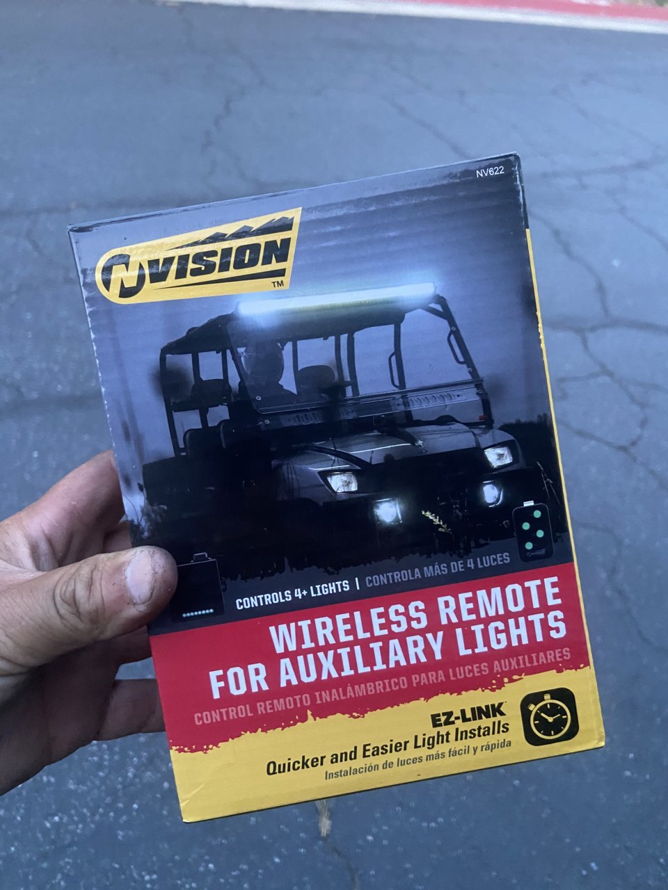

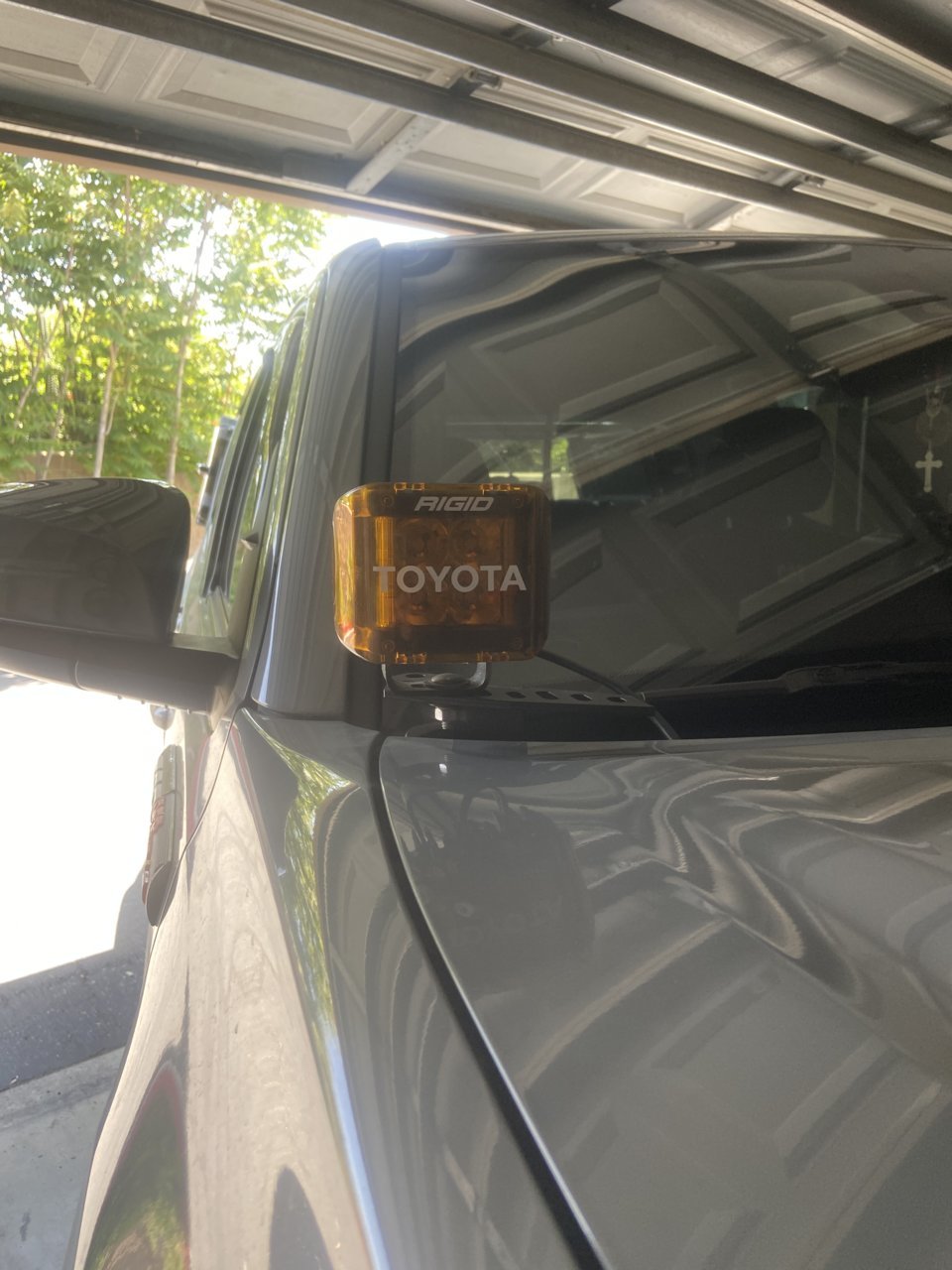

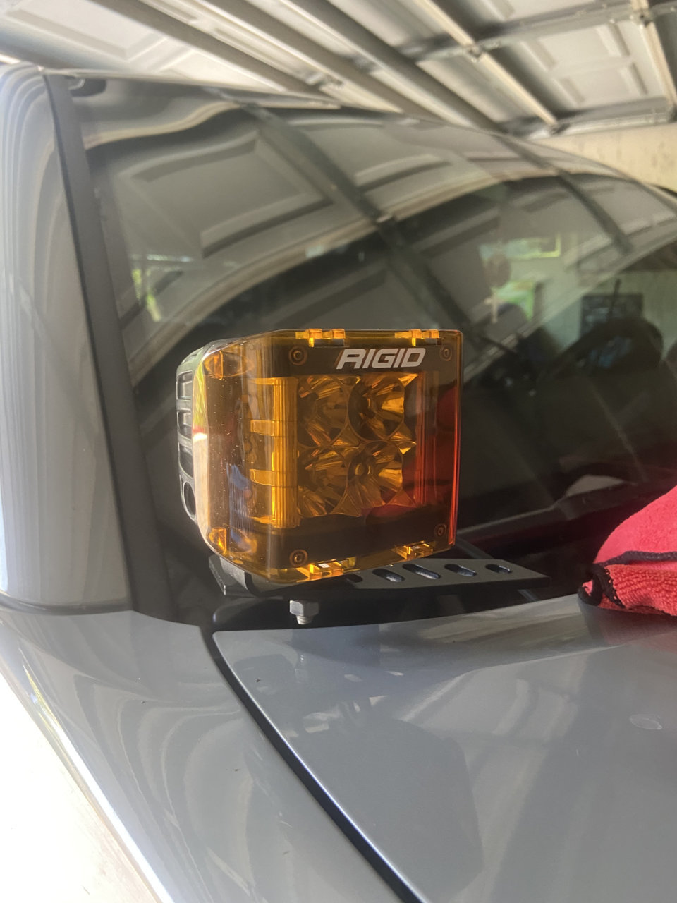

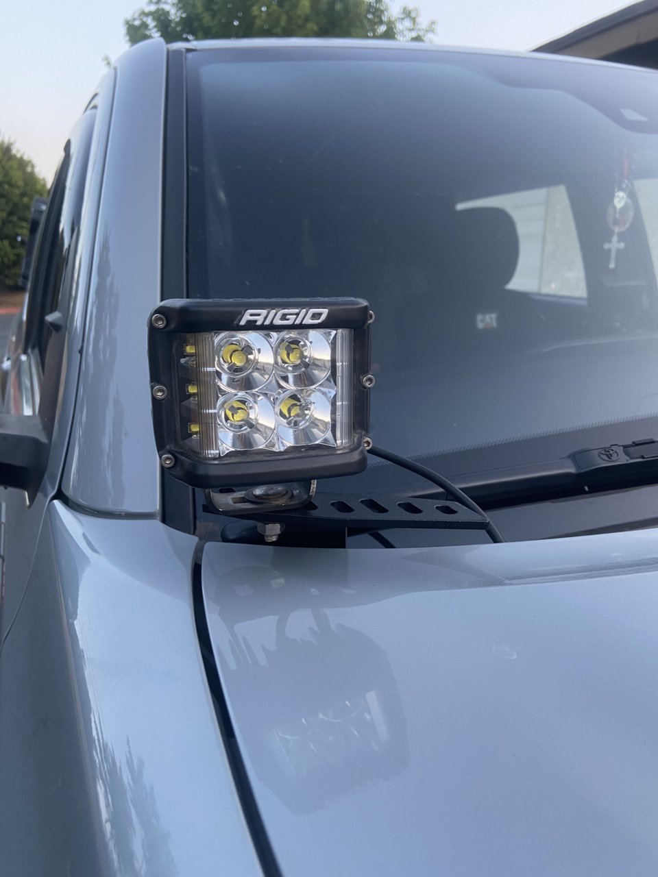

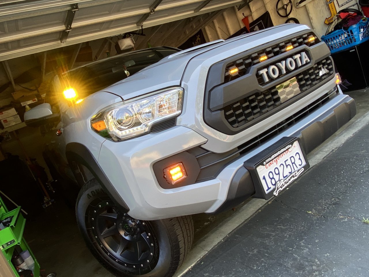

    Forgot to share these goodies I installed during my vacation/banned from TW. I Found a nice used set of Rigid Industries D-SS pro flood pod lights on offer up. Took a risk on buying them because they were dirty and wires were cut. But Once obtained them I shortly bought the nvision wireless remote and created a harness for them. Then once. Everything looked good and worked, went to Off-road warehouse in Corona, California and got some yellow rigid light covers. Then went on Etsy and bought some small Toyota decals to slap them on the light covers to make it a lil retro( I know it’s tacky but I don’t know what y’all think)

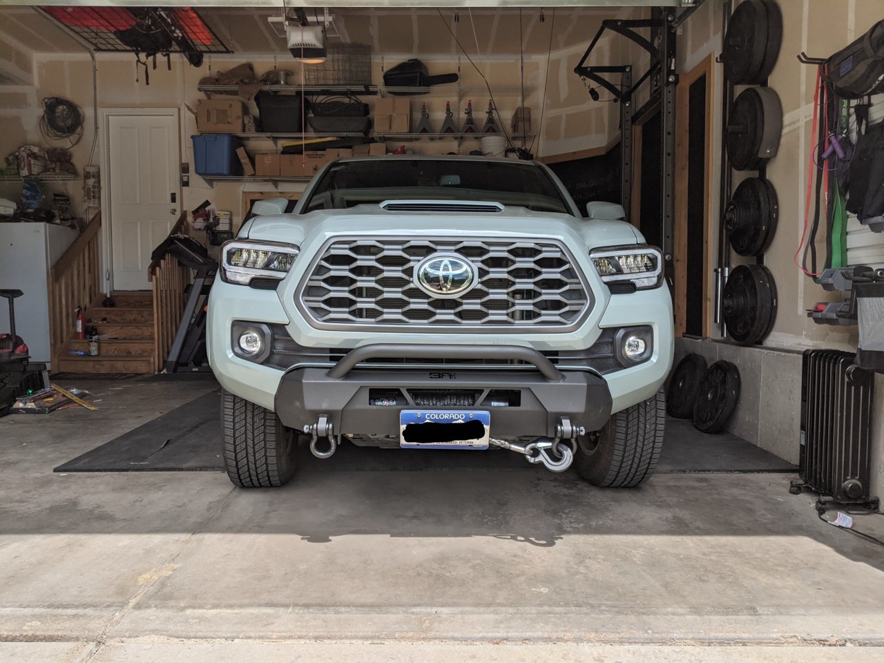

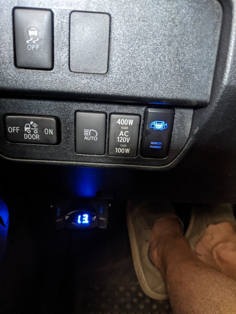

    First big modification in the books.
    -Body Armor Hiline Front Bumper
    -Smittybilt X2O 10k winch

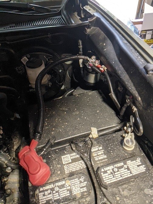

    -500amp relay and 12v switch to control power from in the cab
    The bumper went in fairly easily. Probably could of cut a bit more than I did a long the top, also ended up with the side tabs in front for now. I may try to get the tabs in the back in the future. I was able to get the cooler line bolt back in that in the main thread for this bumper struggled with. I had to put the nuts on the cooler bracket to raise it up but I left the bracket nuts loose and was able to get the line support bolt back in. The bracket to move the cooler back was at an angle but still provided the needed clearance.
    The 12v side of the relay I did in advance of the main install. Used the tacomabeast tap and then add a fuse. Works well, button lights up brighter than I want, but I could only find ch4x4 button with what I wanted and you get what you pay for.
    The winch...started wrapping the line then realized the hook was too large to fit through the fairlead (in hindsight, dumb of me to think it would). unwound everything then installed the winch and the bumper. Got everything installer and electrical hooked up. Go to winch in....nothing. Winch out works. learned a lesson to test everything before installing, I wont make that mistake again. Was able to unbolt the winch and get access to the solenoid without taking off the bumper, switched out and in and testerld again. in now works, out doesnt. Good enough for now, as in is the important direction and ill follow up with customer support another day. Get everything together and go to put the license plate bracket on. Realize that I need to unwind the rope and thread it through like the fairlead. Whoops. Luckily enough, while doing this the solenoid unstuck and started working in both directions, so well call it a win.
    I'm happy with it, good starter mod before going into the realm of suspensions and lifts.

    Holy Sheep Shit! Your ready Dud. :oldglory:
