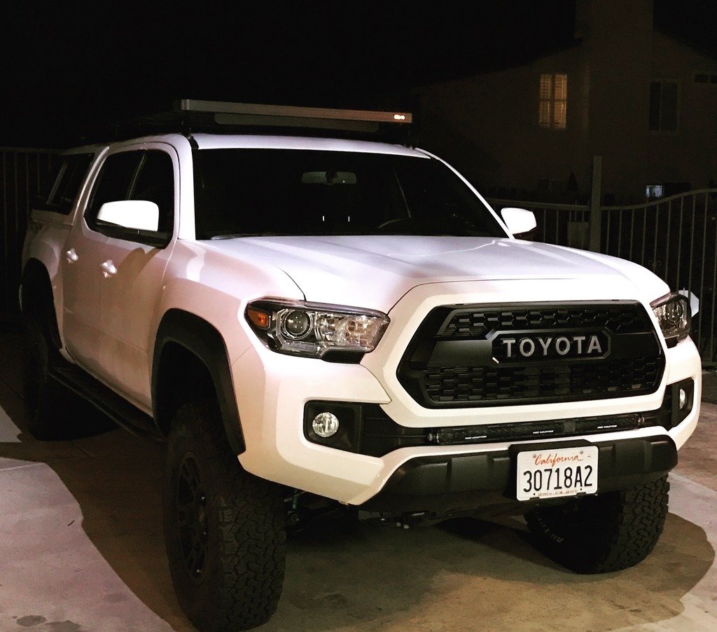

    Finally got my hands on a trd pro grill

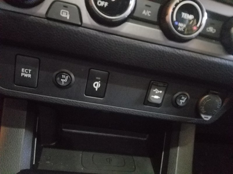

    Seats
    Yes heated seats

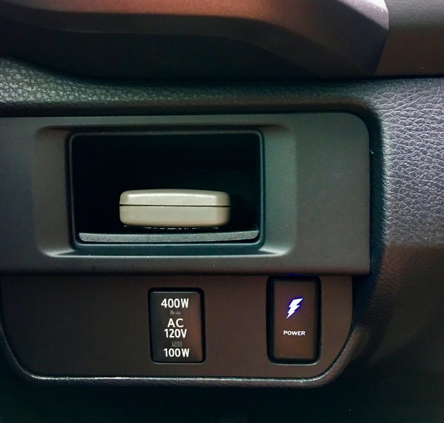

    Added a Power Switch to my Hard Wired Dash Cam. The lightening Bolt lights up when Power is ON. It's Off when Power is OFF. The "POWER" Label lights up when dash lights are on. I was able to tap into the illumination wire for the Cargo Lights even though I don't have them or the Switch on my TACO. The Wire connector for the Cargo Light Switch is behind the switch panel and the illumination wire is active.
    I'm now wondering if all I have to do is get a new Switch Panel and Cargo Light switch, and of course the Cab mounted Tail & Cargo Light fixture to retrofit Cargo lights on my Truck? Anybody attempt this mod yet? If co, what are the Part Numbers I'd need? TIA!

    Here is the switch panel
    http://www.toyotaonlineparts.com/oe-toyota/5544604030c0
    And here is the part number for the switch - 84267-0C020
    Here's a thread - https://www.tacomaworld.com/threads...s-using-double-cab-cargo-light-switch.436440/

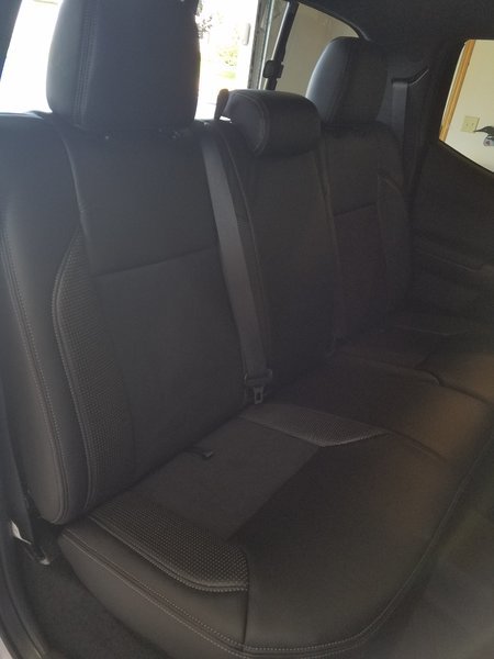

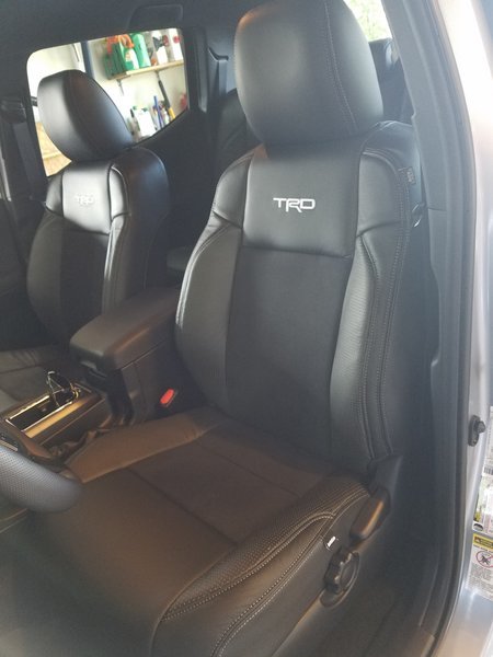

    Nice seats! I was actually talking about doing leather seats today. Working out the pattern/material choices now

    Thanks, that's great! This talks about adding the switch for a bed set of LED lights. I've got a set of those I may use if my plan to install the OEM Cargo lights ( which I believe - correct me if I'm wrong ) are on either side of the Cab-mounted Brake Light doesn't work out.

    Best looking grille out there
