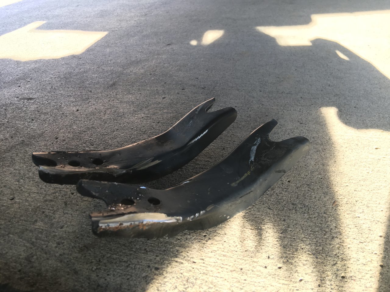

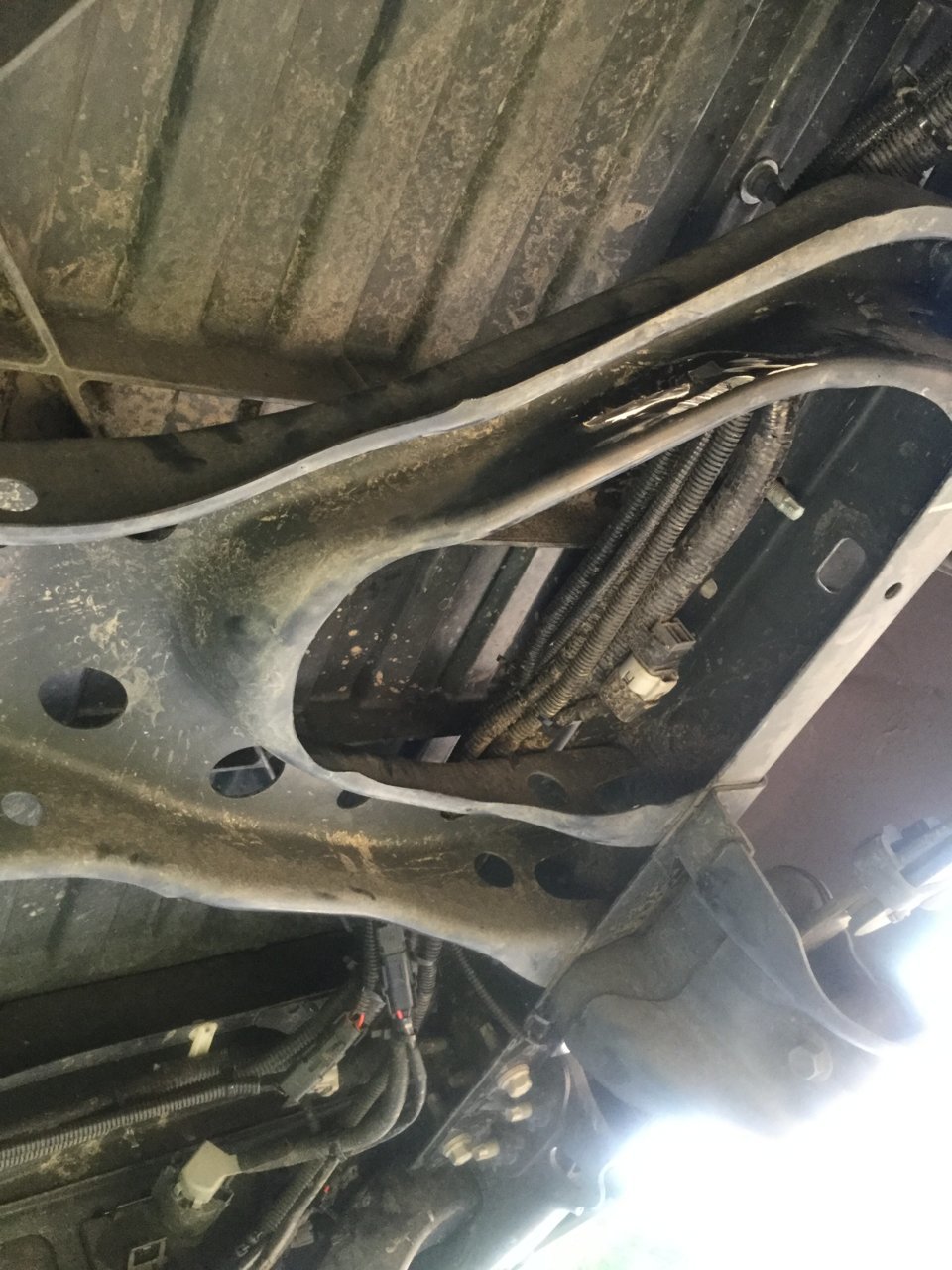

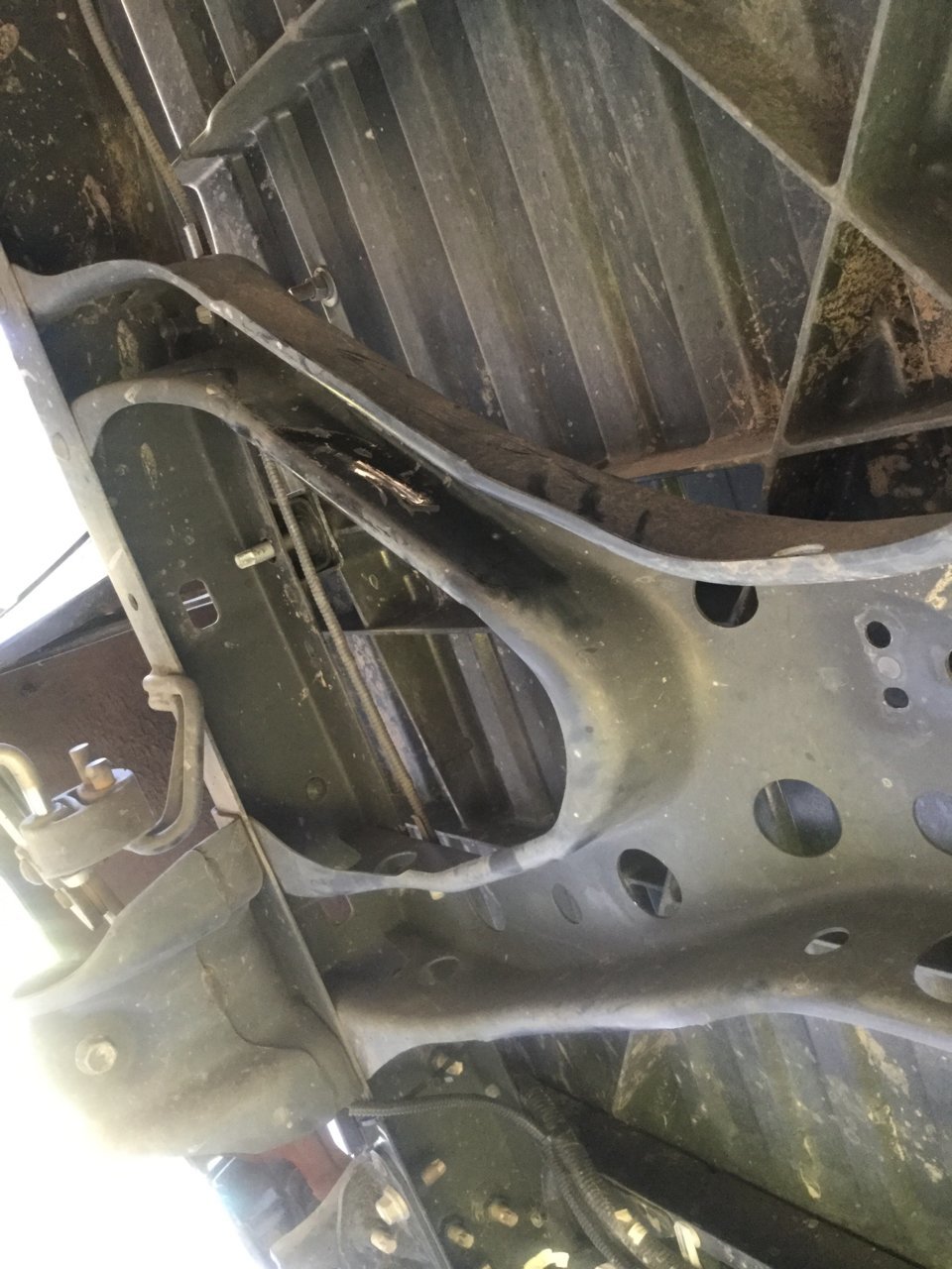

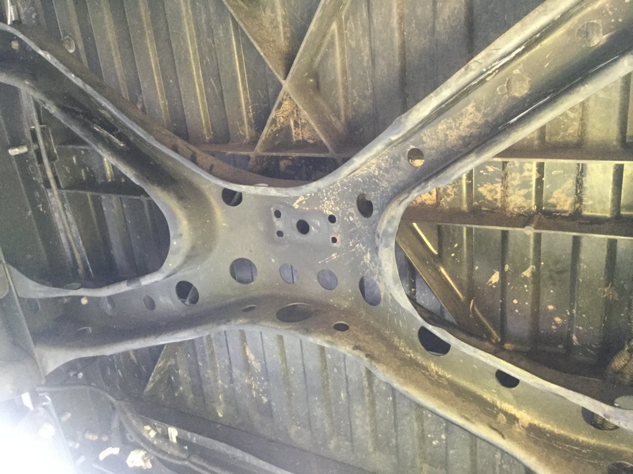

    Spare Tire Ear Removal
    In preparation for mounting my water tank, I decided to remove the spare tire ears so it can sit flush to the crossmembers.
    https://youtu.be/Vj8MlcBHE_o
    Next on my list is to figure out how exactly I would like to mount my water tank underneath. I’m actually contemplating getting the bed of my truck’s rear frame rails boxed/plated, which actually removes the OEM Crossmembers. Then I could mount my water tank even higher and directly to the bed of the truck. Stock trucks have a thin crossmember under the bed that the spare tire attaches to as you can see. To install the frame plates, that crossmember gets cut out and removed, the frame plates are installed and then a beefier crossmember is made and put in. It stiffens up the rear part of the frame a lot. The spare is no longer mounted under the bed, which mine has already been removed.

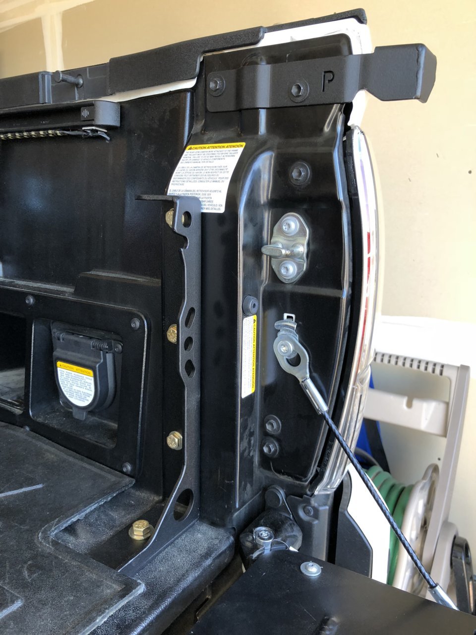

    added the bed stiffeners finally:

    At the helm?

    YUP! had them powder coated

    That’s what I have. They’re great.
