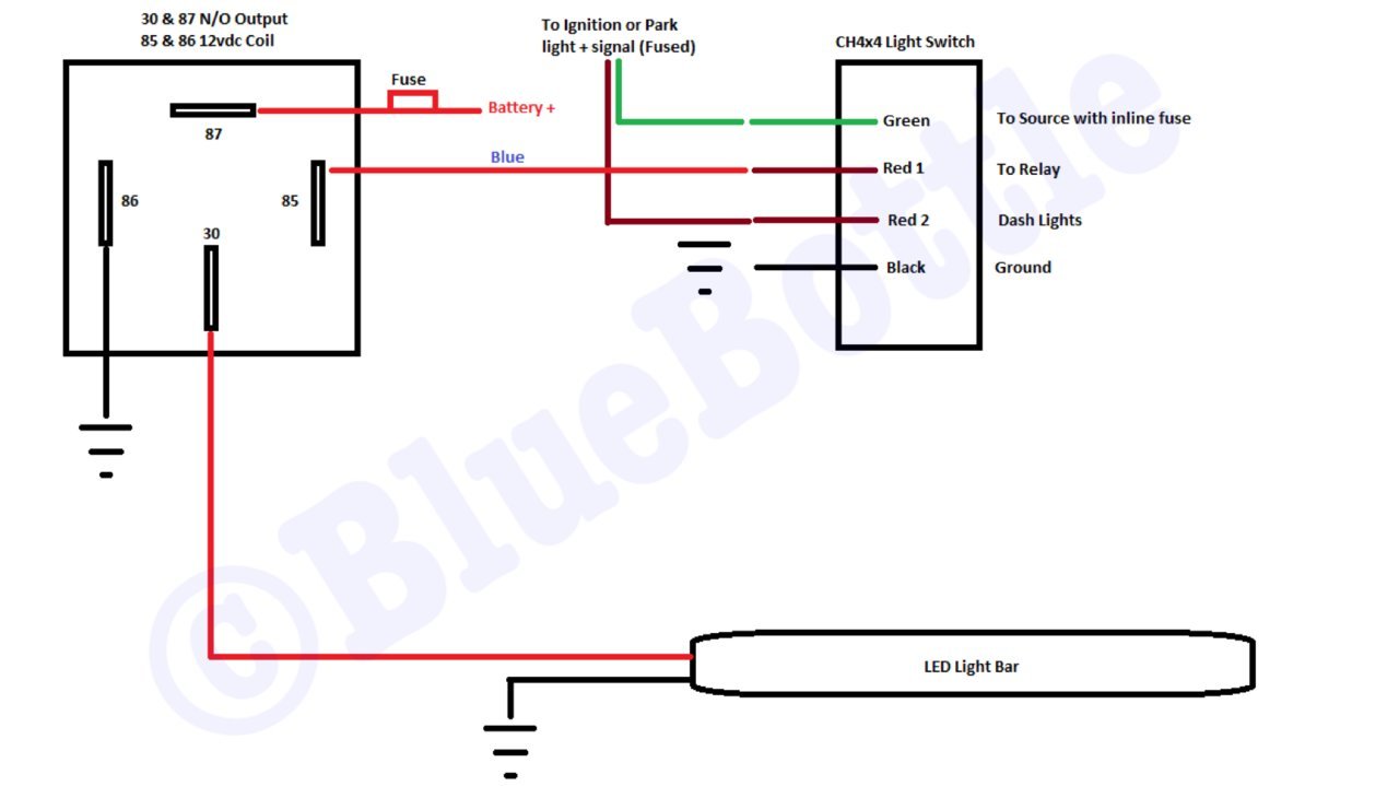

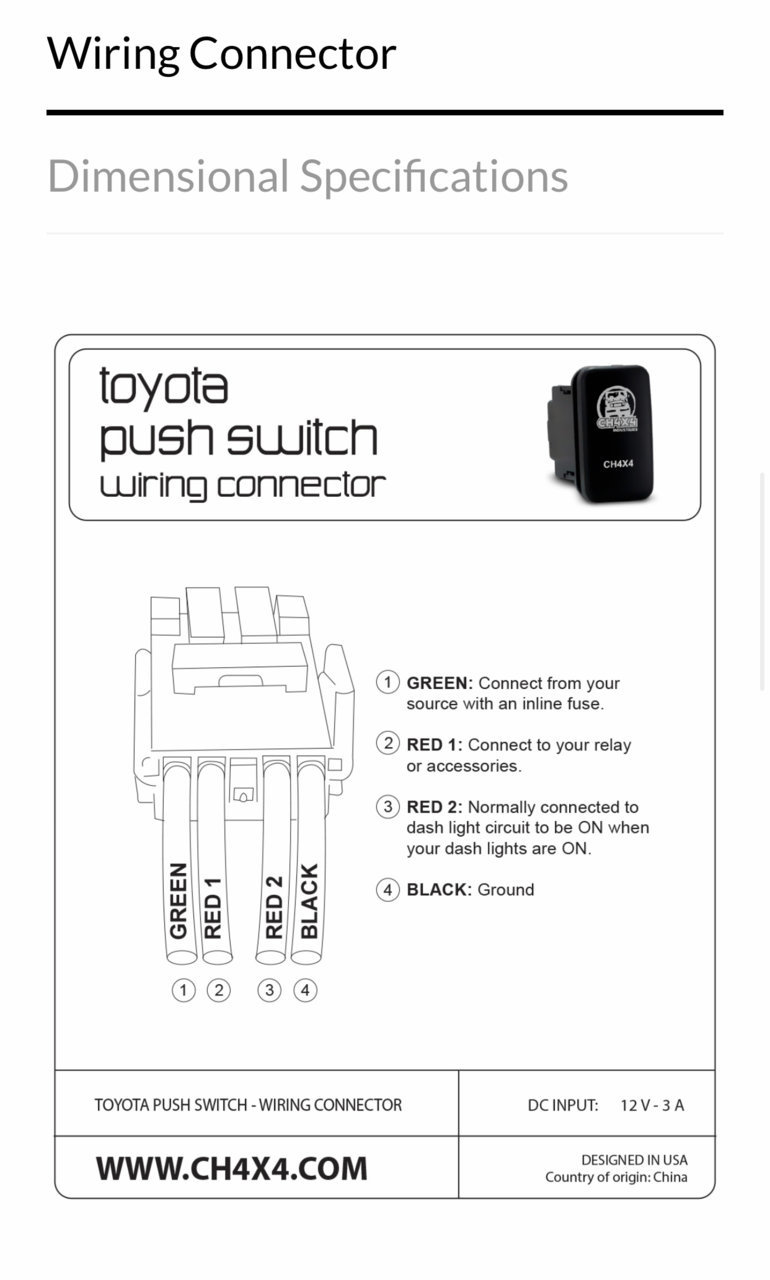

    Little help needed with a small taco switch...
    I assume the colors match (please correct me if I'm wrong), but where does green go?

  10. Feb 3, 2020 at 10:04 AM
    shane100700
    shane100700 Bed, Bath & Beyond Crawler
    Jun 1, 2011
    #57578
    7,012
    Montana
    2019 DCSB, OR
    Rocket Boosters
    I put up a second one also. You can do it that way but one should go to the acc power (fuse tap) and the other to an illumination source. I’ll have to double check which, think green to the illumination. If someone answers or confirms before I do, great!
    Edit; Red2 to illumination circuit
    Kevin8se7en[QUOTED] likes this.

  12. Feb 3, 2020 at 10:14 AM
    shane100700
    Jun 1, 2011
    #57578
    7,012
    Montana
    2019 DCSB, OR
    Rocket Boosters
    I’m GUESSING here but I would think Yellow = Red2. It’s possible it will be trial and error unless someone has used this switch. At least without having it on hand to disassemble or test. Black will be ground. One will go to relay, one to an illum source and one to a fuse tap. If that makes sense at all.

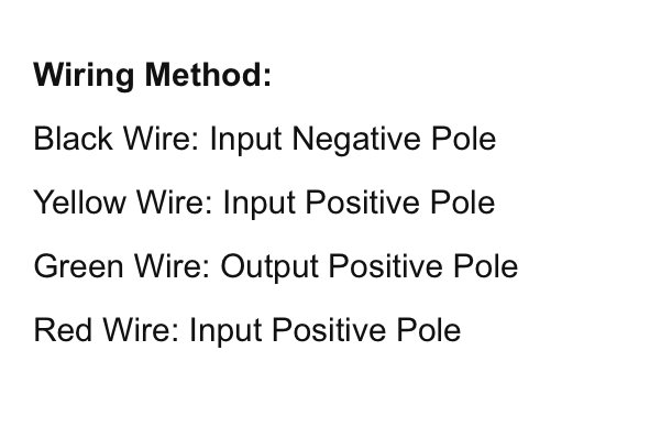

    Why is that your guess? I know in low voltage application green is ground, but typically with 12v applications it’s black.
    Not to mention the description screen shot I posted only confirms black is neg pole and all others are positive.
    Posted again for ref.
    Considering most Chinese parts are similarly sourced and black is negative. I would guess Yellow=Red2, Green=Red1, Red=Green. It’s only an educated GUESS at best based off a couple assumptions and one known quantity.
