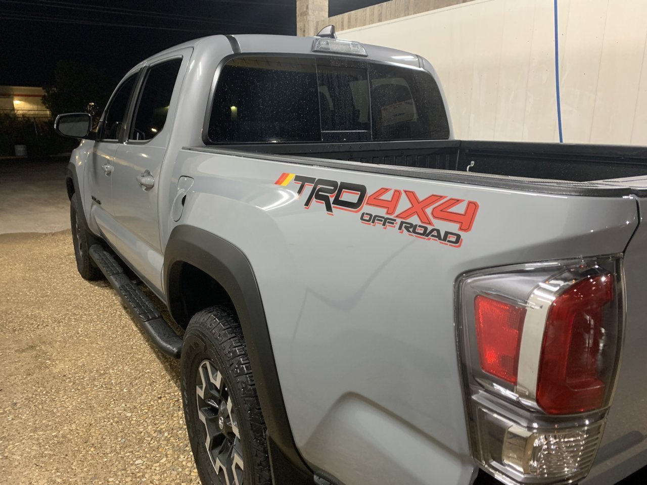

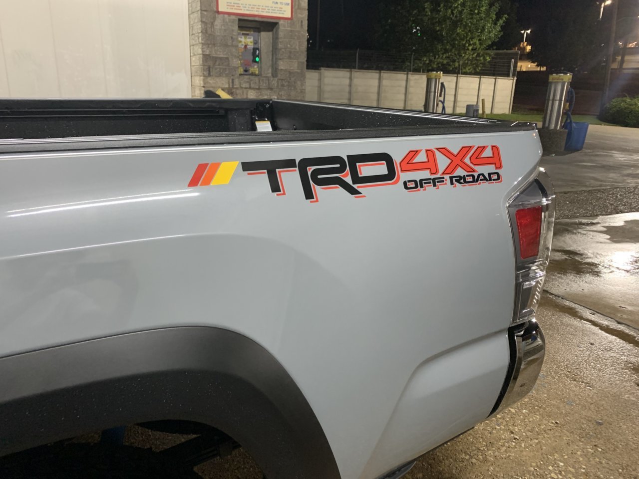

    decided to add a little flare to the fender decal

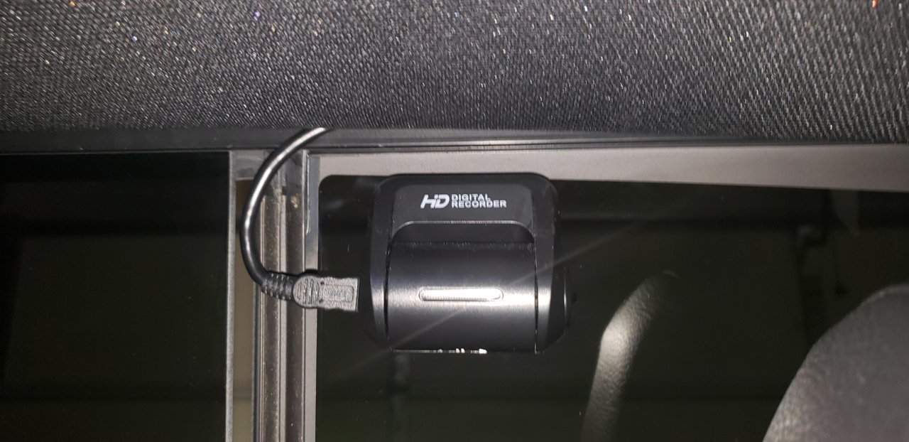

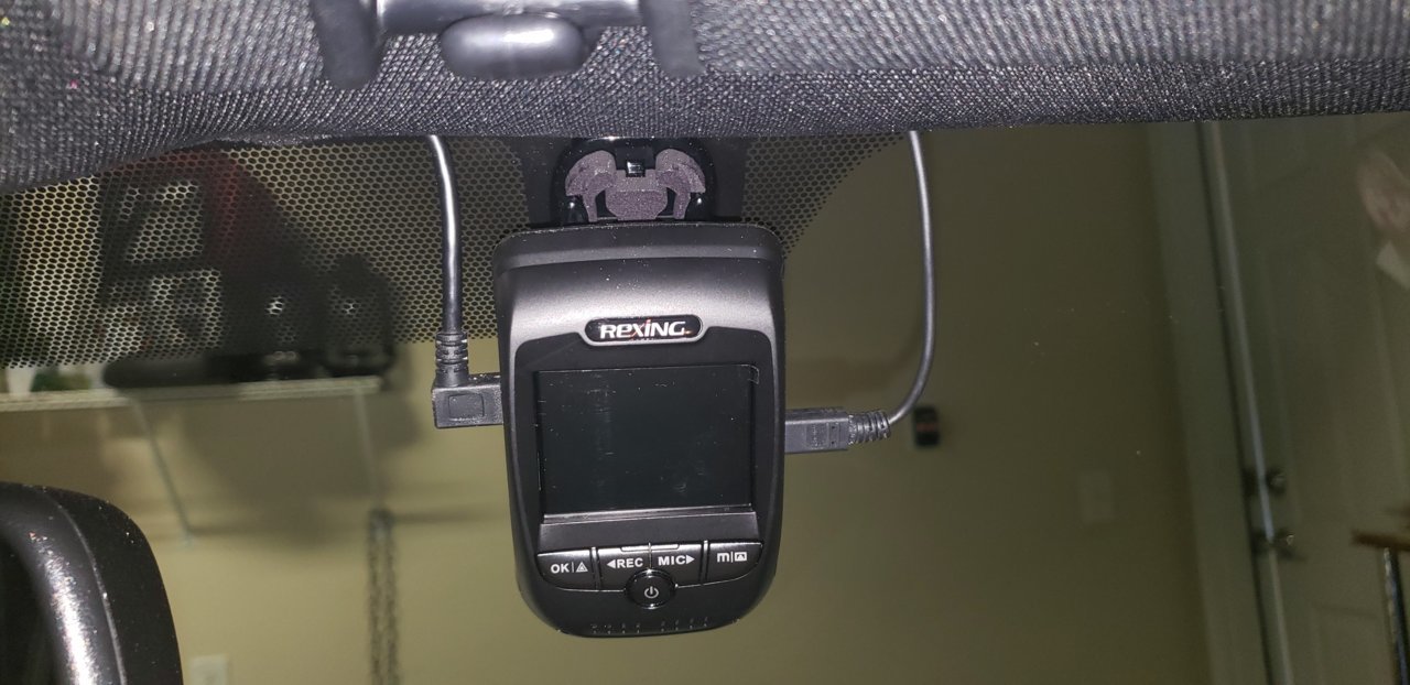

    I ran mine tucked under the headliner around the drivers side to the rear. I also used the mirror adapter. Easy install. 20200308_161520.jpg

    How hard was it to tuck it under the headliner? I'm getting ready to do this.

    Not hard at all. I pulled down the center overhead console, ran the wire from the front cam straight up under the headliner to the opening, then ran under the headliner to the A pillar, then the wire is just tucked under the moulding above the doors to the rear where it goes back under the headliner the the rear cam. I used a plastic tool to help push it under the trim and headliner. I actually stated in the rear and worked to the front. After wired up, I just tucked the extra wire in the A pillar. I also used the mirror for power and ran the power wire straight up from the camera under the headliner then had it come out of the headliner directly above the mirror. Have everything a clean look.20200308_161332.jpg

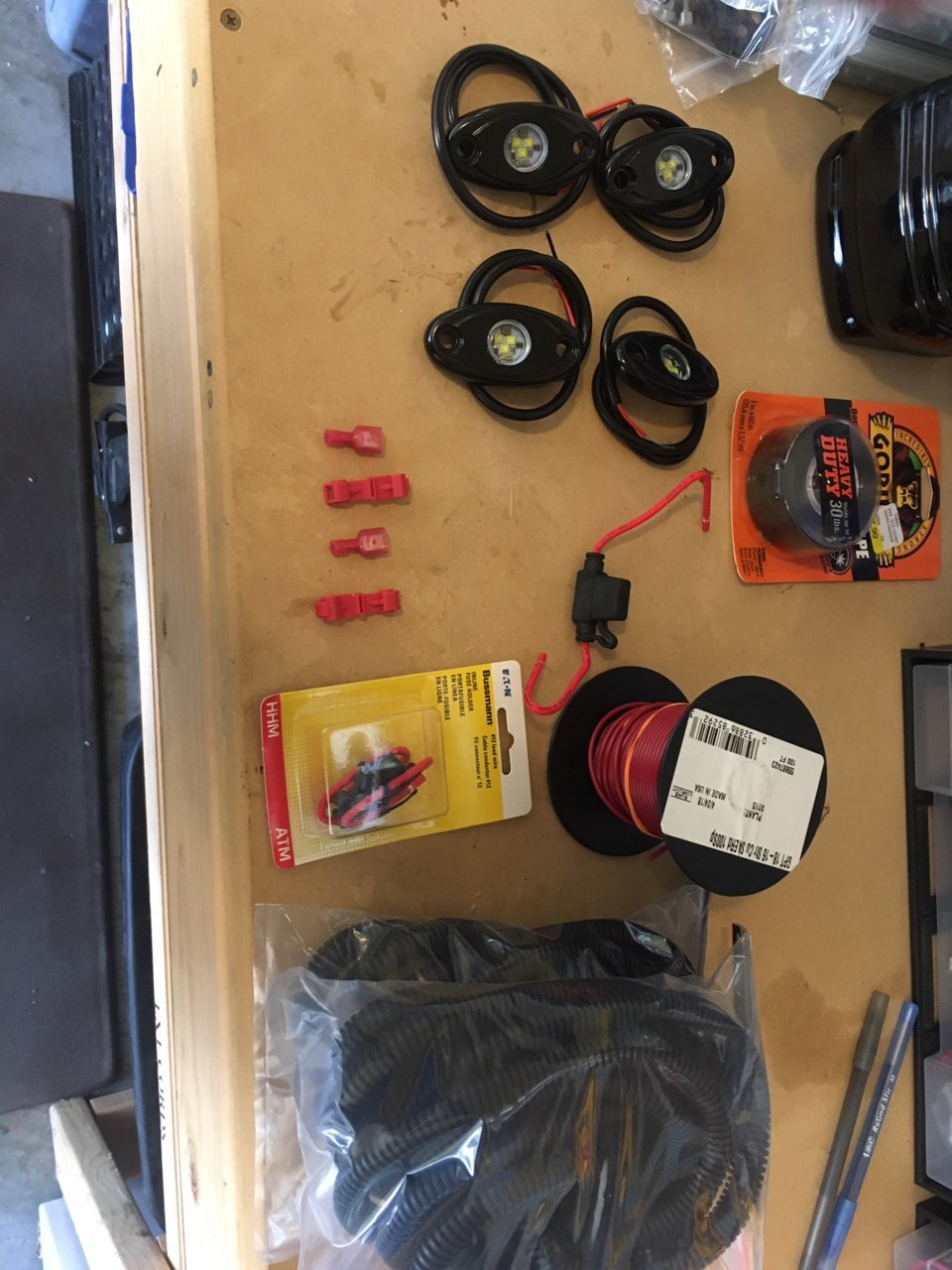

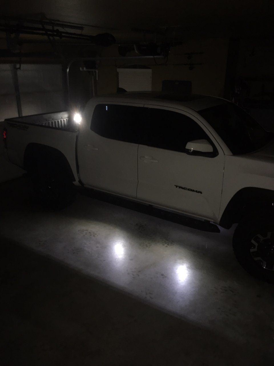

    Stuck a four pack of rock lights to the frame to use as puddle/courtesy lights. Tied them into the OEM bed lights. The passenger side bed light plug powers the rock lights, the driver's side now powers both bed lights. Anytime I hit unlock on the key fob, open a door, or turn on the bed lights by any means, the ground under the truck is now lit up. Cost about $35-40. I have a video, but no clue how to post it.I
    EDIT: I didn't use the in-line fuses. Not necessary. IMG_1523.jpg IMG_1513.jpg
