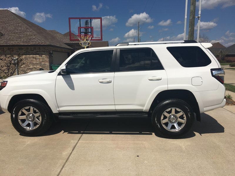

  4. Mar 22, 2017 at 4:34 PM

    T4RFTMFW
    T4RFTMFW [OP] Well-Known Member
    Jul 23, 2014
    #134525
    69,755
    My last build thread was 9k pages. ;)

  6. Mar 24, 2017 at 5:42 AM
    #26
    Jamart5
    Jamart5 HoeRunner
    May 19, 2014
    #130181
    9,137
    Juan
    SETX
    '16 4Runner TRD
    Done.... For now
    Fish_hed, 44357, Nedrolls and 4 others like this.

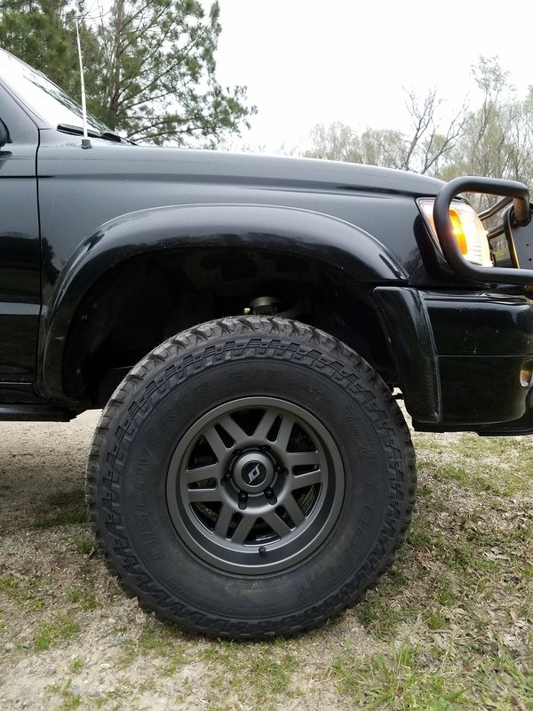

  9. Apr 5, 2017 at 9:27 PM
    #29
    99nmtaco
    99nmtaco Well-Known Member
    Sep 21, 2010
    #43586
    521
    Patrick
    NM / VA
    2001 4 Runner
    ADS racing shocks ext travel front, ADS FJC piggyback shocks rear, Addicted Offroad front plate bumper, 4xinnovations rock sliders and rear plate bumper, SCS Stealth 6s
    Got the new wheels and tires mounted.
    20170405_191240_zpsf26xlkct_d15cea92b6f1d5e5781a90d4a1ac80546c4da3fa.jpg 20170405_191316_zpsnj1wyq85_c4bcfe9d34e912157c55c0672a456e9d9af3977a.jpg
    redwoods, hayjohn, fxmunoz and 12 others like this.
  10. Apr 16, 2017 at 2:39 PM
    #30
    rkntoy
    rkntoy Well-Known Member
    Nov 8, 2016
    #201923
    77
    Bend, OR
    What size tires are those? Can't make it out on the sidewall pic.
    ChadsPride likes this.

  12. Apr 17, 2017 at 12:06 PM
    #32
    Fish_hed
    Fish_hed Member
    Apr 12, 2017
    #216056
    23
    Drew
    2005 SR5 4Runner,
    Bilstein 5100's with OME 2884 coil springs. LED interior lighting. Centric premium rotors and Durago Ceramic brake pads.
    I recently picked up a 2005 with only 71,000 miles. Today I ordered some Duplicolor graphite wheel paint. Going to paint over the poorly painted gold (yes I said gold) painted rims that came with it.:annoyed:
    T4RFTMFW[OP], dtaco06 and ChadsPride like this.

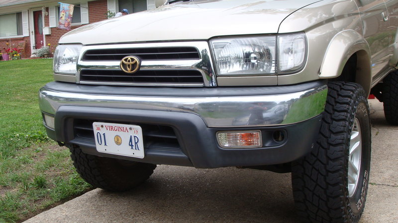

  13. Apr 17, 2017 at 3:49 PM
    #33
    99nmtaco
    Sep 21, 2010
    #43586
    521
    Patrick
    NM / VA
    2001 4 Runner
    Sorry I just saw your question, yup they're 285/75s. They've been awesome so far, just have a little rubbing in the rear when fully flexed.
    T4RFTMFW[OP] likes this.
  14. Apr 18, 2017 at 10:59 AM
    #34
    rkntoy
    Nov 8, 2016
    #201923
    77
    Bend, OR
    3.5 backspace?
  15. Apr 18, 2017 at 2:28 PM
    #35
    99nmtaco
    Sep 21, 2010
    #43586
    521
    Patrick
    NM / VA
    2001 4 Runner
    Yup Stealth 6's with 3.5bs.

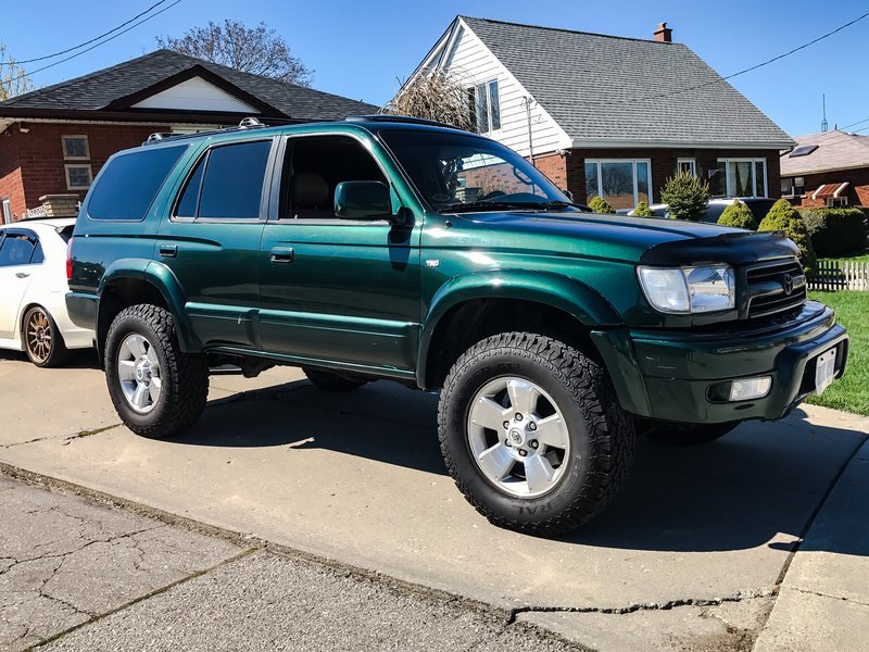

  16. Apr 26, 2017 at 6:54 PM
    #36
    TegoTaco
    TegoTaco Well-Known Member
    Sep 29, 2016
    #198555
    7,357
    Ontario, Canada
    ‘13 SUPERCHARGED DCLB TRD SPORT
    Just wanted to post my old man's 1999 Supercharged 4Runner, INJEN Intake, VORTEX muffler, new springs all around with Bilstein shocks, Spidertrax wheel spacers, 265-70-17 General Grabber at2 wheels on TRD SPORT wheels.
    Fish_hed and Dynamatt like this.

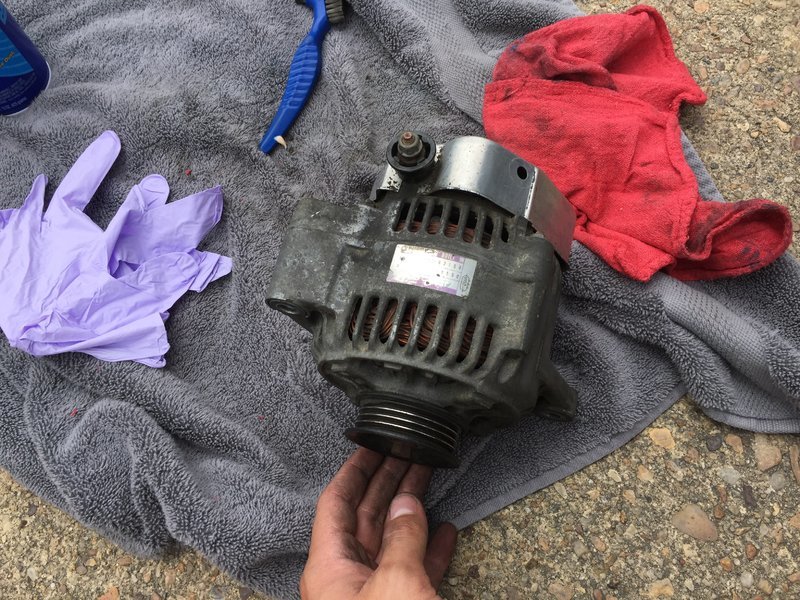

  19. May 21, 2017 at 6:08 PM
    #39
    JoeT4R
    JoeT4R I don't have a Taco
    May 10, 2017
    #218688
    1,215
    Joe
    NOVA
    '01 4R, SR5 4WD
    Today I was able to get my hands on an OEM alternator from a '99 at a local junkyard, so I purchased it and had it tested. Turns out it was in great operating condition, so I swapped it into my 4Runner. Runs between 14.0 & 14.3 volts. I cleaned it up quite nicely before installing, but it isn't shown in the photo below. Also scored a chrome & gold OEM grill. Cleaned it as well before installing. It was a very successful and productive day for me today.

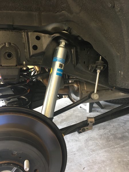

    '90,'97,'12,'05 Tundra 4.7,'07 T4R 4.7,'08 T4R 4.7
    The past month new to me '08 Limited V8:
    - Cleaned an amazing amount of dirt out of the underside. There was only surface rust when I crawled underneath it presale, but up on jackstands every spot that could hold Western Colorado sand/silt was literally packed with it. The frame rails were filled with sand/silt up to every access hole along the length of the frame. Despite that, there is no "crusty" type of rust anywhere even inside the frame rails. It's Colorado, everything dries out fast, doesn't hold moisture.
    - Replaced leaking inner small CV boot clamps with roundside marine clamps, injected grease into the boots using an injector needle https://www.locknlube.com/product/i...=&matchtype=&gclid=CNHgqYjqhNQCFQipaQodm80Bmg We'll see how that holds up
    - Installed the Toytec Boss kit front and rear with Firestone 4107 airbags, removed front and rear swaybars. The 4107 airbags are 2" taller than stock 4135 so they fit the 2" Toytec lift and compensate for the rear swaybar removed.
    - SPC balljoint UCA's, the new version with better washers and a grease zerk
    - Extended rear brake lines from Toytec, removing the rear sway bar those are a must
    - Spray painted and Fluid Filmed (nine rattle cans) the underside
    - Brake cleaner and Sil-Glyde on the brake pistons
    - Amsoil in the diffs and transfer case. Front diff 10mm Allen drain plug wouldn't come out, what a surprise. Used a transfer pump via the fill plug to drain and fill. The 24mm hex bolt from the transfer case can replace the front diff fill plug, direct swap
    - Greased the driveline zerks
    - Slyfox V8 SAIP bypass kit
