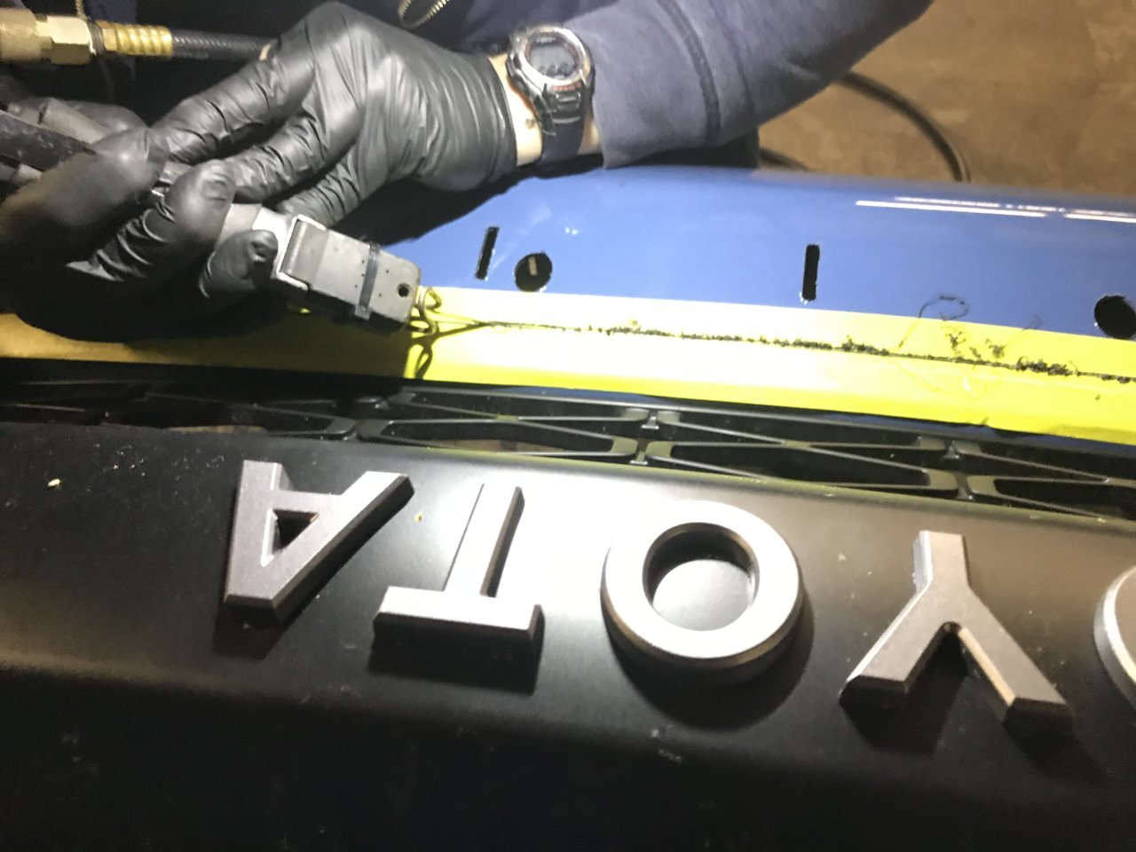

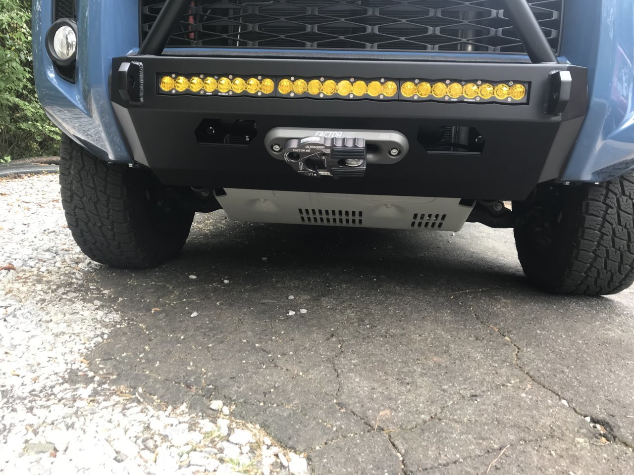

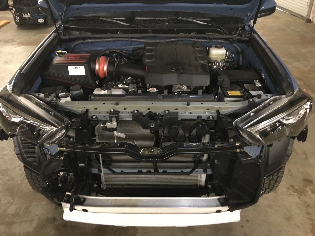

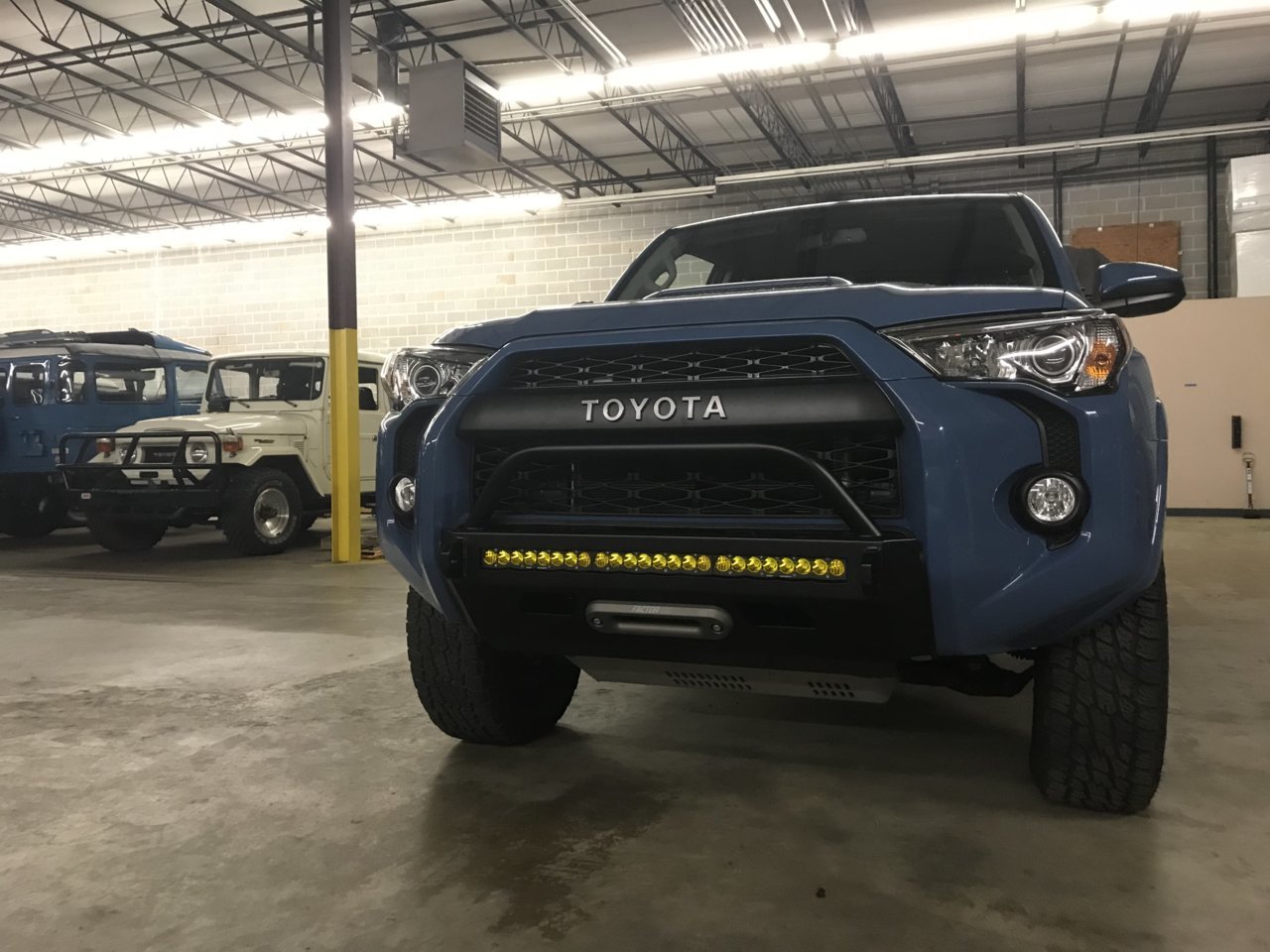

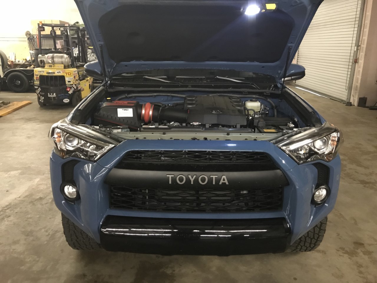

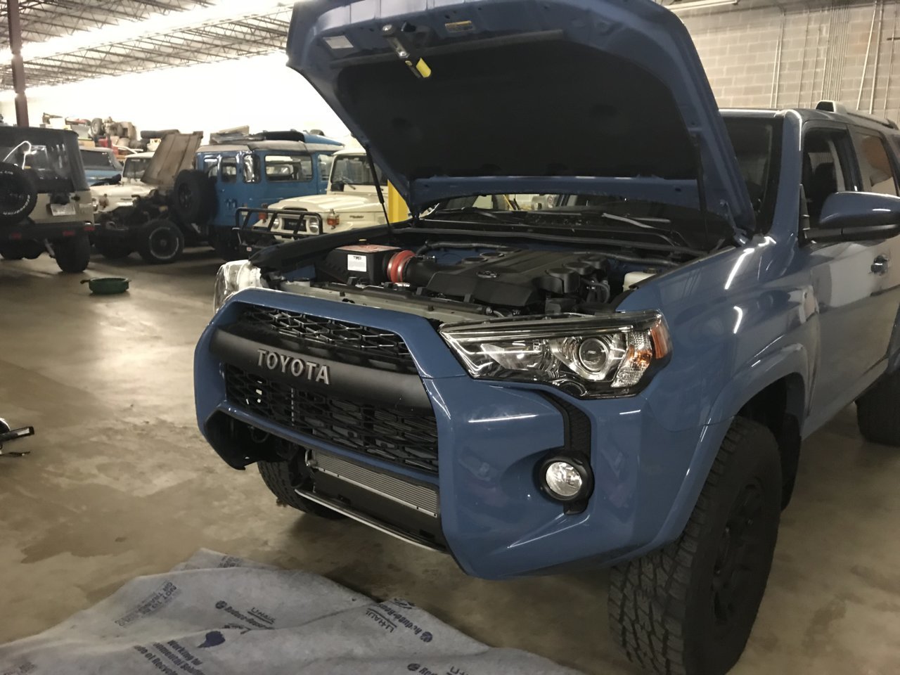

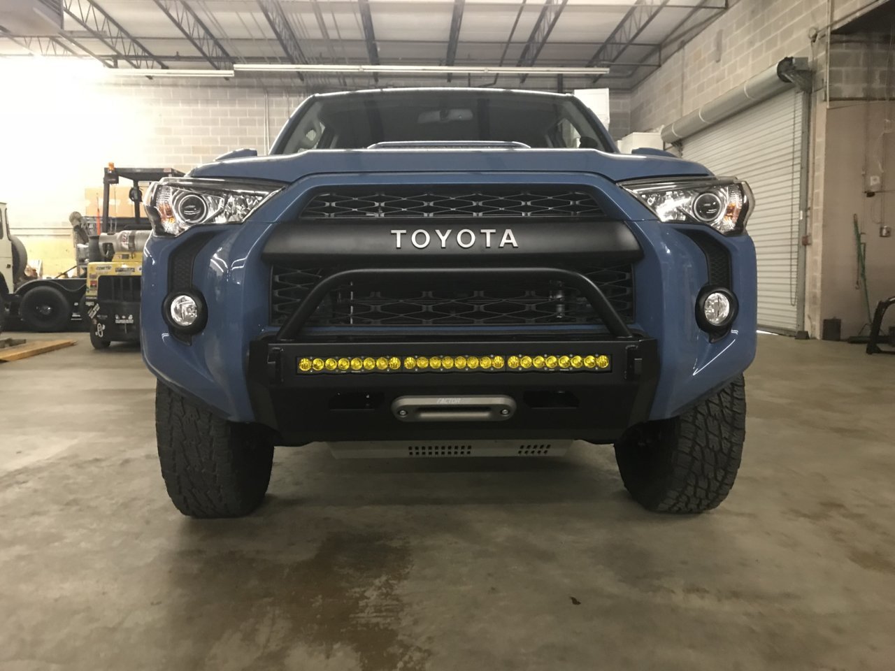

    Thought I would get in the mix on this forum. Bought a newer runner from a buddy of mine.
    Install took right at 3hrs.
    SSO Slimline Hybrid
    Baja Designs 30” s8 in Amber
    Smittybilt xrc 9.5k
    Just need to spool the synth line and connect the Ultrahook.
    Next on the list is some @JDEMELLO Hybrid Sliders (which you should check out if you haven’t).
    Setup the Bantam

    That SSO looks awesome!

    Thanks man! Spooled the winch line and added the Ultrahook, for the cherry on top!

    Very clean install looks great! I am back and forth on doing a slim line or leaving it stock have not decided yet lol.

    I needed a winch, place to put some extra light. As far a looks, it is IMO the only option that retains the factory look, and gives you a real recovery point.
    I am happy with it.

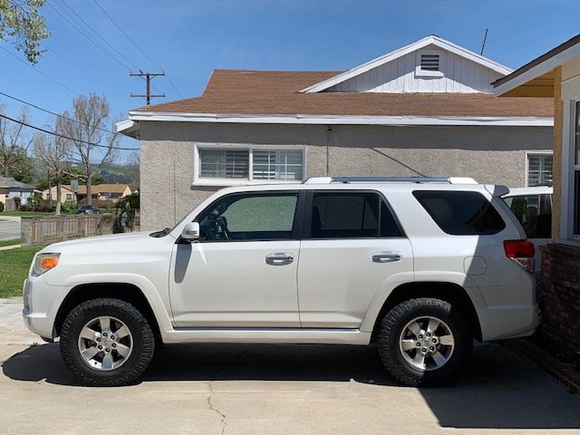

    I was bored so I finally leveled the front and got new tires along with it.

    are you lowered? Looks good!

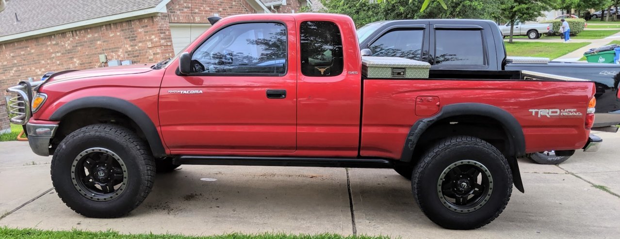

    Moved the fuels to the Taco...

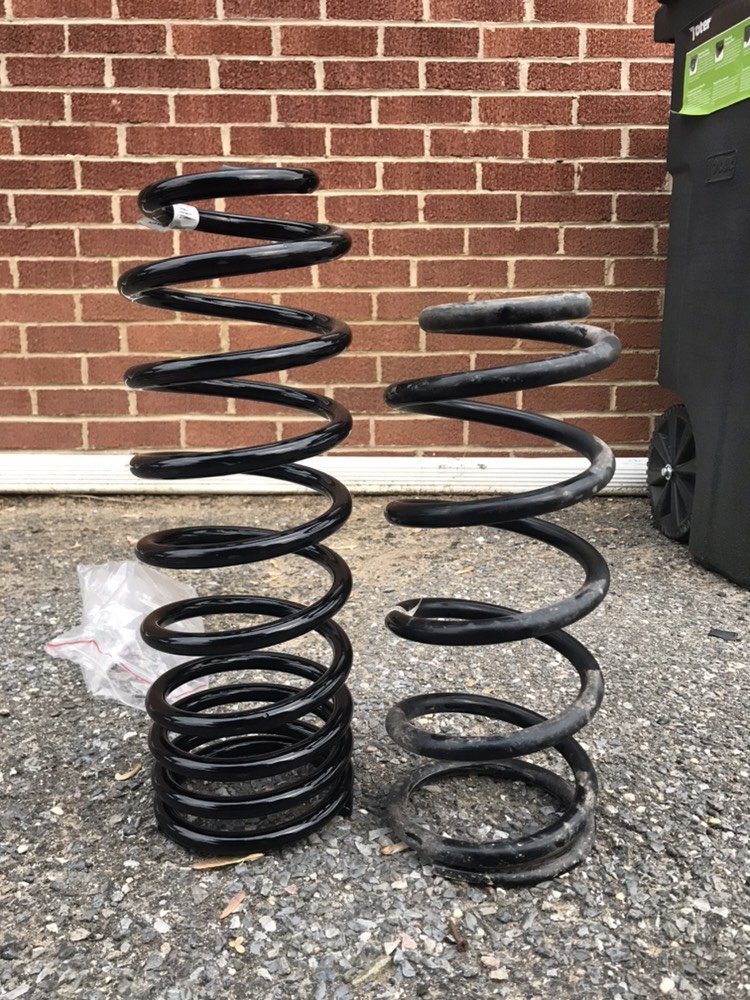

    As far as a lowering kit, I'm sure one exists somewhere. All it will take is finding springs that fit front and rear of a lower spring rate. As far as cutting goes, you would have to cut AND reshape the rear coils because they are designed to sit in the coil buckets (both frame and axle) in a certain way. The frame side is nice and flat and the axle side is a smaller diameter than the rest of the coil.
    Pic of dobinson and ome coils for reference.
    You might try a custom airbag setup in the rear.

    Thanks but no, I'm not. You just see less gap between the tires and fenders but if you look underneath from to rocker panel to ground plenty of space. I'm using 32" tires.
