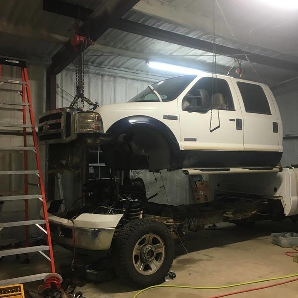

    Starting this thread for people who work on "other" vehicles, be it motorcycles, cars, trucks, equipment, etcetera.
    Yesterday this happened to the 2005 6.0 that's sitting in our shop.
    Doing head studs, oil cooler, and a few other things.

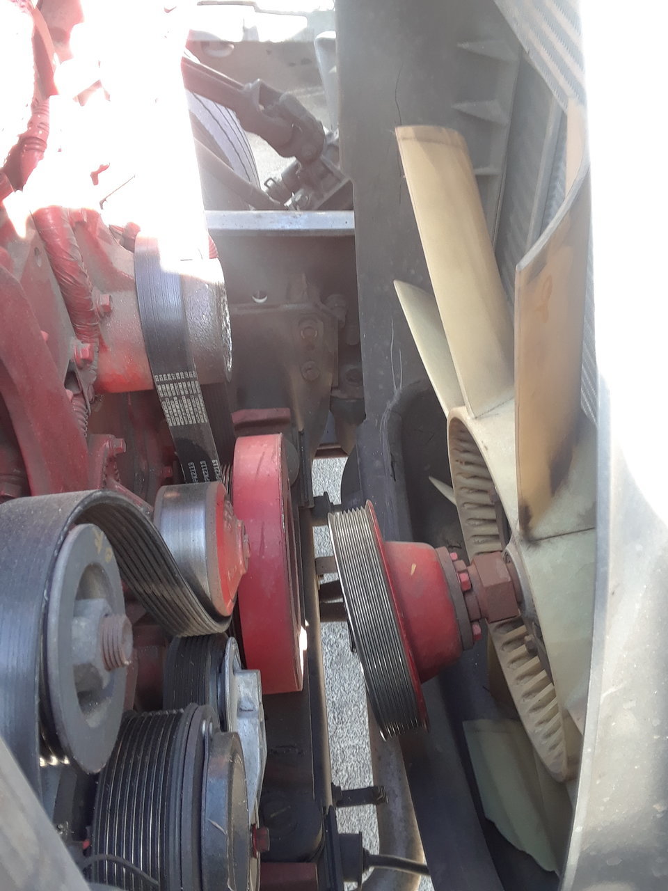

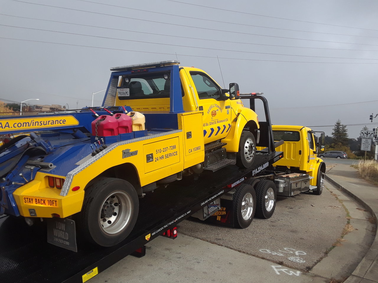

    20171111_102117.jpg 20171111_102117.jpg 20171111_110503.jpg not today ,couple days ago. My truck broke down.had to get towed back to the barn.

    An unusually high amount of pinstriping.
    Did the heads on my 05 this past April. I can't complain to much about the 6.0 though. All the crap I put that truck through (including breaking the front axle) and the heads made it to 265,000 miles. The guy at the shop laughed and said I got the unicorn for the 6.0's.

    We've got a 6.0, 11 sets of injectors, 2 ecms, whole top end, it's a money pit.but the guy who drives it is a slob. So they keep it running.
    95 taco[OP] likes this.

    Dang man, that looks like a PITA, any damage to the radiator?
    people give the 6.0 a bad rep but if you fix the FICM, replace the oil cooler and keep the coolant system clean, change oil/filter and fuel filters and monitor parameters it's a good truck.
    It's definitely not for people who just want to drive and not maintain or be "in tune" with their vehicle, but if you are a gearhead and understand the truck it's really not the bear people think it is.
    We did the head studs because we have a 50 HP tune and routinely tow 15K lbs or more.
    I have to say with a street tune from SCT (I think it's ~120 HP) it's a hell of a lot of fun on the street.

    It's a f450 tow truck. It gets beat on.
