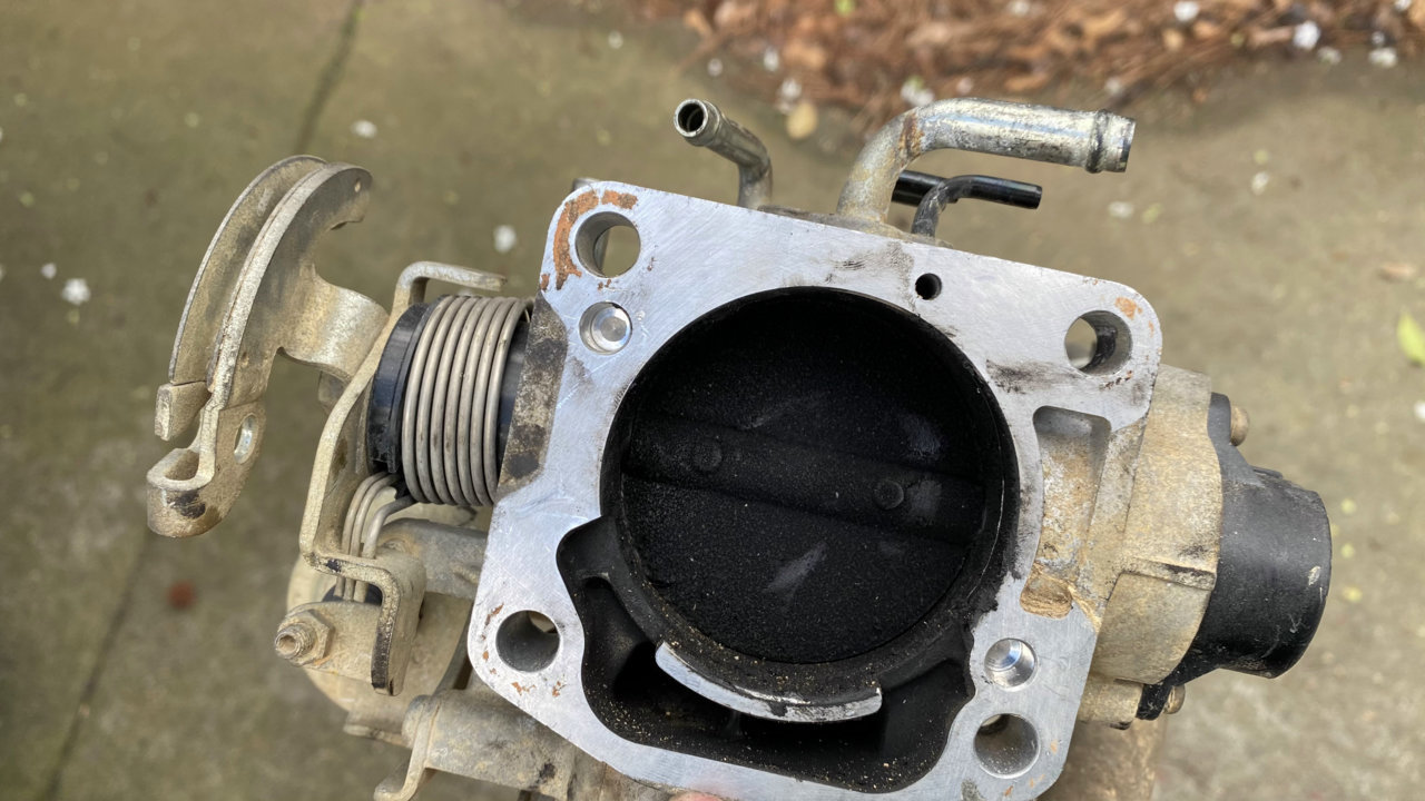

    So what am I looking for? If it fells flat to the touch is that not good enough?
    As I mentioned before it looks pitted in the picture but there’s no pitting that I can feel.

    Machinists trick is to feel it with a fingernail, typically if it grabs a fingernail it needs some finish work for a basic paper/rubber gasket.

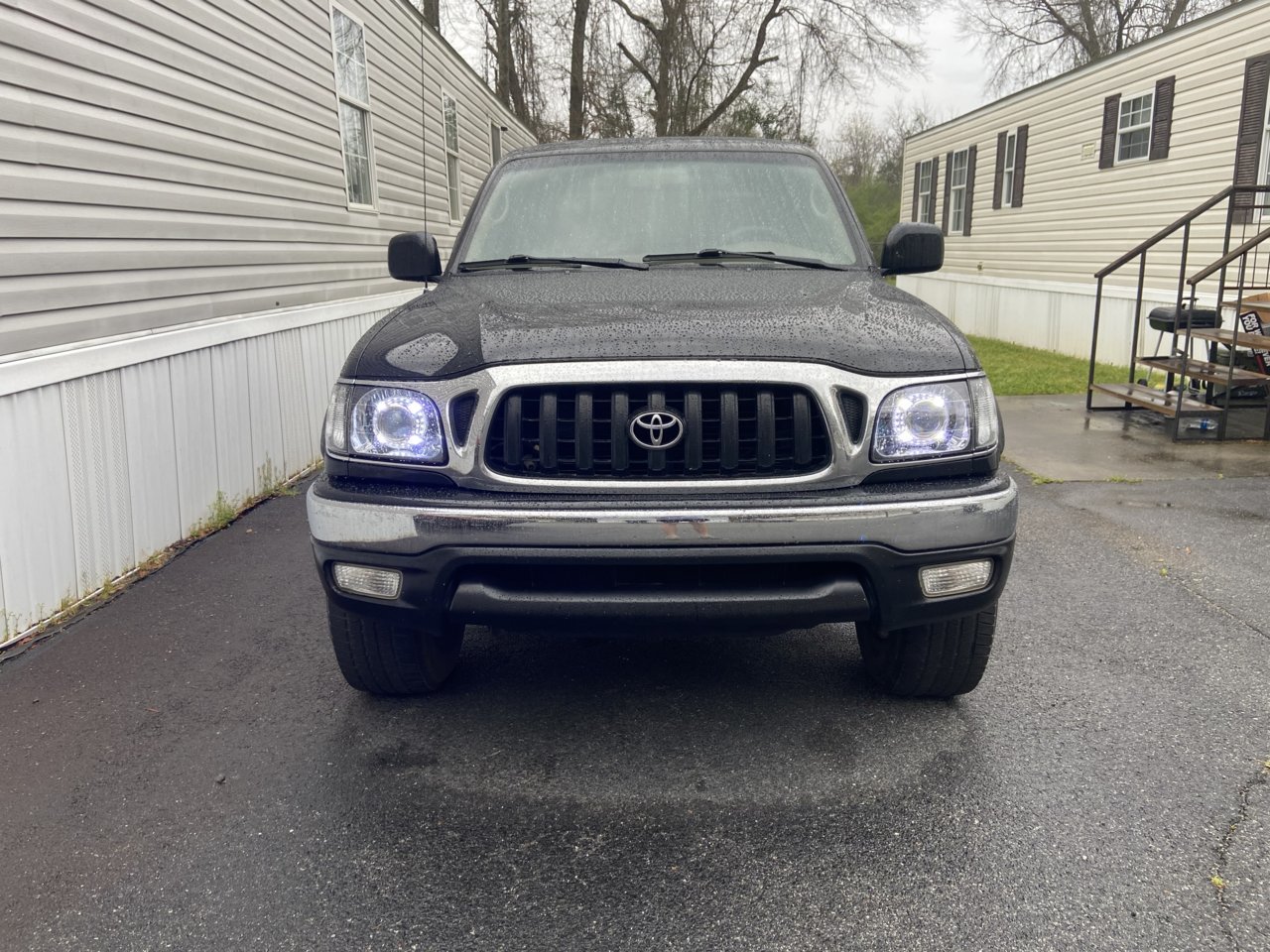

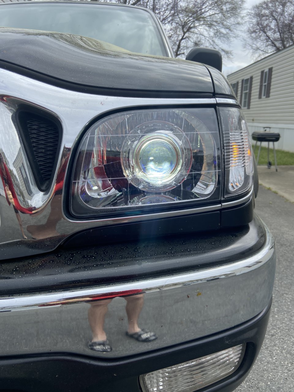

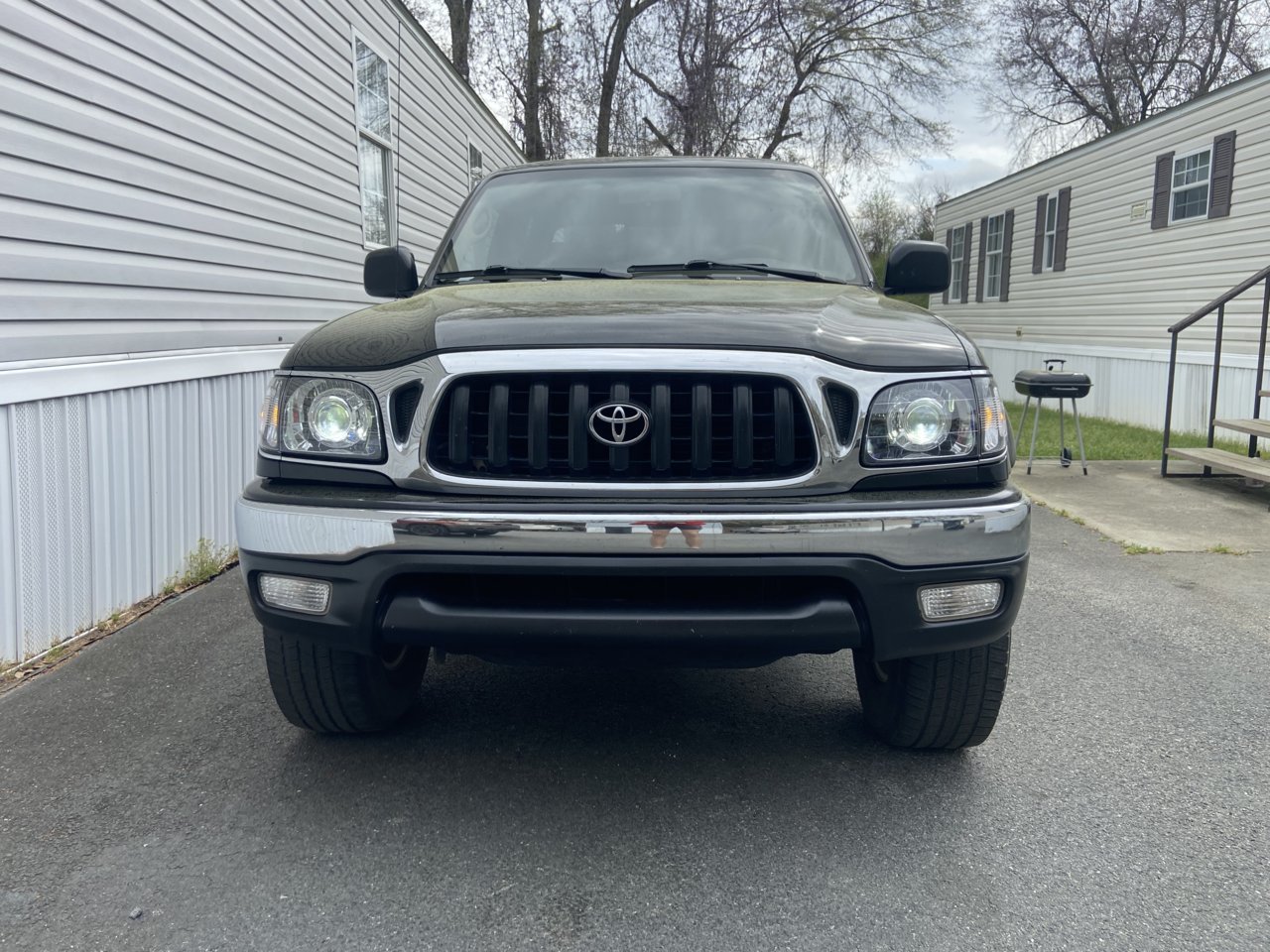

    Did LED upgrades inside and outside the truck. Headlights, Corner Lights, Interior lights, License plate, Tail, Turn Signal (Front and Rear), and Reverse Lights (No Hyperflash). Headlights are from BX-Built, they are Bi-LED Projector Retrofits with integrated DRL with Switchback Amber turn signals.IMG-8610.jpg IMG-8628.jpg IMG-8629.jpg

    Looks great! Did you do the retrofit yourself, or did you buy the full assembly?

    Already assembled. I actually picked these up from a Black Friday Sale that they were having, so the cost to buy them already assembled would have been roughly the same as building them myself. The only downside was that I had to wait 4+ months after I ordered. The light output is insane when compared to LEDs in stock housings.

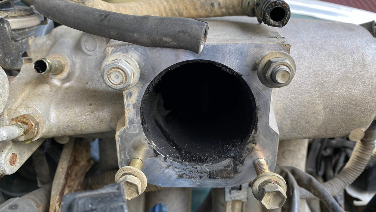

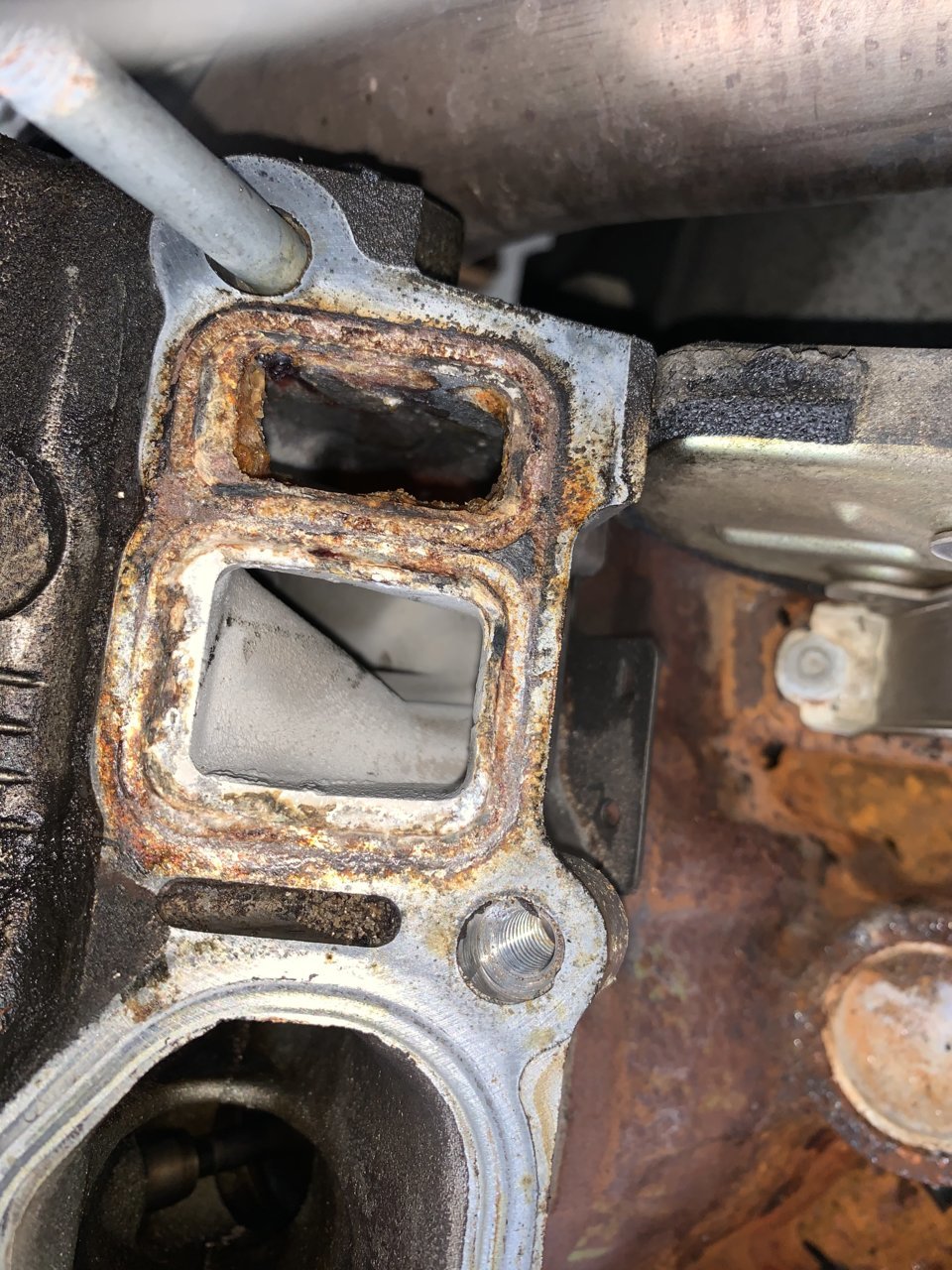

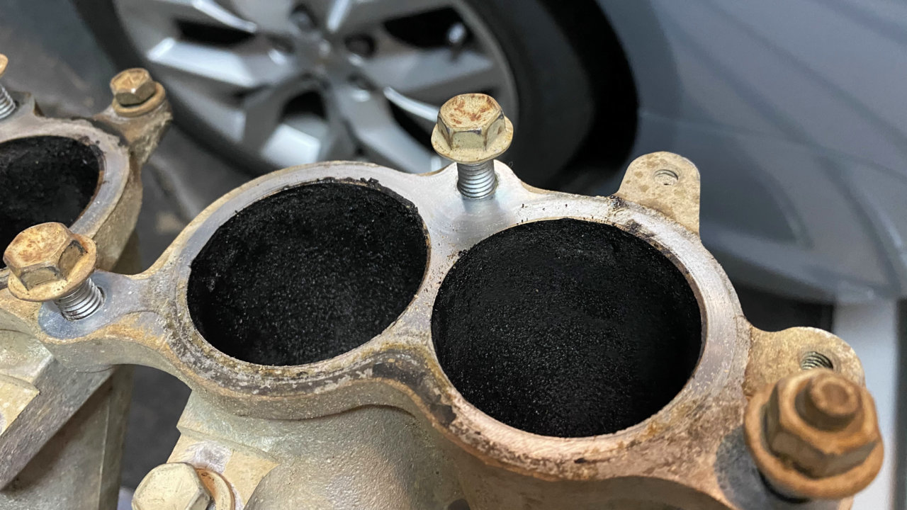

    Took apart the intake to clean all the built up gunk and removed my cracked cast iron exhaust manifold. New parts day as well: New PCV Valve, Mini header, EGR delete, coils, plugs, wires, air filter, fuel filter and gaskets.
    IMG_1887.jpg IMG_1911.jpg IMG_1888.jpg 63780110918__825E1A41-60DC-4E15-92D3-AA3540AB0095.jpg 63831836698__BCD0518C-D0D2-4AE0-B56F-797283D9A6A1.jpg

    Can I ask a stupid question lol.
    I'm looking into having a set built by them.
    How do you like them? Is the projector they provide already have have the bulbs and harness? Does it do both the high and low? Lol I'm so lost.

    Yes! It comes with everything you need. All you have to do is wire the harness up and it’s plug and play using the stock headlight harness for the driver side for high and low. They have a diagram on their website, it’s super straight forward. It’s a one piece unit so everything is included. No bulbs to worry about.

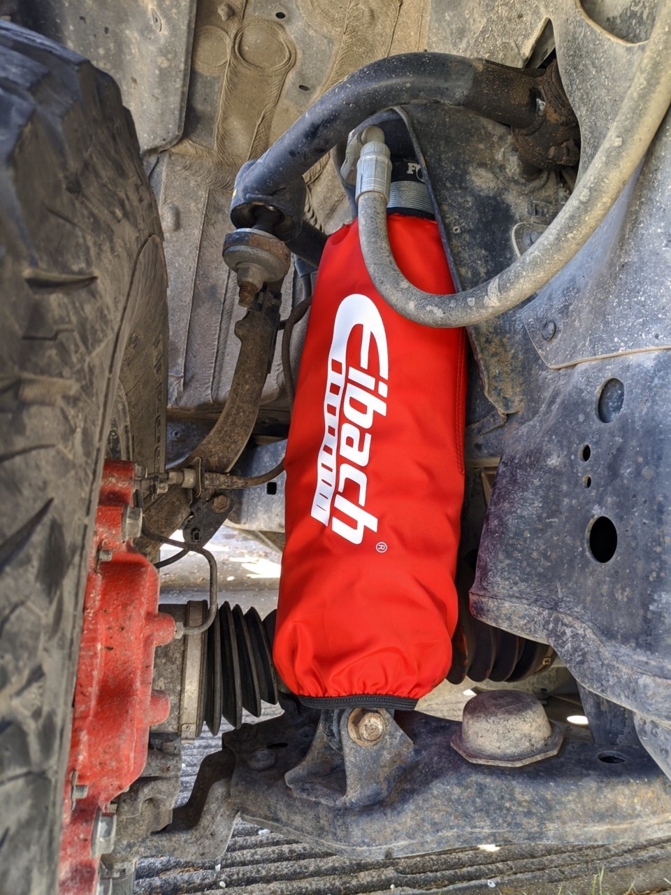

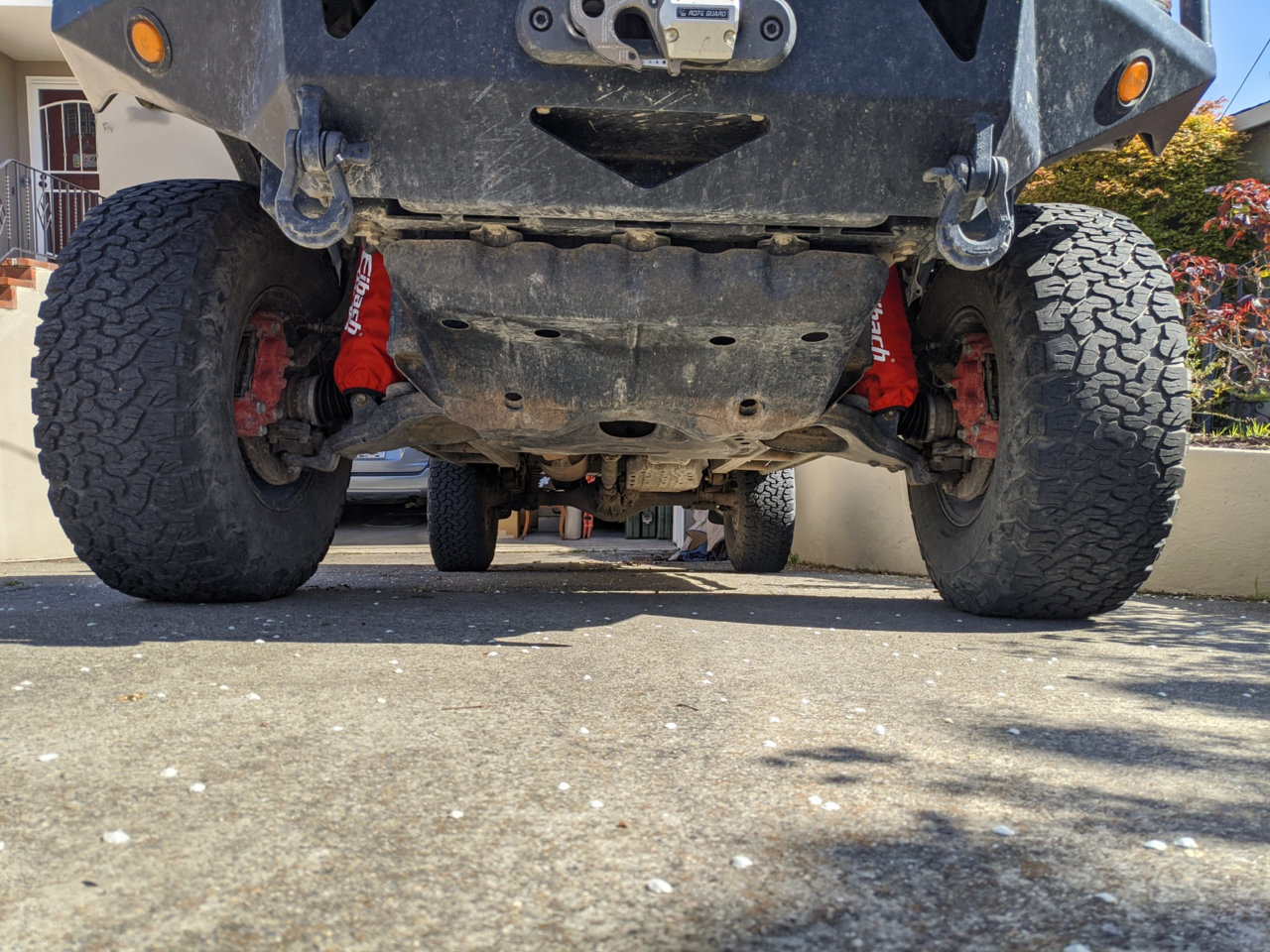

    Got these "spring bags" from Eibach to keep my Fox coilovers (with Eibach race springs) from filling up with mud and other crap when in muddy conditions.
    A bit too "hey look at me" for my taste but now I fit in with the weekly washed and polished mall crawler crowd...except for the washed and polished weekly part. Plus, I expect they will be coated in something which is a color other than red by the end of this weekend. And, they are either Made in America or the chinese sweatshop sewed in a "Made In The USA" tag.

    You... you put bags are your shocks to keep mud out?
    hmmm

    do they make King branded bags i can put over my cheap ass OMEs?
    gotta fake it til i make it :rofl:
