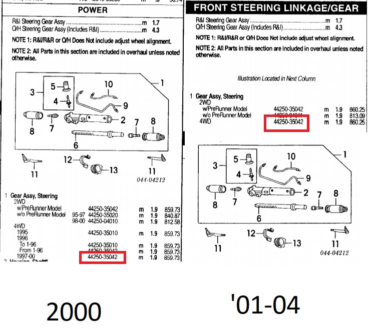

    OK, steering rack bushings. I have a 2000. This kit at Wheelers that @Digiratus kindly recommended says 01-04. I have a hard time believing that they aren't the same. Anyone verify that it does/doesn't work on an '00?
    Looking in my parts lists, the rack part # is the same

    @Speedytech7 knows, if I recall in our other thread he talked about the minor difference if there was one...I can't remember what it was though

    They're different all right, the sleeves for the center bushing change as does the bolt size

    OK, so what's my best path forward?

    The rack did change right around 2000 iirc.
    The older rack has a square protruding out that adjusts the rack guide. The newer rack has a giant allen bolt looking thing.
    The newer rack's guide is better. I think @Timmah! has a video on changing the older guide out for the newer guide.
