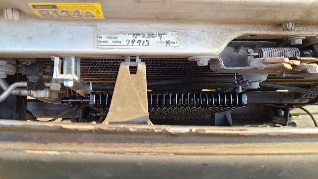

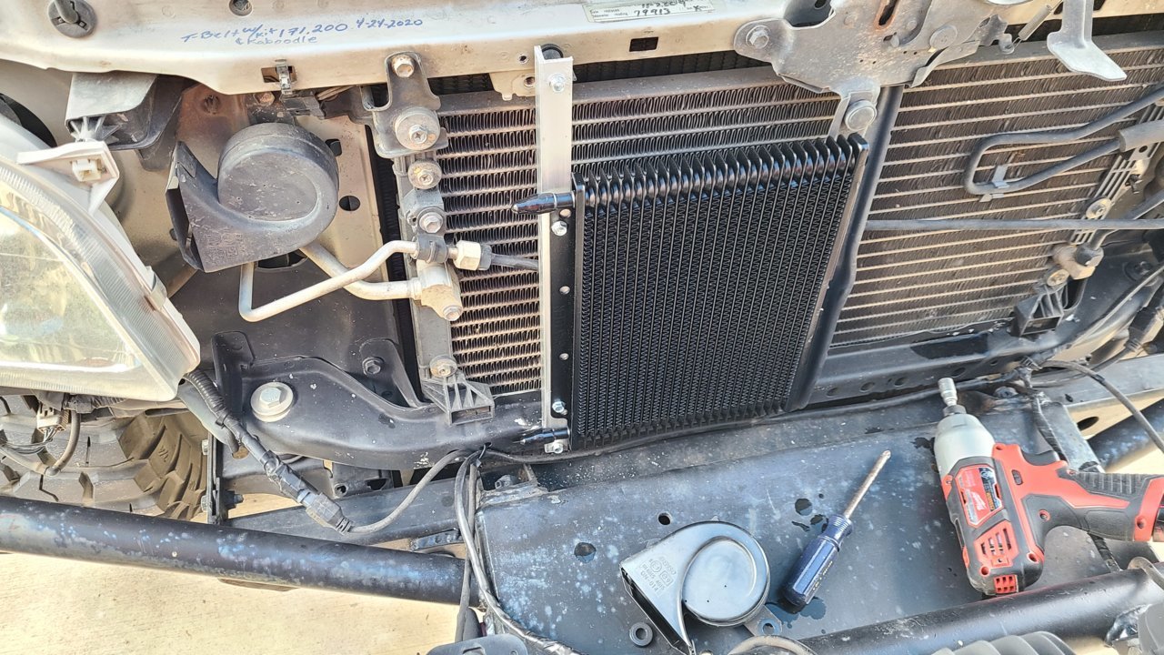

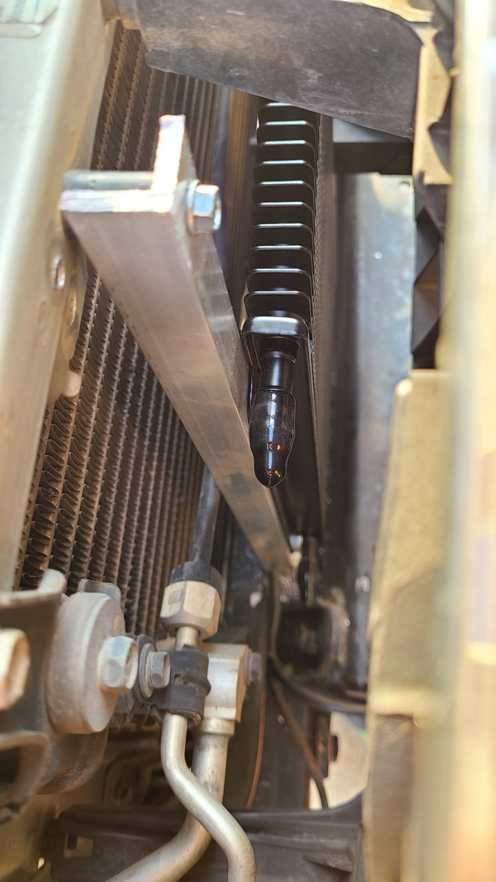

    I just finished up the trans cooler install. I added the in-line filter that Timmy recommended in his 4runner video. I used his video as a go by for the plumbing.

    Did run it before or after the radiator?

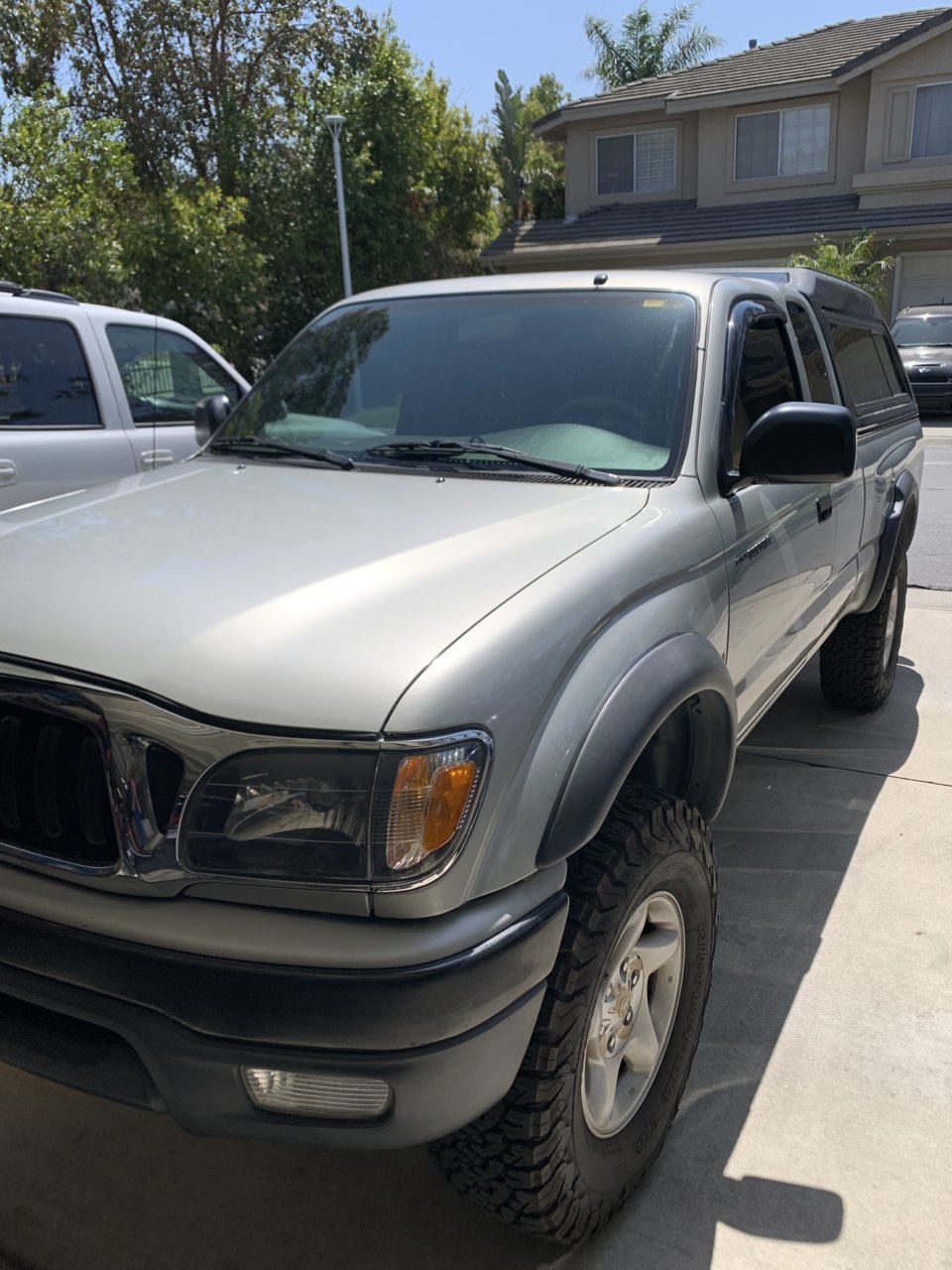

    Got her a cap Friday night. Washed her Saturday morning, them washed, claybar’d her, some paint correction buffing, polished and the carniba’d her. Now to get shell finished up nice.DB15B0E3-532A-41EB-8EE9-5F50156F6EDE.jpgBA8AF796-F13C-4047-9A16-94C3BF19B3E6.jpg04520E29-1E6D-4852-9B89-43EDCA93B5E2.jpg

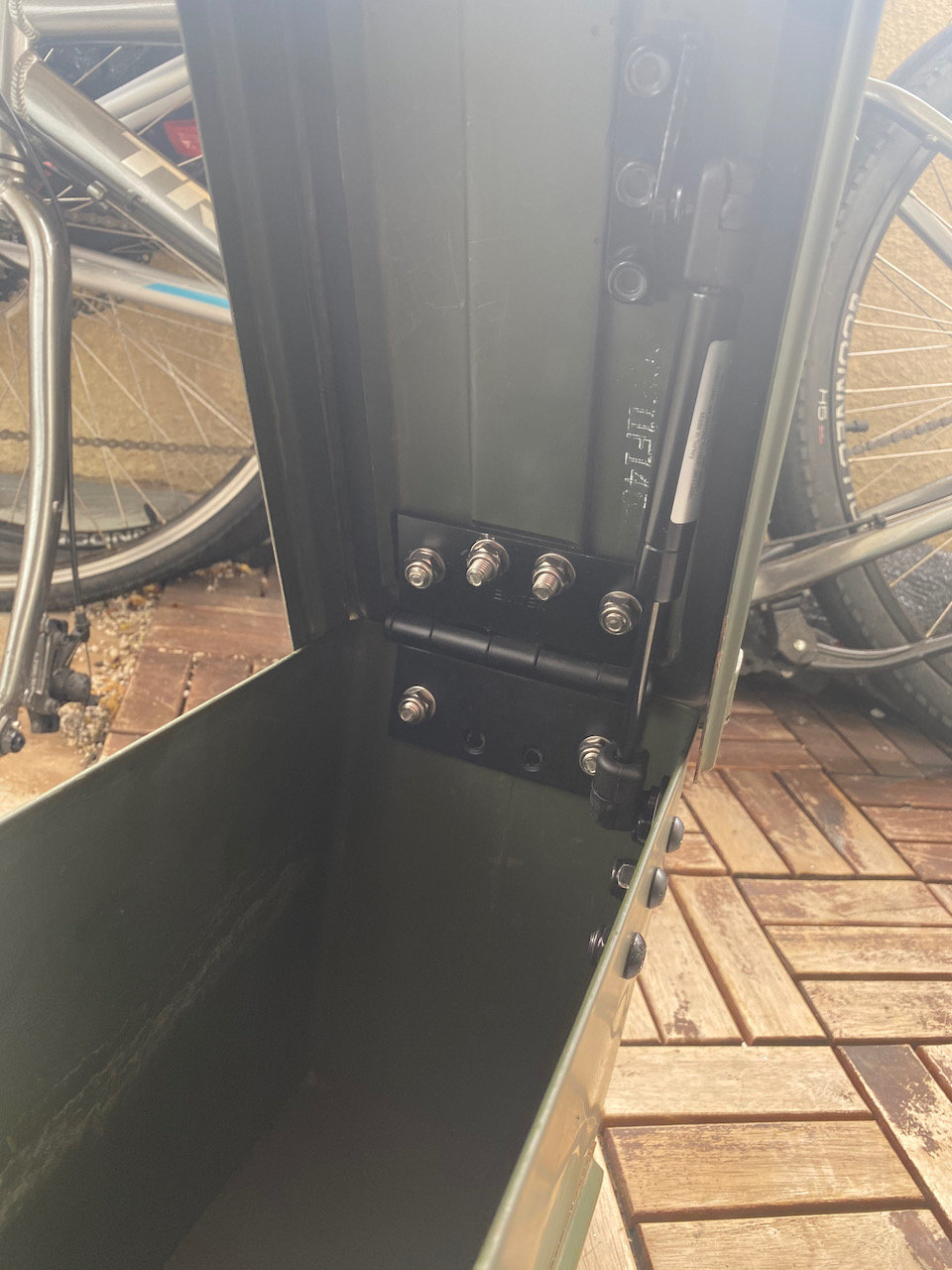

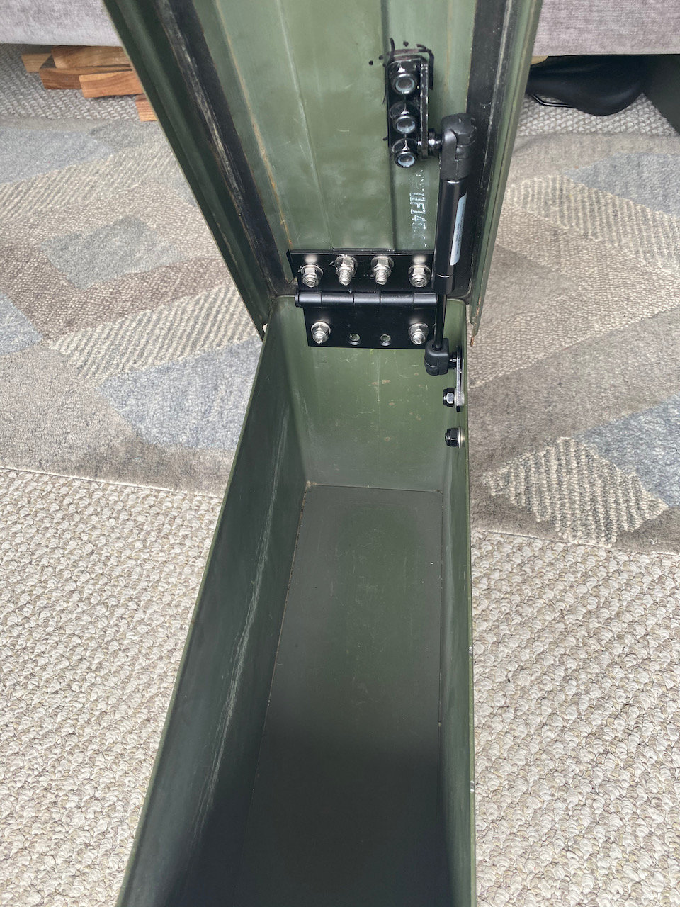

    got me a 40mm ammo can. Added a gas strut to it and a hinge to open it easier. Going to add a slide out drawer back of the truck bed near wheel well.

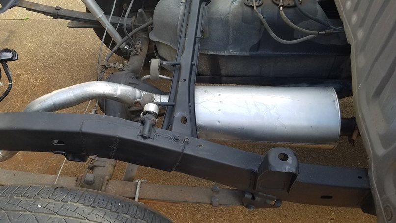

    I forgot to mention something when I posted this the other day about replacing my muffler/tailpipe assembly. If your tailpipe is still original and is being replaced, the last 4 inches or so can be cut off and used as the coupling you need to attach the new muffler to the center section of exhaust pipe. It is over-sized and is just right for joining with 2 1/2" clamps.

    I plumbed it after the radiator.

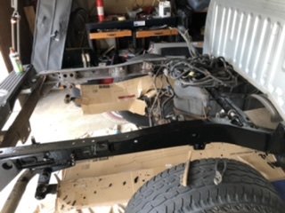

    I over heated my engine just before Halloween. Crank bolt backed out while on the interstate so I lost all my accessories, ran into a traffic jam caused by an accident and quickly blew the radiator apart. I picked up a JDM engine and have been working on getting it ready to drop into the truck. It's been a slow, fun project. Mainly slow because I work a lot and have 2 kids. My dog also needs a lot of attention. Here's some pics of the progress thus far.
