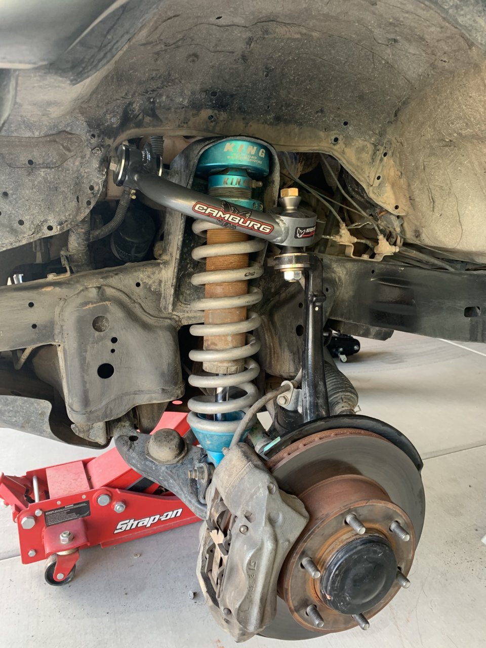

    Got my Camburg uniballs installed over yesterday/today. So fucking proud of myself since this is the first time I’ve had anything involving press work go smoothly. Every time I would change the stock ball joints in the past it would always be a nightmare getting them pressed in evenly, not having the right adaptor, not a good angle, no vise, etc.
    I pulled each spindle and did the pressing with a c-clamp press in a vise and it was sooooo easy. I bought the Total Chaos press sleeves thinking I could use them with my Camburgs, but completely overlooked the fact that their spindle adaptor is not a puck like TC’s, it has the lower uniball adaptor machined into it as one piece so it wouldn’t fit in the TC sleeves. I happened to have one that it would fit and slapped a little anti size on the spindle and pressed it in nice and evenly without much hassle. The TC ones still worked great to press the stock bj’s out.
    Sorry for being a windbag, but this is one of those jobs I’ve put off for like 6 months cause I just didn’t want to do it and it just went so damn well. It’s been a while since I’ve had this feeling when working on this truck haha
