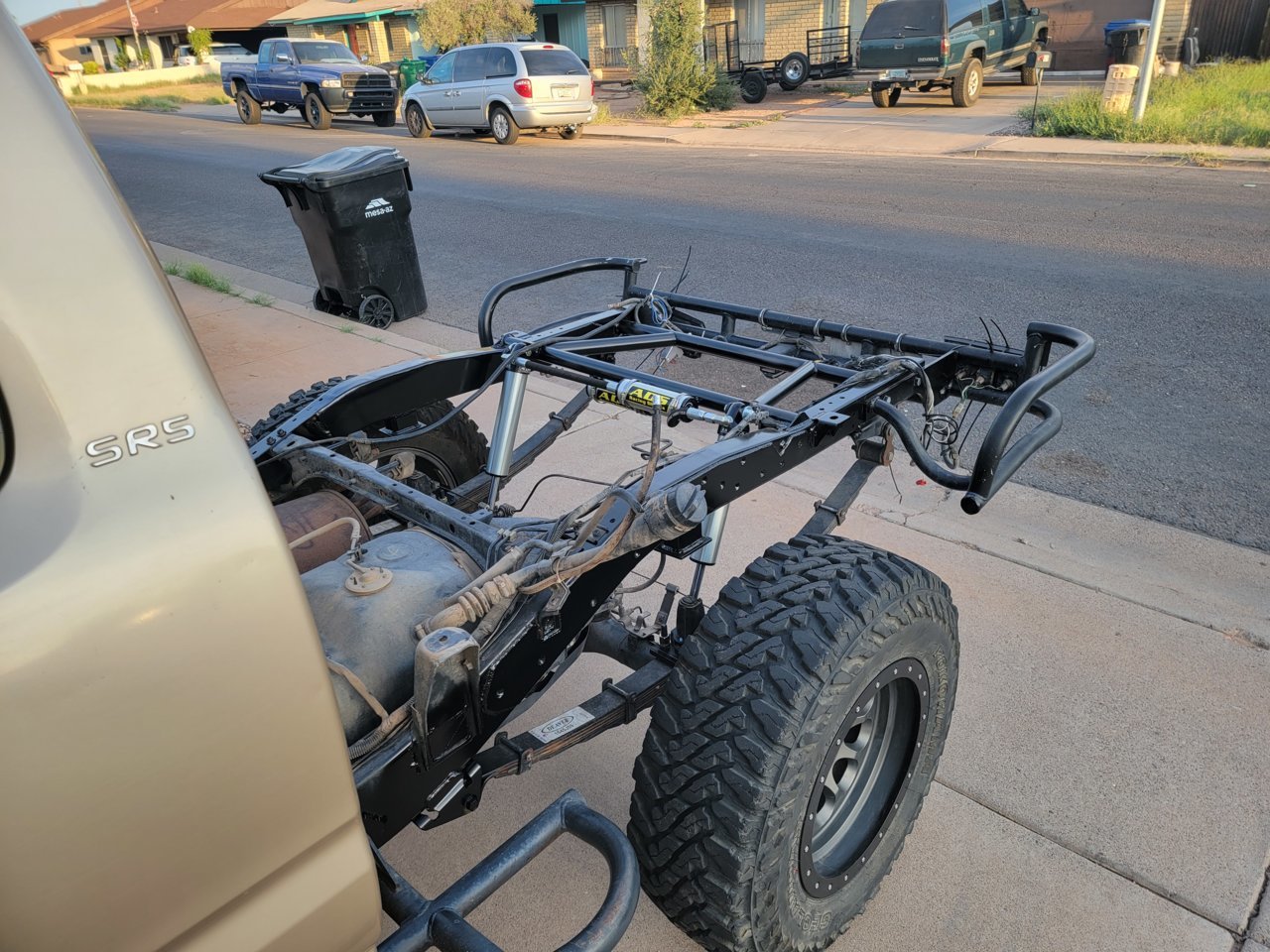

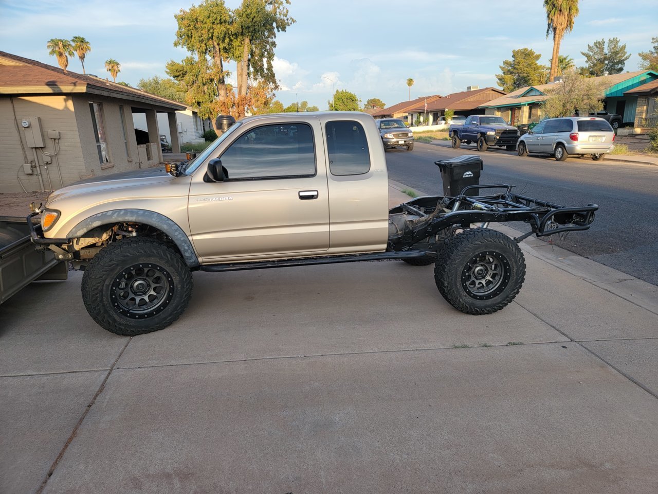

    Got my truck back from the fab shop. Rear Is boxed in new shocks relocated.,u-bolt flip kit and new lowered and larger bump stops .
    I'm gonna run some cables and then I'll get it put back together. It's a lot faster without all the weight in the back but the ride was a little stiff. A suto flatbed with my shell on it might be cool to run. I kinda like the way it looks without the bed.

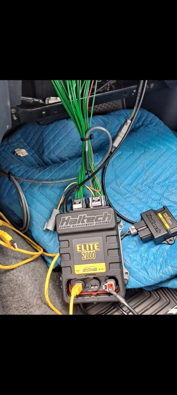

    Well got the haltech 2000 Stand alone installed and tuned!
    The rabbit hole :)
    This is a huge upgrade for your Supercharger
    No more open loop, closed loop to deal with!
    No MAF to deal with!
    Power now comes on immediately at 1500rpms
    No power surges at 3500rpms or waiting for the open loop to be triggered,
    You will get a 10-20 power increase up the ENTIRE power rpm range depending.
    Your biggest power will be in the lower rpm range 1500-3500 rpms.
    This is a dead zone with the stock ECU for power in this area.
    Perfect AFR 12 now on the entire rpm range.
    Much better timing numbers.
    Haltech can also control the automatic transmissions shift points and rpms shift points too.
    Gabe at http://www.snpspeed.com/index.html can do a remote tune to get the truck running perfectly with full support.
    He has to make a custom wire harness per your ECU because of all the difference toyota changes they made.
    I highly recommend Gabe SNP work and his kits if you want a perfect fit for your supercharger.

    Did you have any issues getting the panels back onto the interior with all the added material?
    That's always something I've wondered about when adding all the MLV in particular because it's decently thick
    Your fab shop does great work. I've always been impressed with how it's turned out on your truck like on your swingout.

    Thanks guys!
    Will do !
    I just put the fenders back on. I'm going to try and heat and bend the liner back a bit.
    The shop charged me 1k to do the welding. The Shocks were 1200 .so probably 2500 for everything. Flip kit brace kit ect.
    Had to go to a new shop the other one wasn't really doing any side projects right now. But the new welds look good. There just pricey compared to the other place.
    I really need to get better at welding so I don't have to keep paying out so much.

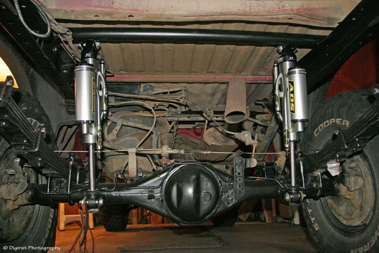

    Here's the work involved, if you're interested in doing it yourself. A bunch of us now run essentially this same setup, which I'd say Speedytech7 put on everyone's radar, and then I got ADS to build the first set of 10" shocks for the rear. It's turned out to be a great setup for 1st gen Tacomas.
    How-To: Toyota Tacoma Rear Shock Relocation
    I think Mike @Digiratus has the prettiest setup, since he has the bypasses and piggybacks.

    That is a super nice setup @Digiratus

    if you have offset wheels or spacer you can get away with mounting an even longer shock outside of the frame with hoops

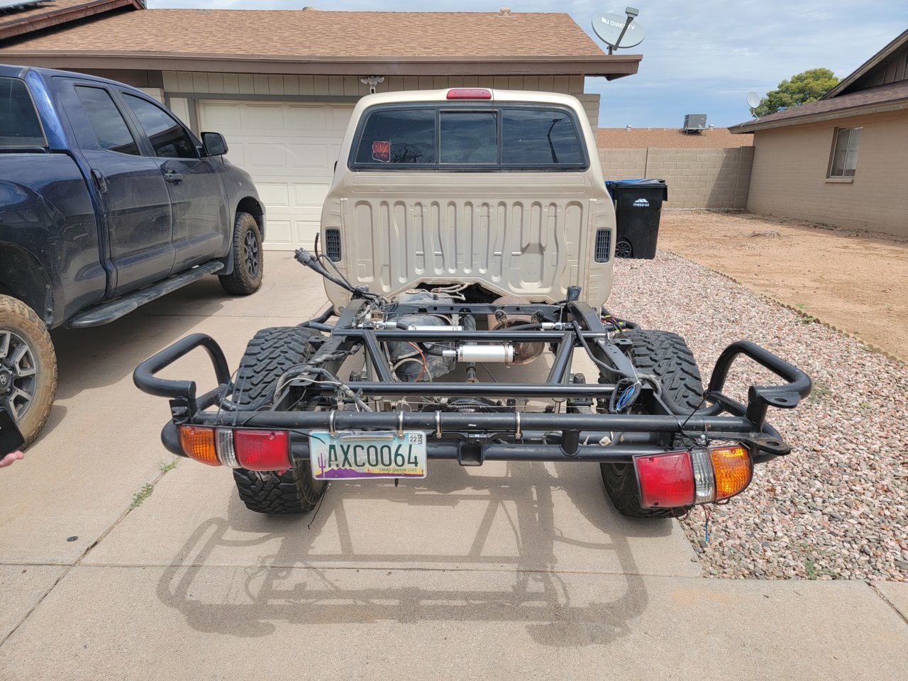

    I totally sent the fab shop your link on how it's done. Thanks for all your and everyone else's efforts in putting that together.
    Here what mine looks like from behind.
    It's hard to see but the plating was tied into the shack mounts also.

    Man I was waffling on going that way for a long time.

    I like this idea too. Do you rub your shock bodies when flexed?
    edit: I have 1.25” spacers on the front and rear.

    I definitely had the benefit of learning from the mistakes of others. It turned out just about perfect.

    local small-scale shop? Very good work
