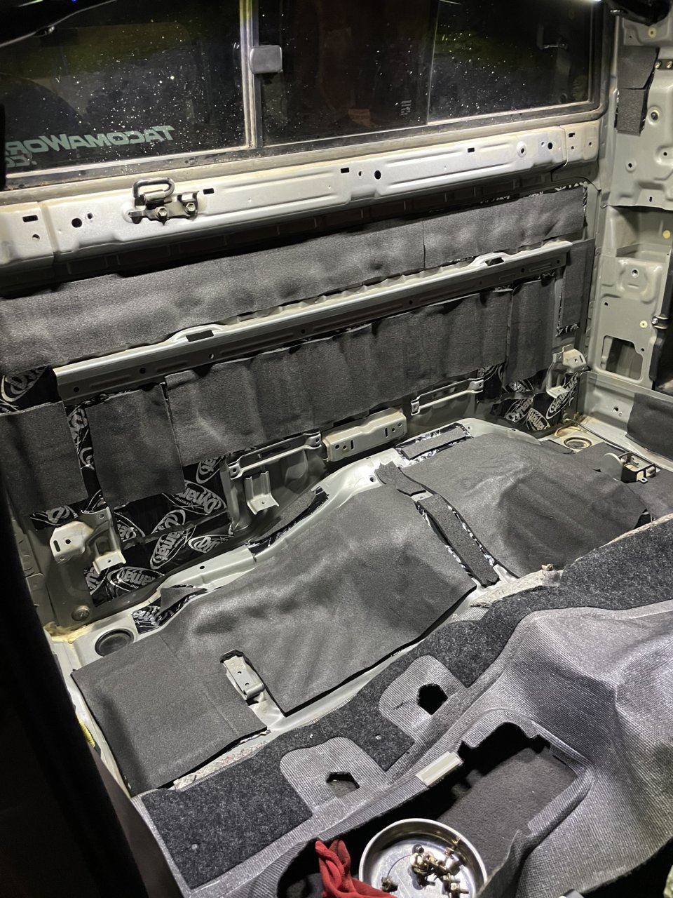

    Made more progress on my sound damping. Got the back quarter panels done , the rear wall and the rear cubby’s. Going to pull the carpet out tomorrow. C1412365-58E3-470E-9600-7F8E7D37E9DC.jpg 0524F081-14DA-4C4A-AC27-490E859798F5.jpg

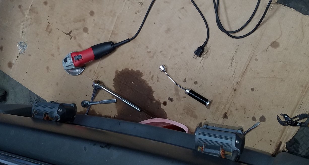

    Sprung a leak in my radiator last weekend. My replacement is due Friday. I have also been putting off valve adjustments, so I thought I'd start dis-assembly for both tonight.
    Wait, why would I need a cutoff wheel for a radiator removal? (and who removed the guard :anonymous:)
    Oh, forgot, I live in the rustbelt. No bolt or nut is just going to come out without a struggle. Both lower bolts looked like this and refused to break loose:
    There's no finesse in working on a 25 yr old truck in the rust belt. You just force for it to tap out.
    Also discovered my water pump has significant play in the bearing. I am going to be delayed putting it back together until I can get a replacement.

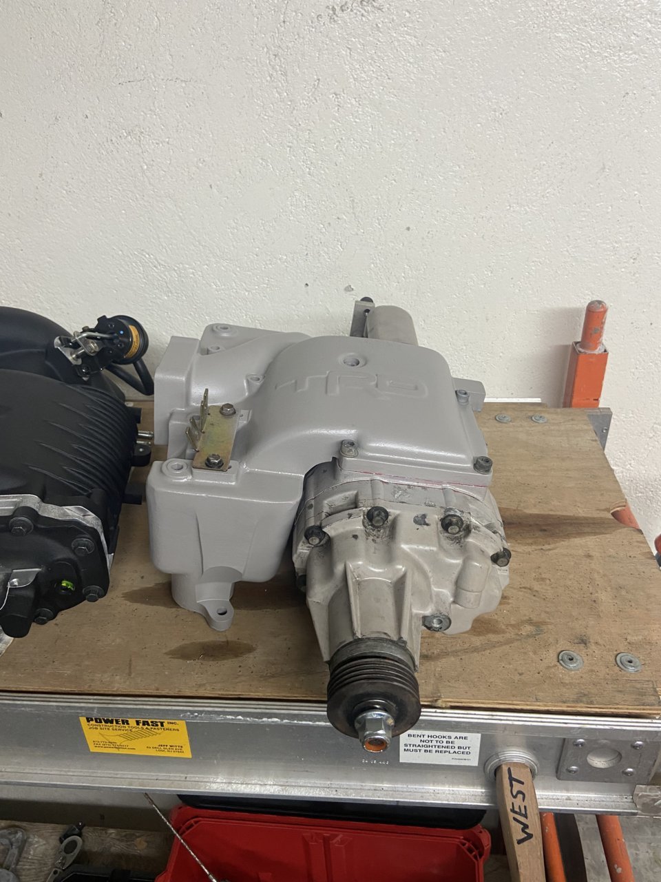

    Sweet a crawl box and super charger. Did you go with the 4.7 gears?

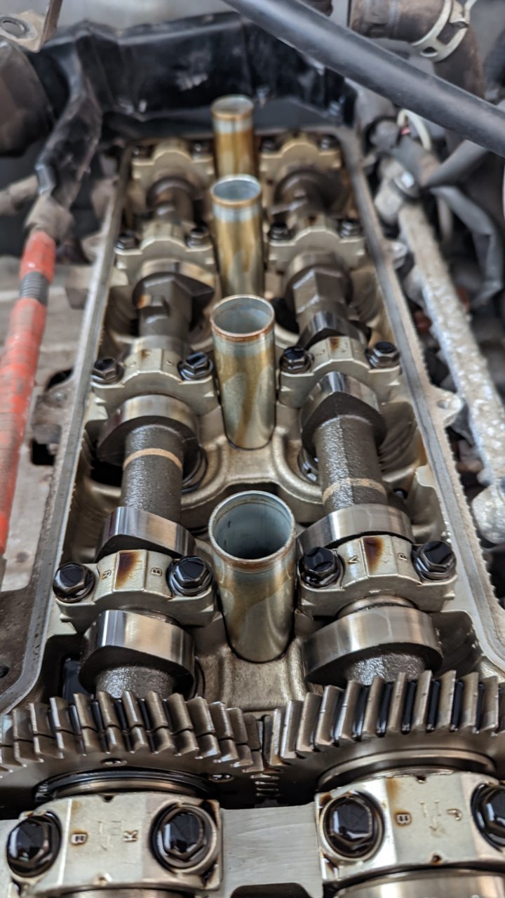

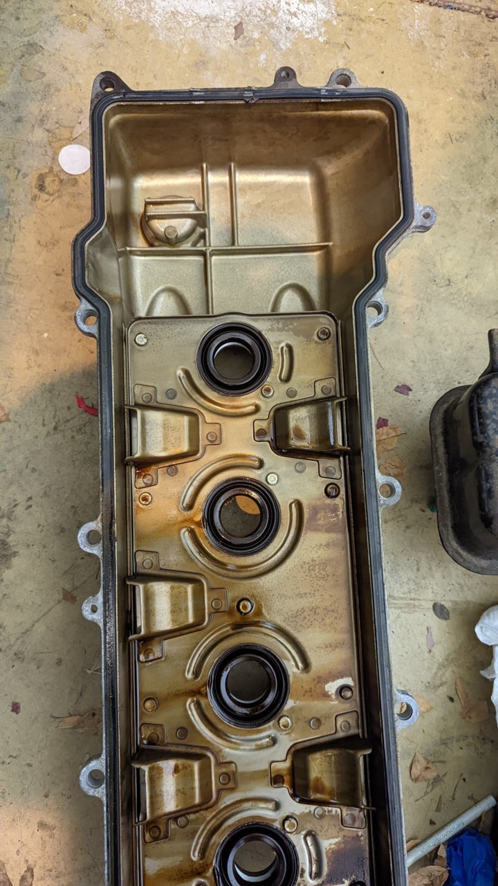

    I was going to replace the PCV valve and the grommet and of course the 22 year old grommet had other ideas. Sneaky bastard. So off comes the valve cover. Pretty sure it has never been removed. A prime example of modern oil and proper drain intervals treating a hard working 4 banger right.

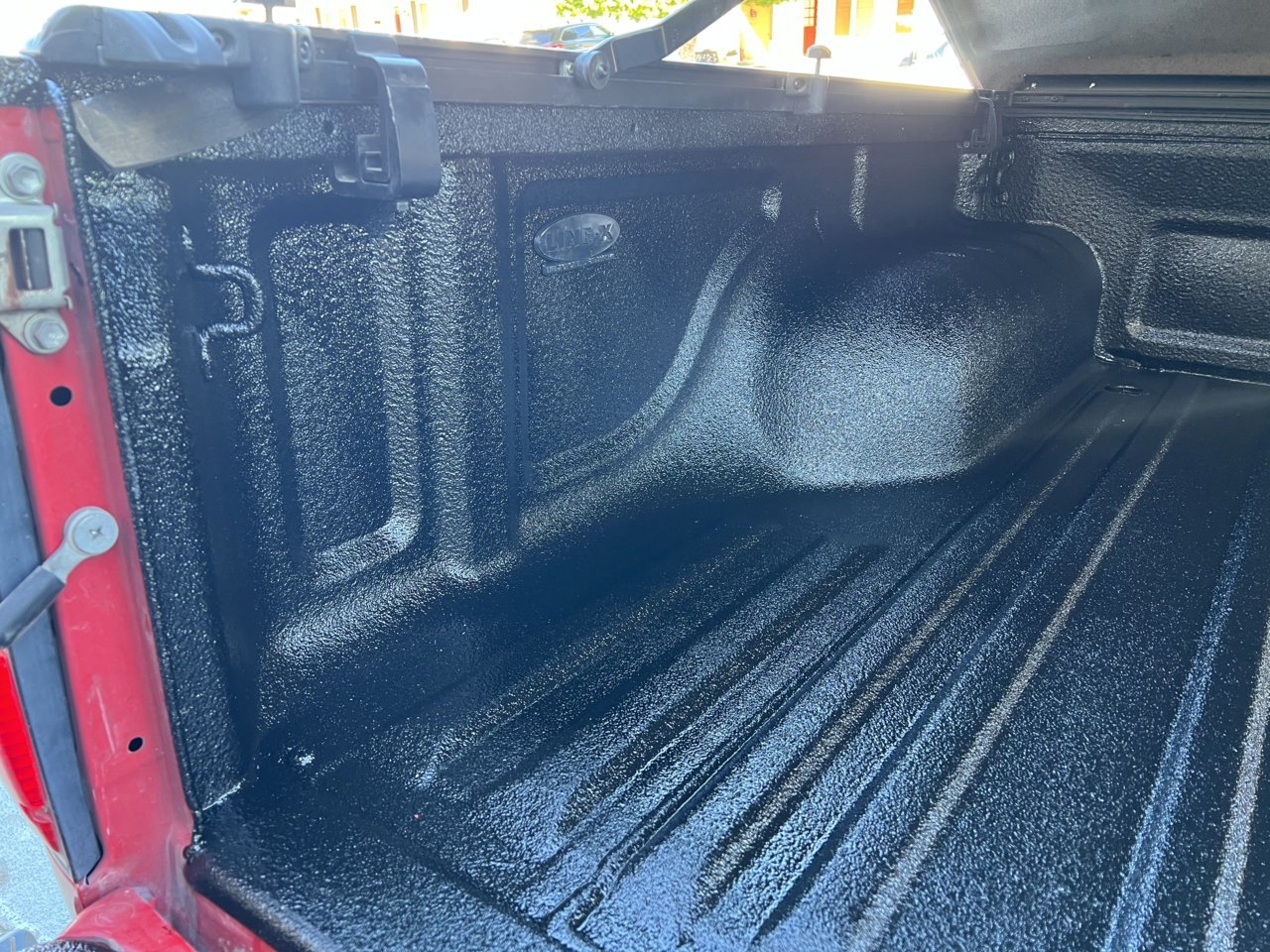

    Got the bed sprayed from Line-X. Waiting on the tire rack from N-Fab to come in and will also be mounting the pro-eagle jack.

    Im laying down dynamat/dyna liner in the cab and the plan was to replace the carpet with a vinyl floor. But I’m wondering if it would be a better idea to keep the carpet and just put the vinyl floor over the top. For extra sound damping. My thoughts are the reason to remove would be to avoid having wet carpets that have the potential to get moldy under the vinyl. But on the contrast I’ve never really had water issues…
    what do you guys think?

    best thing to add to the floor is Mass loaded vinyl. The floor is already pretty stiff so it doesn't resonate as much as say your doors do. Then I'd put the carpet on top of that for a bit more absorption(not a lot really) and diffusion.

    +1 to mass loaded vinyl. Even if you never dealt with water ingress in the cab yet, if it happens once you will hate yourself for not installing something that is naturally moisture resistant. Also trying to have the current panels close down on something as thick as jute padding + carpet + vinyl will also be a huge pain in the dick.

    yeah I’m using the dyna liner. That’s their version of MLV. So maybe I’ll just skip the carpet and finish with just the vinyl top. End result being: dyna mat, dyna liner and then vinyl floor
