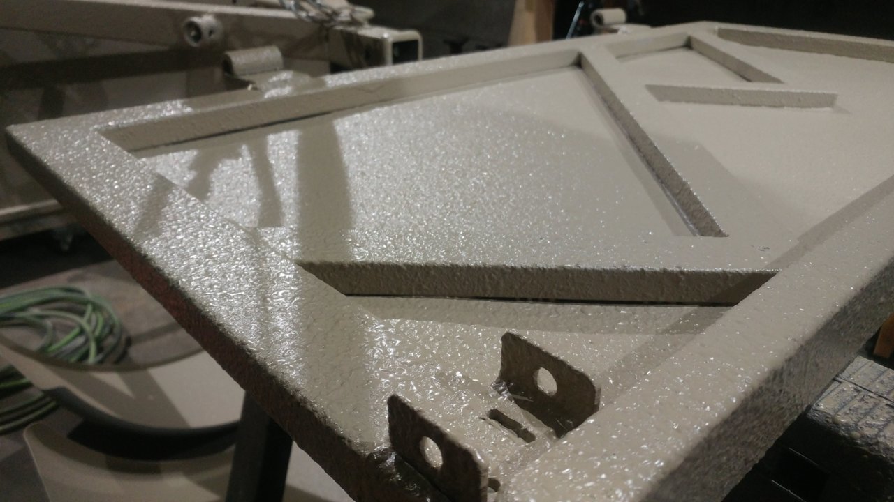

  8. Feb 28, 2022 at 3:13 PM
    Red October
    Red October Well-Known Member
    Dec 25, 2016
    #205654
    192
    2013 DCSB
    I've used this too, I have it on an offroad trailer. Over-all I think its a pretty decent product for what it is. I sprayed it and got a pretty nice texture. Its been a few years now and it never turned chalky or dull, and it still looks good, mostly. Being on an offroad trailer presents some unique challenges, and I have found that it does rock chip pretty good on the leading edges of my fenders, and heavy use areas have worn thru. And as is the case with any paint product; prep is everything.
