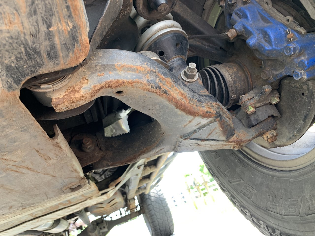

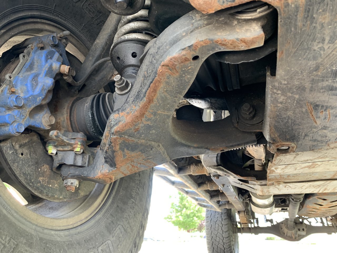

    Those, actually, look like a LOT better design, that would actually offer a lot more strength.
    But... I already have these BAMF skids sitting in the garage. Not sure if Keith can get me a set of those before the weekend. And, well... let's just face it... us cheap assed 1st genners don't pony up cash for anything. So, I think I'm gunna go with the free route for now.

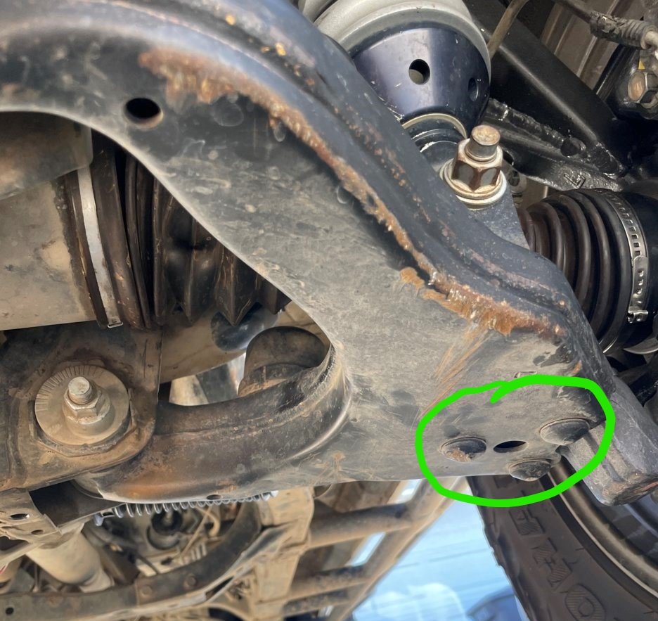

    Did you have cracking around the rivets when you installed those? I certainly did when I finally gave up on the stock LCAs, but those gussets are definitely the way to go if keeping them.

    Ok, so on a serious note. I checked out @eimkeith page... because that kit looks really good.
    Unfortunately he went out of stock yesterday and it doesn't look like he'll be restocked till 7/11. That kit is going on my future plans list. I didn't even know he started making that kit.

    No cracking yet, but I just realized that those LCA's were new with the frame in 2016. Not sure how the OEM 2001's looked when they got removed. The new frame really gave me a good jump of point to strengthen everything from.

    I got a set. I don't understand the "you are losing clearance". Its minimal. Hammer down and get over them pebbles. Get them on and run them Matt. Won't hurt anything .
    Same with the diff skid. 1/4 inch has yet to get me stuck or hung up :boink:
