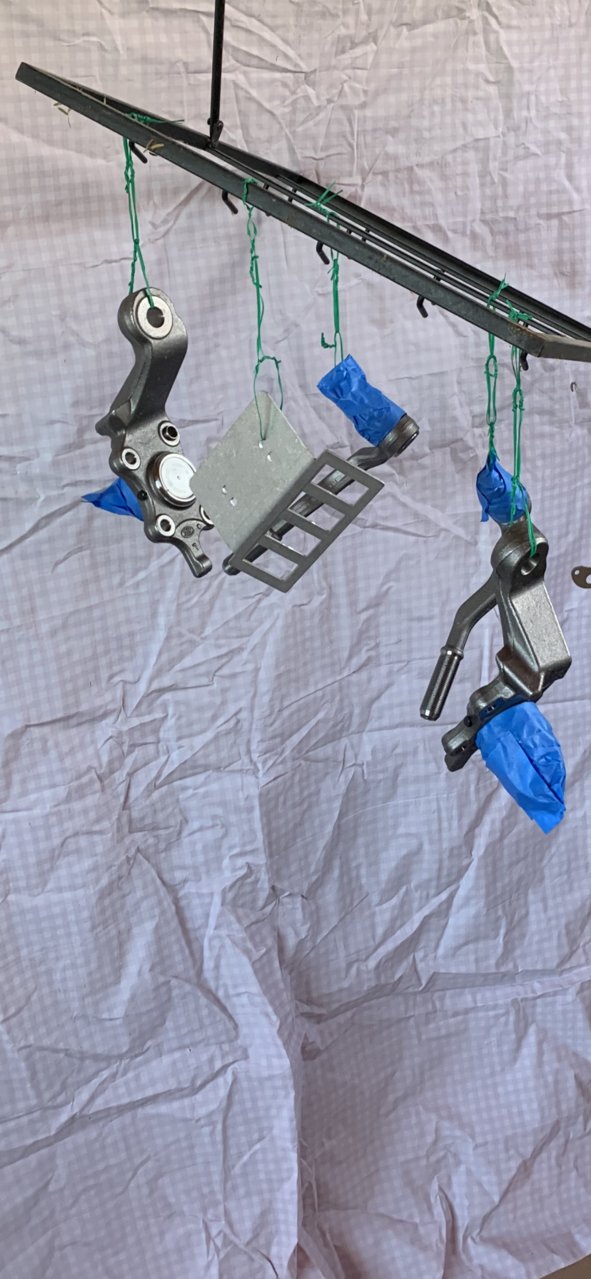

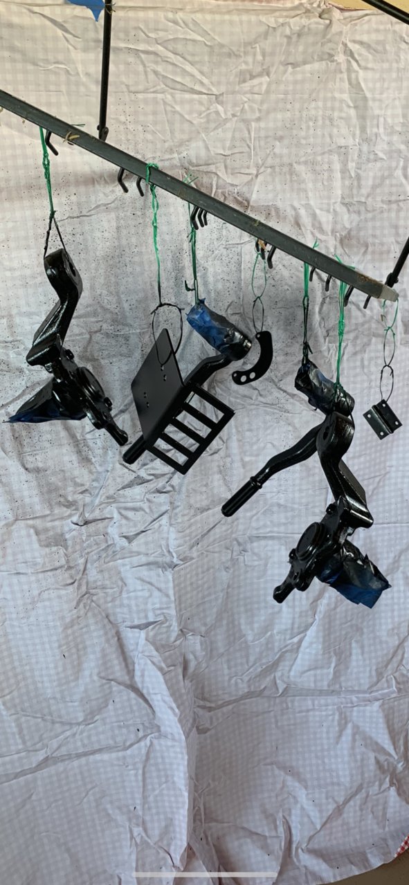

    Wondering if I ruined these lower ball joints and tie rods. I ordered the LCE Sankei 555 lower ball joints before reading all these threads saying to only buy OEM because they come painted and a lot of other reasons. Anyway, I was painting some other parts with steel-it and decided to hit the ball joints and tie rods as well. I masked off the threads with the castle nuts and the boots, but painted the tie rod threads. Are these still okay to install? Or should I paint strip and wire brush those threads?

    I'd at least hit the threads with a wire brush.

    If the threads are good, you're good. The important part is to make sure the bolts are torqued correctly and to check them annually (said by someone who doesn't, I'm not a great role model). I believe 555 is OEM these days; if the joints have a zero fitting they aren't. No fitting tells you it has a Teflon surface inside like OEM had. Another thing at is if the surface the flanged bolts contact at machined, that's OEM. If they aren't that's aftermarket and in my opinion allows for more movement that exaggerates the failures of the bolts on the LBJ.

    @m3bassman @easleycrawler thank you for the feedback. Glad to know they are salvageable. I’m comfortable with the torque specs. I’ve got the service manual for the 02, but what is a zero fitting?
