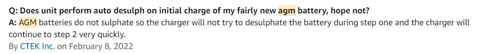

    Interesting enough on the product page for the 40-206 CTEK charger, there is a question about using the de-sulphate option with AGM batts. The CETEK rep replied back that AGM batts do not sulphate and this option wouldn't do anything.
    I'm still going to give the CTEK charger a shot over the NOCO I have now. Thx again for the info on the charger.

    This. For a starting battery, the voltage drop while cranking is my go to test. I've seen too many batteries that held a charge just fine, but couldn't handle a start.
    Sulphation is how lead acid batteries work. Without it you couldn't get power from them. If you leave any lead acid battery (wet, AGM, or gel) idle long enough, the sulphation hardens into big crystals and you have problems.
    Equalization is better for most batteries because it helps dissolve the sulphation better than a normal charge, but it doesn't work once this happens, which is why desulphation is getting more popular.
    Desulphation is not violent for a battery, though, so the person who asked that question needn't worry about it. It's just a pulse that knocks the crystals off the plates.

    I'm not sure a completely agree with that statement. From what I've read, sulphation can happen in an AGM type battery.
    https://batteryhint.com/can-you-desulfate-an-agm-battery/
    https://lifelinebatteries.com/blog/...aintain-your-agm-battery-and-keep-it-durable/
    I've also read that AGMs are susceptible to low voltage charging. They really like/need a charging voltage higher than what most of our alternators can provide. Over time charging at 14.1 or lower can limit the batteries capacity. That can be demonstrated, at least partially, by the batteries resting voltage. That was one of the reasons I asked you about what yours was.
    One of the features of the cTek charger that I really like is that it will charge at 14.7VDC in the 4th phase of the AGM charging cycle. I have found that after running this cycle, my batteries will hold a high charge for a longer period. And they seem to like it. They are as strong as ever, approaching 7 years of very demanding use.

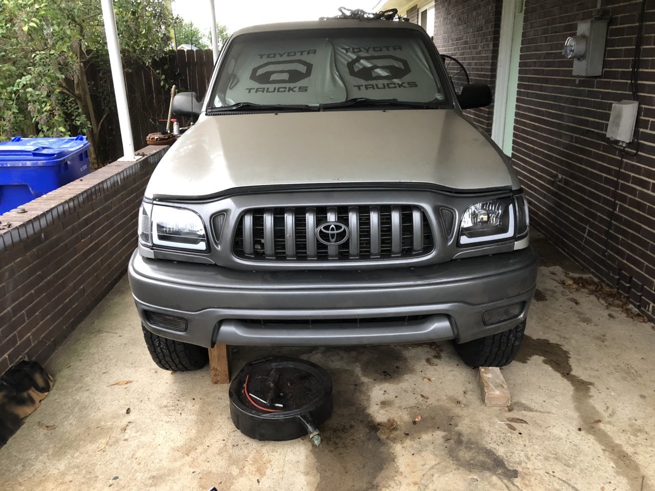

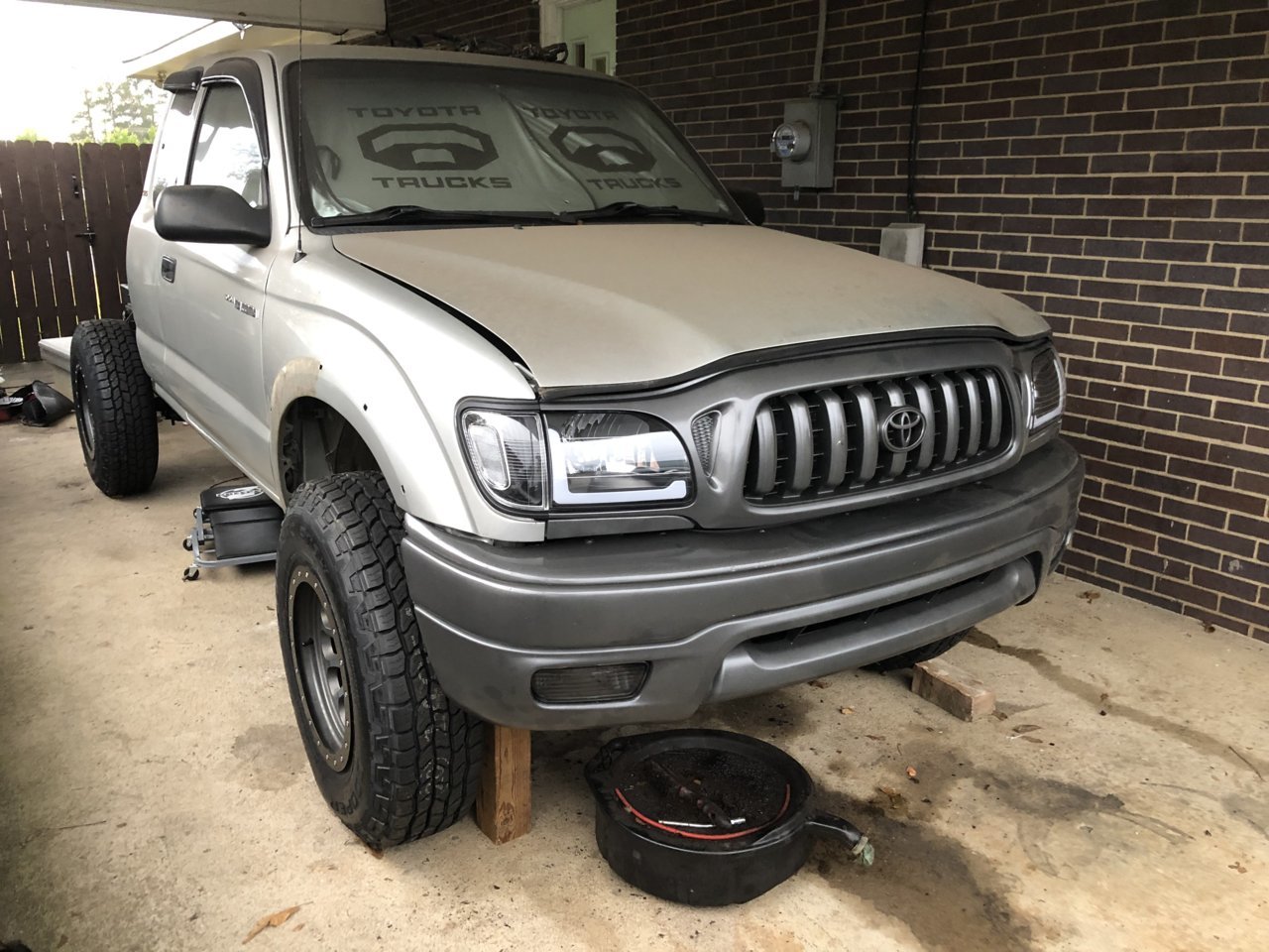

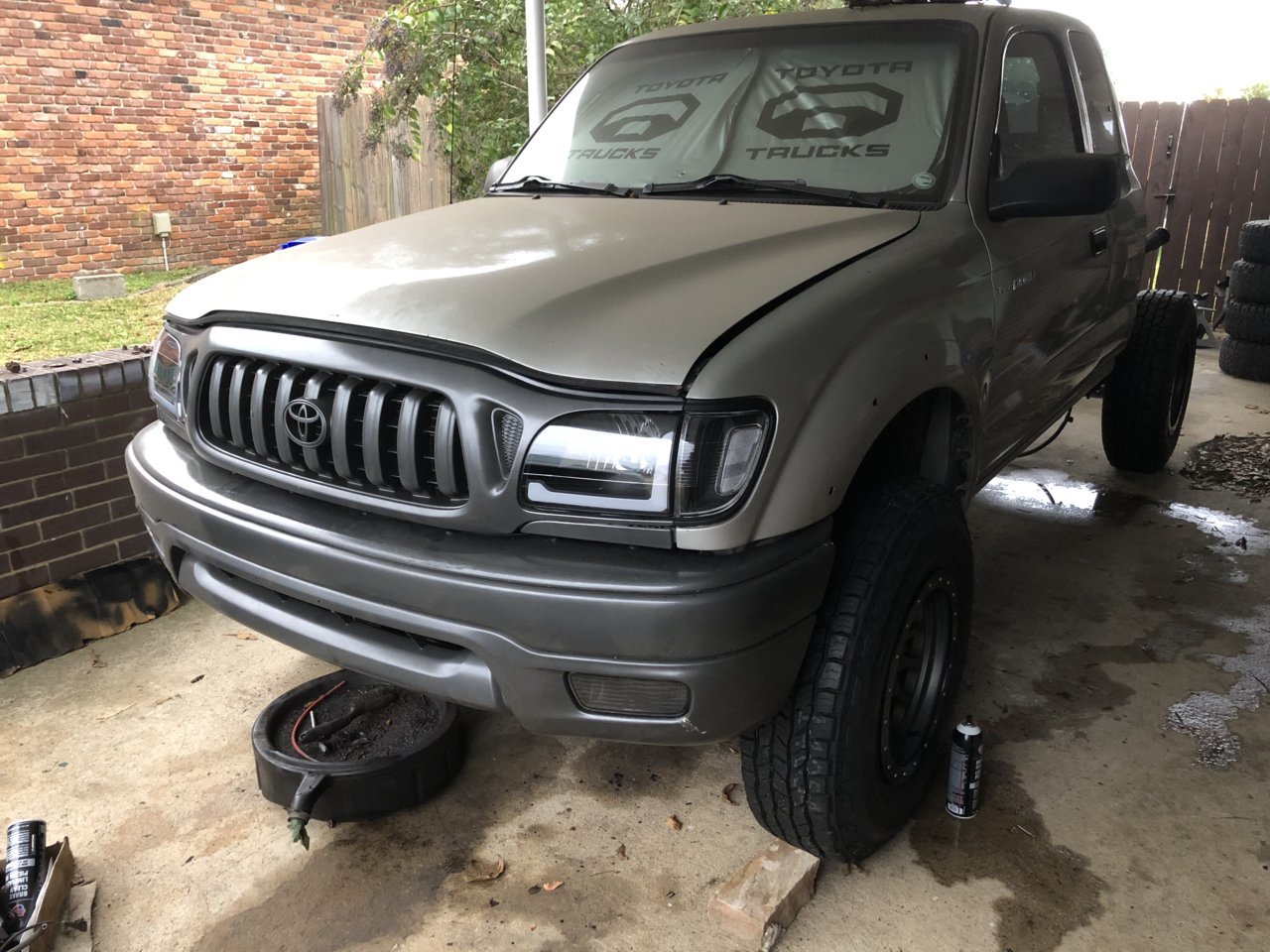

    I haven't turned them on yet. The sidemarkers and blinkers came with bulbs. I swapped my old bulbs into the new lamps. It came with a pre-wired harness where all three are hooked up on the right circuits so I don't have to do any jerry-rigged wiring to make the LEDs work. At least thats what I expect, haven't turned em on yet. We'll see when I put my fuses and such back in and crank it up. Not planning to do that till I get my new fuel filter in a few weeks.
