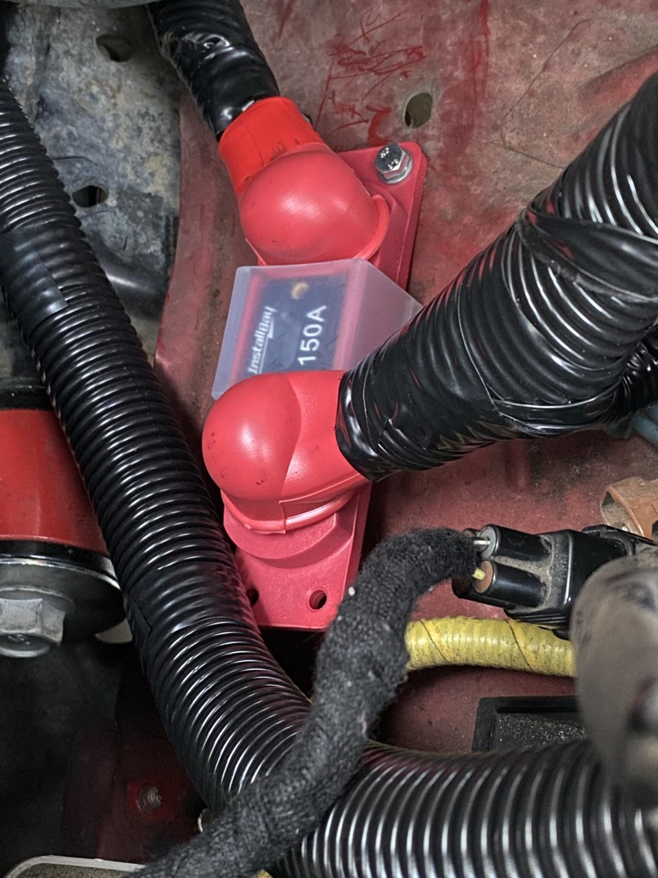

    Got back to my scary wiring. Put everything into loom and taped it up. With the wire being so fat it was hard to get more than one wire in the loom, but it is what it is. Also got caps on the fuse. Overall turned out ok.
