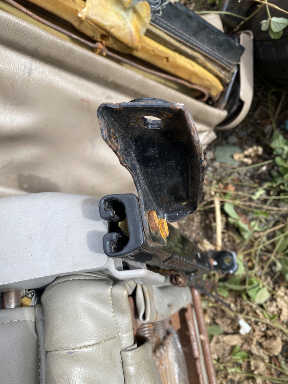

    Sooo I got some 4Runner seats for cheap. But this inner as in closer to center console rear bracket is 90 degrees the wrong way. The fuck.

    That pics the inner most rear

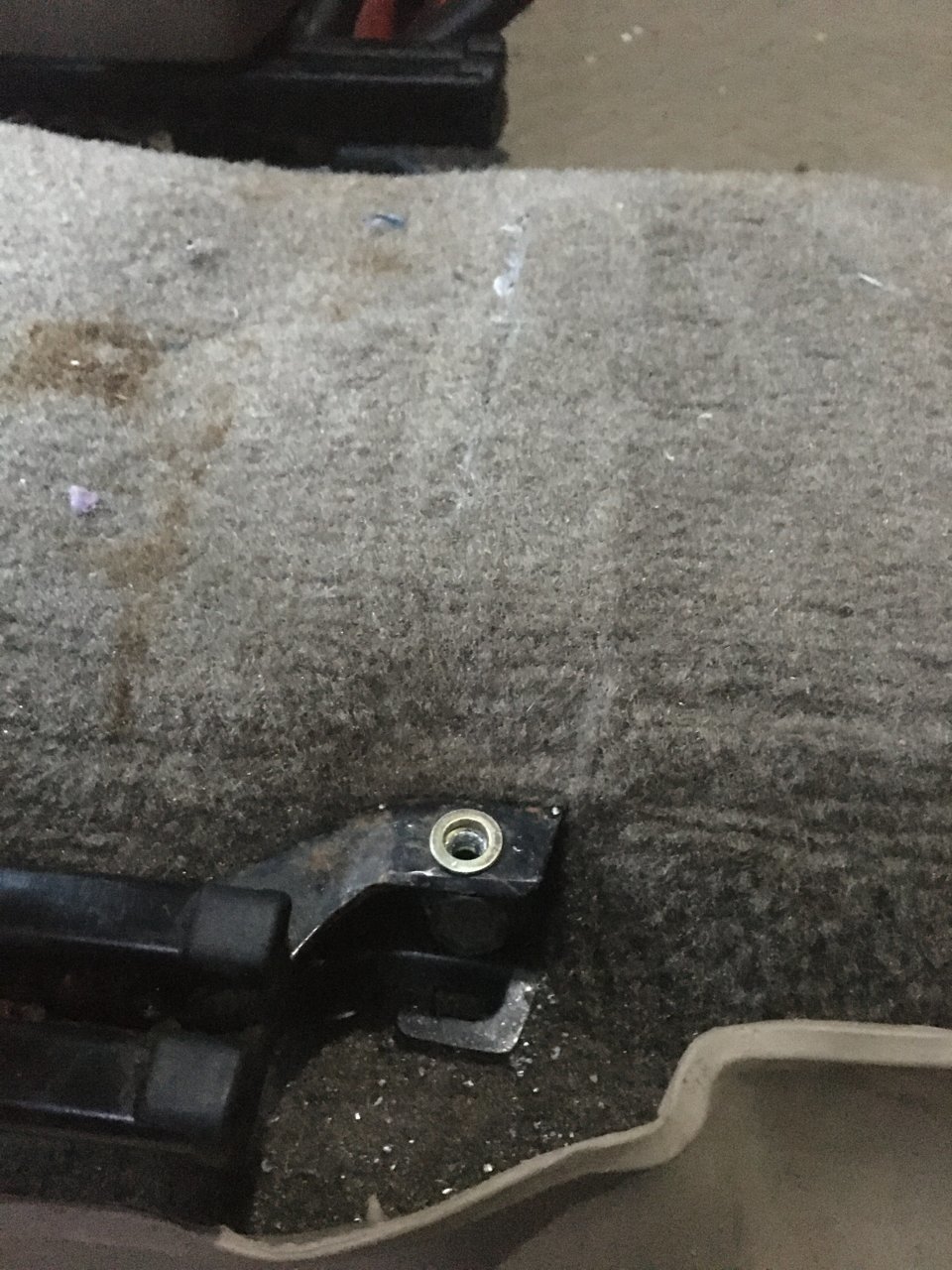

    I figured out the problem
    from that thread, I see this.
    yet in my truck I have this.

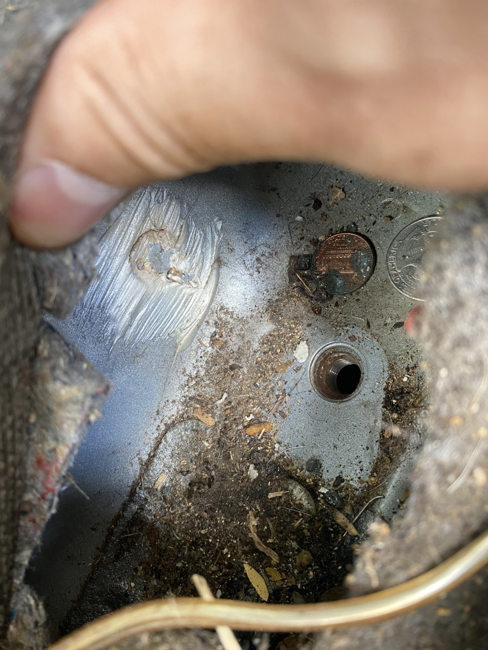

    Forgive the mess. The hole is there but blocked off it appears. I can’t imagine it’s threaded

    You could get through it and just stick a bolt through and out a nut on the other side. Whatever grade is safe of course.

    Reg cab.
    when I’m not as violently angry that the hole isn’t there I’ll consider it. I put them back on marketplace.

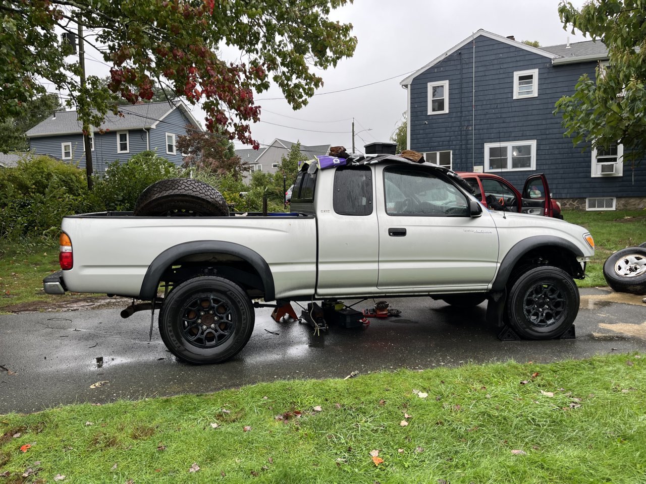

    Put the 2019 Tacoma wheels I picked up from marketplace.

    None of holes aren't "threaded" exactly since they're in sheet metal. They have nuts welded on to the underside. You can see them easily if you crawl under the truck. That last pair of holes is missing in regular cab/bench seat trucks, but it should be straightforward to drill and tack a nut on if you're sufficiently motivated.
