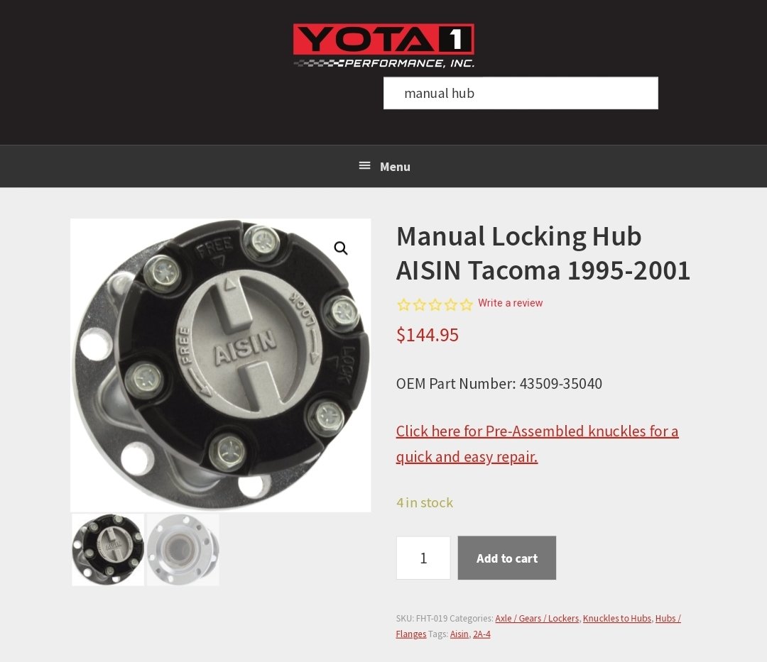

    To be fair, saving money was not on the list of reasons I converted to manual hubs..

    LMFAO... 100% agree.
    Saving money has nothing to do with the thought process of ANYTHING I do to this truck. If I wanted to save money I would give the truck away.

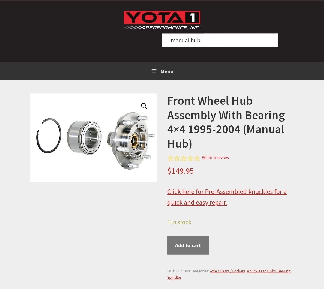

    Pretty sure there's a needle bearing in the spindle portion not the locking hub part. Kind of confusing when talking manual hubs. I typically refer to the part that bolts to the wheel with the studs in it as the hub.

    Ya, you're right... it is confusing because you're, essentially, talking about 2 "hubs" in the same place.
    The locking hub
    And the wheel hub
    And you are correct, there is a needle bearing in the wheel hub.

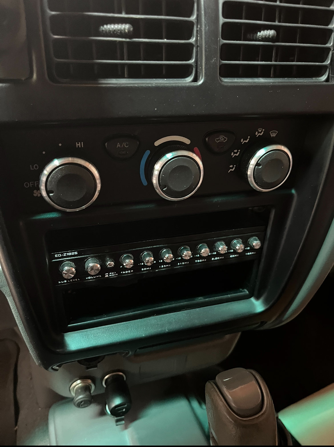

    Love this!
    Could you share your process for the conversion?
    Was it just a simple Plug-N-Play or were some mods involved?
    Pics if you have them.

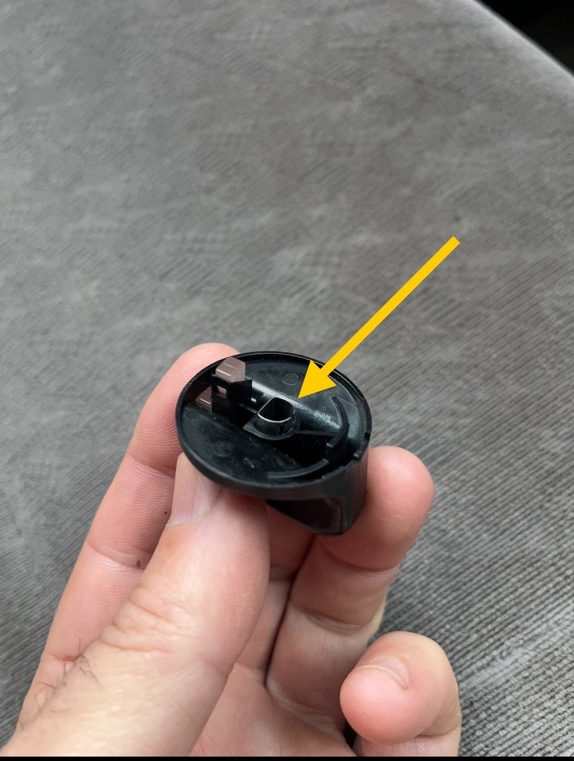

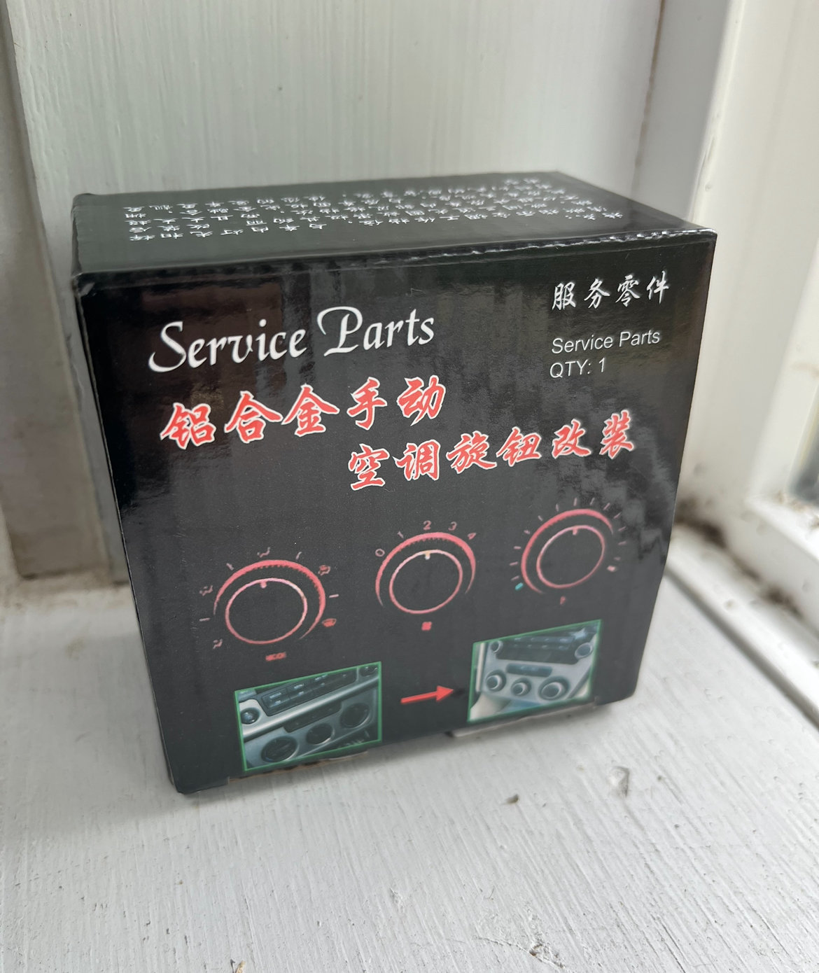

    Morning Mike,
    Its as simple as it gets, new knobs are the same diameter and height as the old ones. Its a two step process:
    Remove the old knobs by pulling them straight out, be sure to remove the metal bushing/sleeve if it doesn't come with
    line up new knobs and push into place, no sleeve needed with these
    thats it, 5-10 min all in
    After a couple days of using them I couldnt be happier, probably the most bang for the buck of my mods.

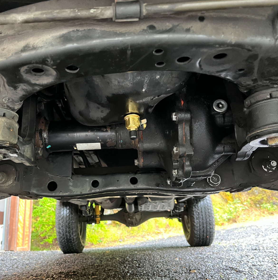

    Oil change and Fumoto valve
    pretty sure that over the lifetime of the vehicle the amount of time I save changing oil will still be vastly outweighed by all the time I spent reading about the pros, cons, and truck/oil pan destroying potential of this mod:rolleyes:
    oil pan bling for the win

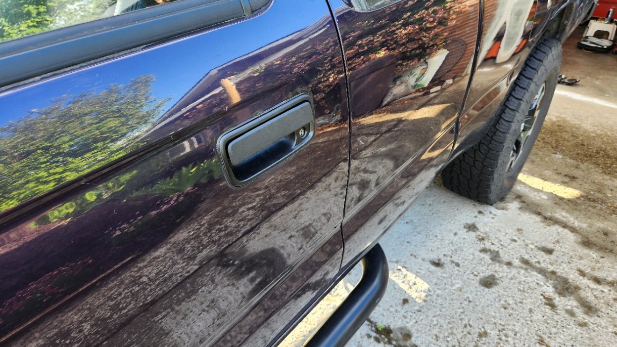

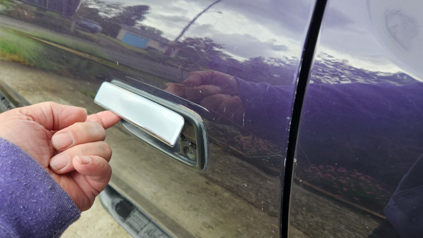

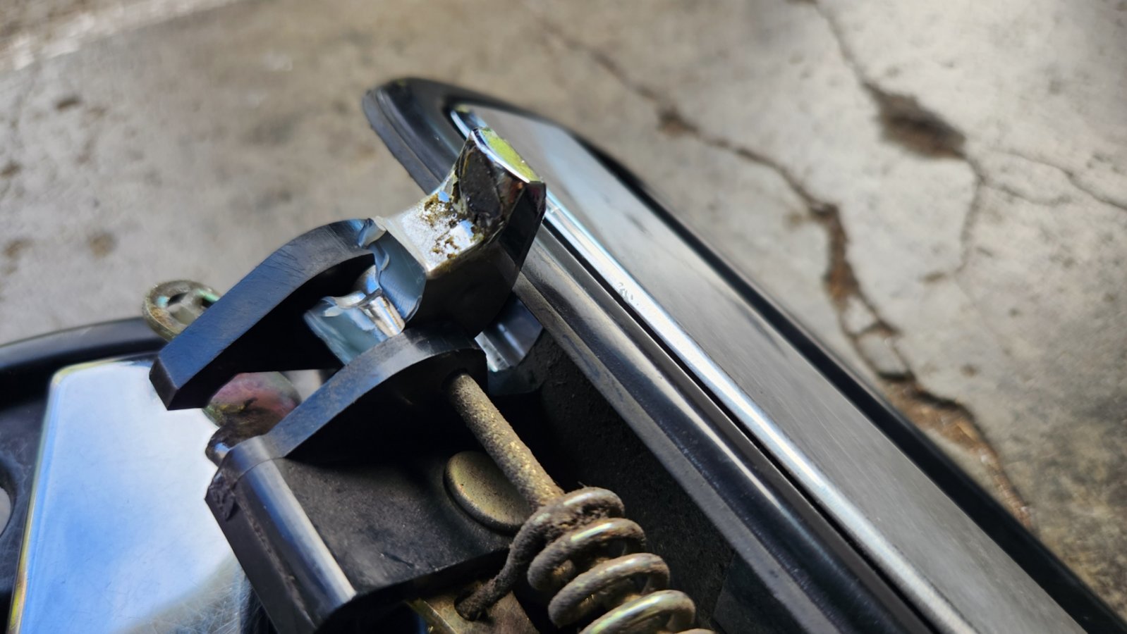

    Well, after 400K+ miles, I guess this was bound to happen.
    Went to leave to pick up my son and SNAP! door no open.
    After a couple of days waiting for new parts - and opening the door by going in the PS and opening the DS door, I installed a pair of black, metal door handles. Unclipping the door release rod was a pain and I ended up breaking the plastic clips because they were so hardened. Glad the new ones came with clips (I checked first).
