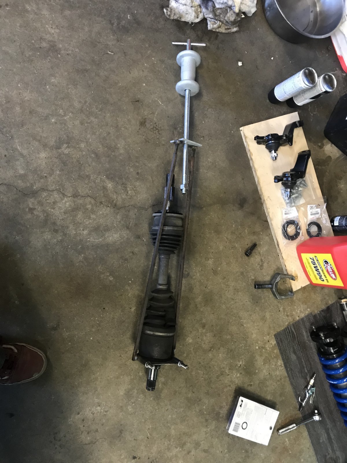

    I’ve been in a spot trying to pop out a Napa CV out of the passenger diff tube, no amount of prying, even with 2 bars on opposite sides pulling evenly and spinning the thing multiple times could get it out.
    I made a tool, same idea as the lasso, piece of winch line (maybe cam buckle straps?) is a great idea in a pinch, and easy enough to make at home IMG_1236.jpg

    Same. And never had issues with OEM CVs. Aftermarket ones can put up much more of a fight.

    my passenger diff has a cv like this in there right now. Was going to replace a pinhole in the boot but I’m just sending it.
    I did want to grab the grills tool as a back up/alternative

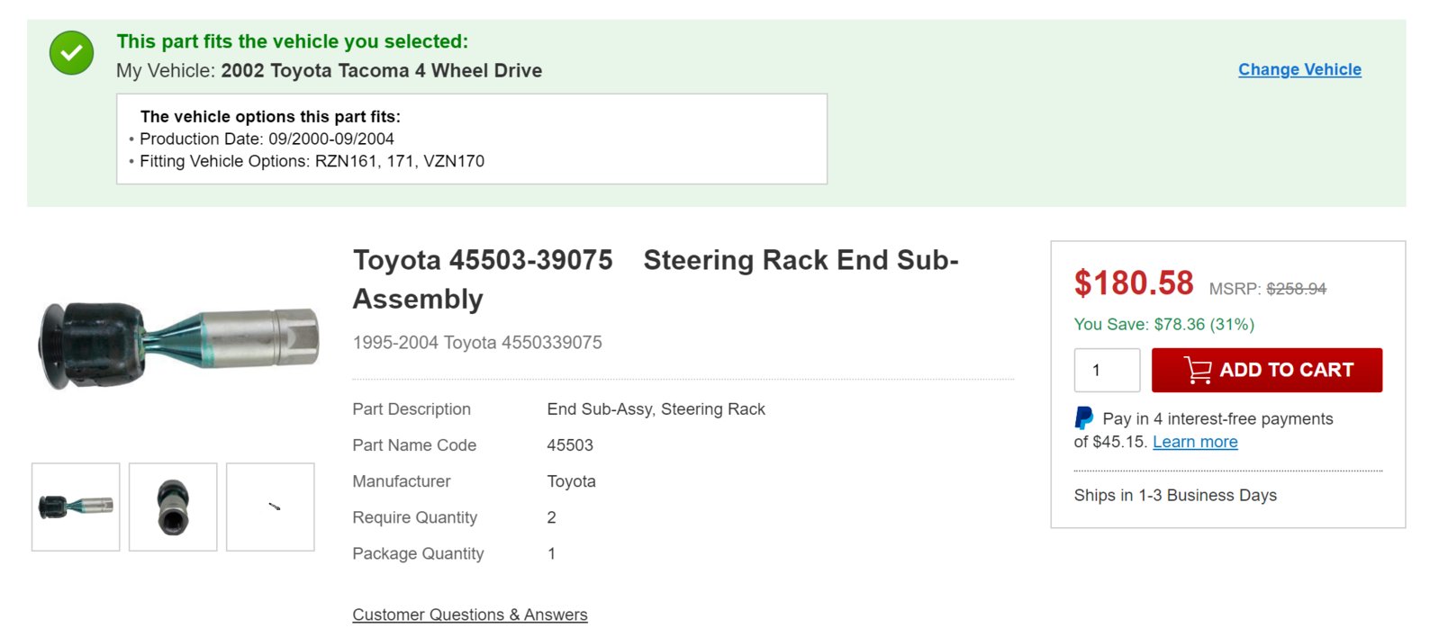

    Lame part is the rack isn't the spendy part is the damn OEM ITRE's that are. $300 of that is just the ITRE or something. Toyota wants over $100 a piece for those things.

    LMFAO... No... they want $180 a piece for them. ON SALE.
    They are regular $260 a piece.
    Speaking of... I'll have a brand new set of OE Toyota ITREs for sale, if anyone is interested. With Heim links I can't use the OE.
    I wont charge anywhere near what Toyota wants lol

    good god...
    So yeah. Wish they sold racks without those nuggets of gold on the ends of them. Jesus.
