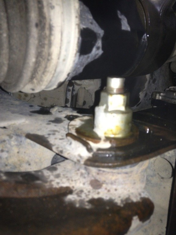

    Got back from my first long-ish(100 miles) highway trip of the year a few hours ago. When I parked I smelled burning oil. Couldn't notice anything so I went inside and had dinner. Just went back out and saw an 8" diameter pool of oil beneath the truck. Couldn't see any leak when looking down from the engine bay. Crawled underneath and it looks like it's either coming from my passenger side inner CV, right where it meets the differential, or from above that somewhere...Oil is sprayed all over the exhaust as it exits the engine compartment, and it's also on the front cross member of the frame. So it must have been leaking pretty good while I was driving. Which makes me think it's CV/differential related. I took a few pics but they are really crappy.
    19779060-DA69-41ED-8004-1AE9B10D29EC-857_52d38da45fdf3cb2c3e8c8b9241072177bd5b453.jpg
    That's looking up from the passenger side CV, closest to the diff.

    Looks like you blew the inner seal.

    hmmm. How bad is it to continue driving? I have work off tomorrow but I doubt anyone will have an opening to fix it tomorrow. If that's the case I gotta drive it for at least a few more days before getting it fixed. Oh and btw, it looks just like engine oil. I don't know if differential oil looks the same or not. I've changed the rear diff oil before but didn't notice what the new stuff looked like, only the burnt up old stuff :eek:

    try undoing your diff breather in the engine bay. Check to see if it needs replaced or cleaned. sometimes if its clogged the diff will just start pushing oil out of the seals.
    If it still leaks in a week or so..
    Gonna have to replace it :eek:
