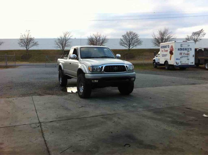

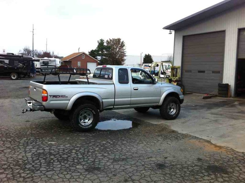

    Installed my bilstein 5100 fronts on the 2.5 setting and daystar 1.25 shackles and bilstein 5125s.

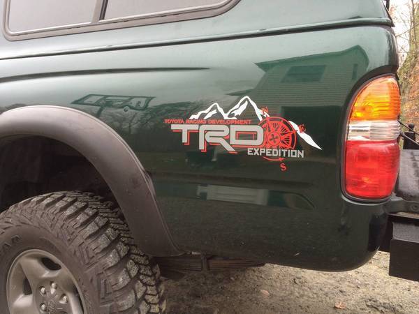

    i have seen several people with these neato trd stickers. where are you gettin these?
