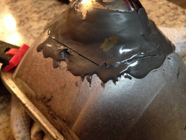

    3] Broke my HID. Discovered water in the driver's side housing, probably from when I degreased the engine a few days ago and hosed it off. Apparently I didn't get it sealed well enough. So I pulled the front end apart, pulled the housing, baked it in the oven to soften the glue, and pulled it apart. After cleaning the water out, I baked it again and pressed the housing cover on. I thought it might be better to have an even pressure, so I put it face down on the counter and pushed down on the back of the housing. Well, the projector lens is so close to the housing cover that...it broke the JB Weld on the back.
    Fuuuuuu..... :mad:
    Either I'm stronger than I knew, or the JB Weld wasn't as strong as I thought.
    So...hopefully some Gorilla super glue and calking will fix and seal it up good enough. I really don't want to toss it and have to buy new ones and venture back into Dremel land. Grrrrr...

    Hopefully the gorilla glue will work this time around, I wouldn't have gone with job weld to start with but I'm surprised it failed that easy

    Well, it wasn't a standard retrofit. I had to Dremel out the back of the housing so the projector lens assembly would fit. Then to hold it in place, I used metal tape, then JB Welded over the top of all of it to make it...permanent. Right.
    <crossing fingers>

    I know most everyone bashes JB weld , it works 1 of 2 ways, it either bonds the surfaces like steel or it is a forever fail, cleaning the surfaces is key to that shits success it seems, used it a couple times with good results
