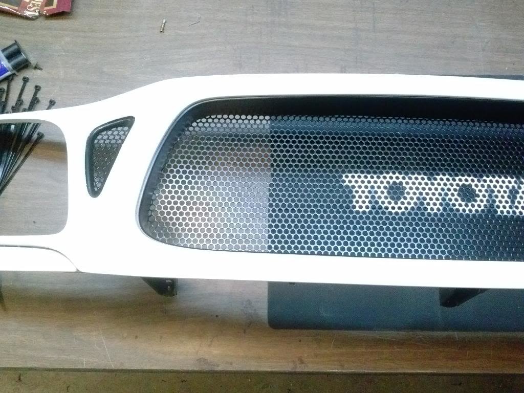

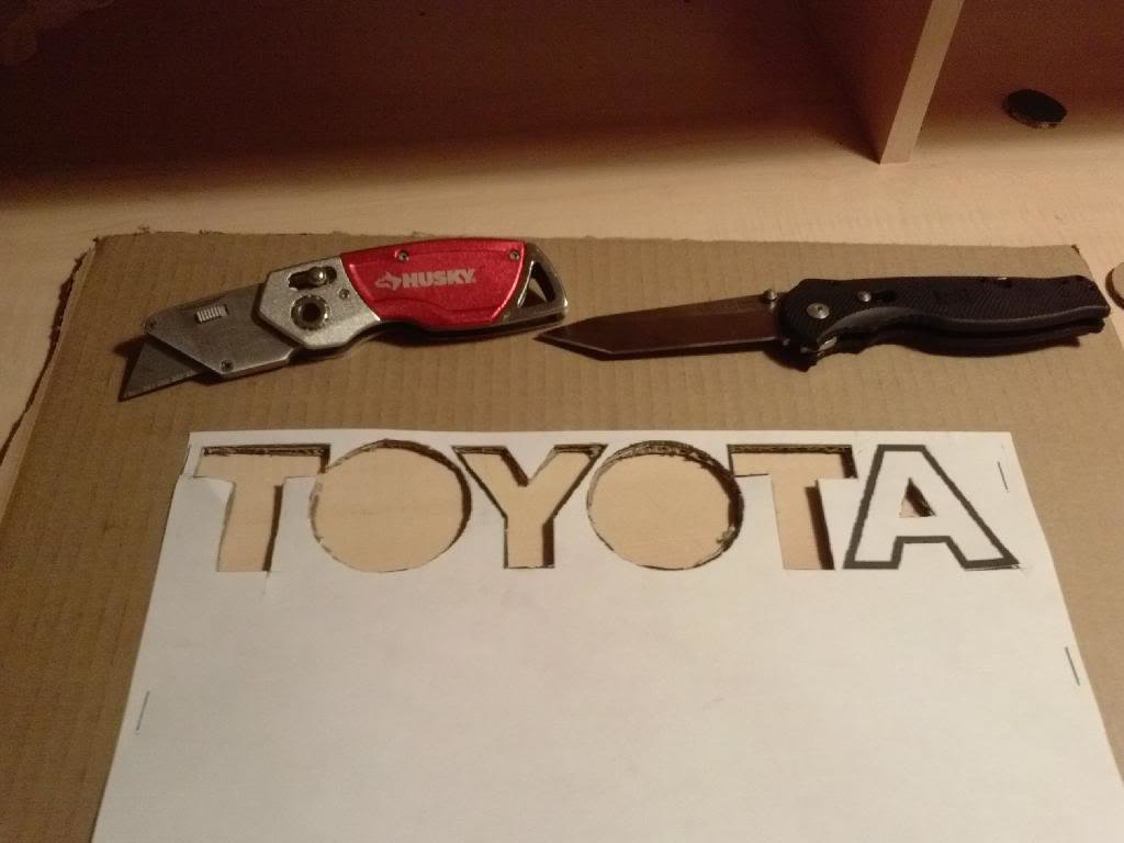

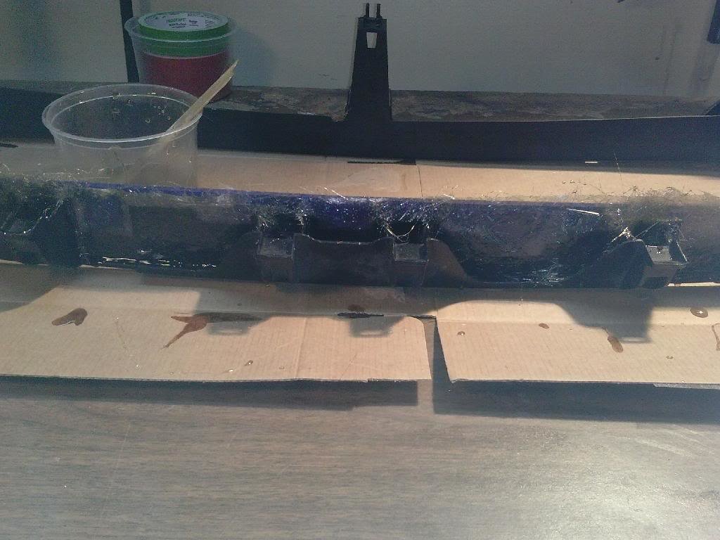

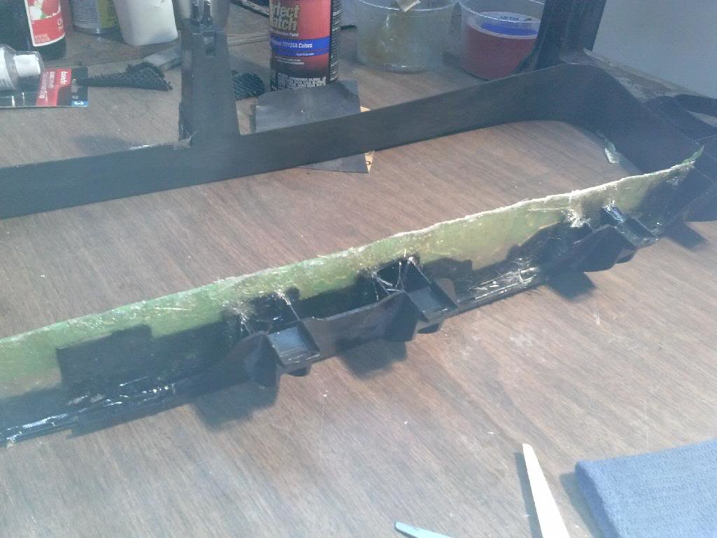

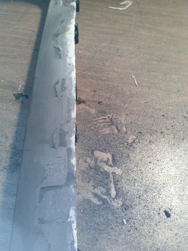

    Well i Got my M1 Mesh from HomerTaco Last week and decided I should get to it.. So i spent a few days in the garage after work doing the satoshi Grill..

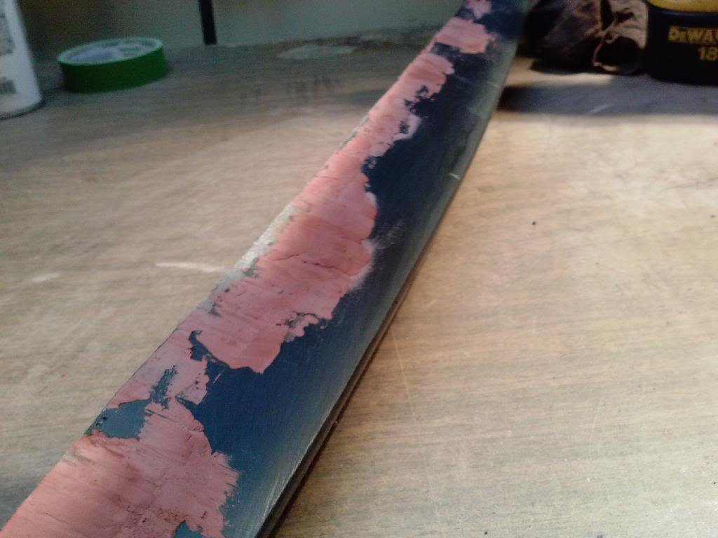

    I had a chrome grill originaly which had been plastidiped, so all that had to come off as well, so i could do a color match. I seperated the inner piece of the grill with a heat gun, which made the painting of the grill easier and the fabrication process easier to do as well..

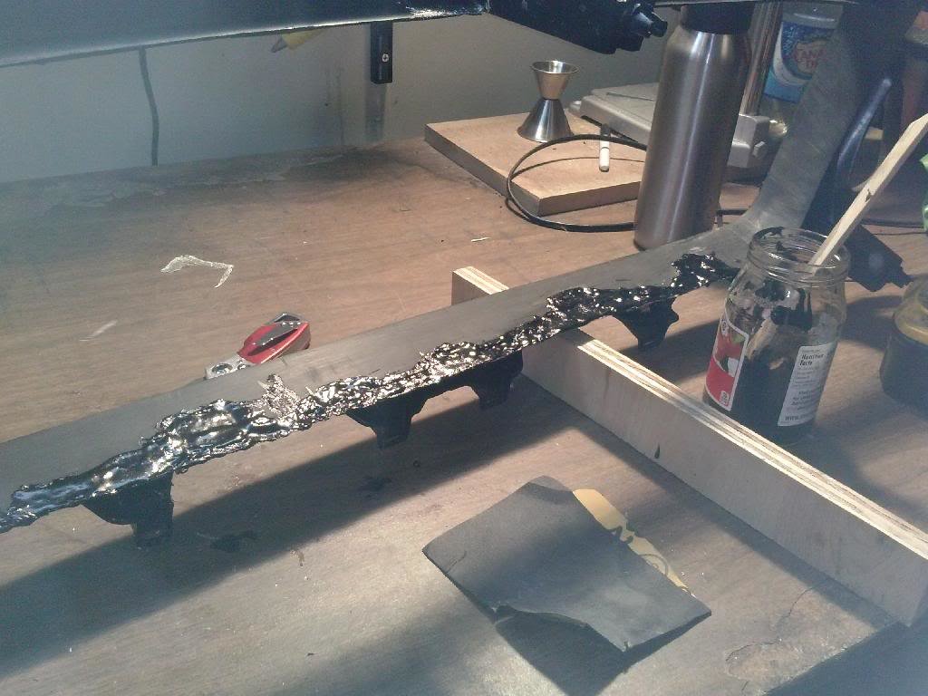

    The gaps on the top of the insert were fiberglassed and trimmed, then filled with home made ABS filler which I made from the ABS dust i accumulated during sanding and small pieces from cutting. The ABS was tossed into a mixture of Acetone and MEK. Once it dissolves it pretty much turns into the best Plastic Glue/filler material. It just turns right back into part of the Insert... I did use glazing putty to fill in small inperfections.
    so heres a bunch of Pics...
    Fiberglassing:
    Homemade ABS cement:

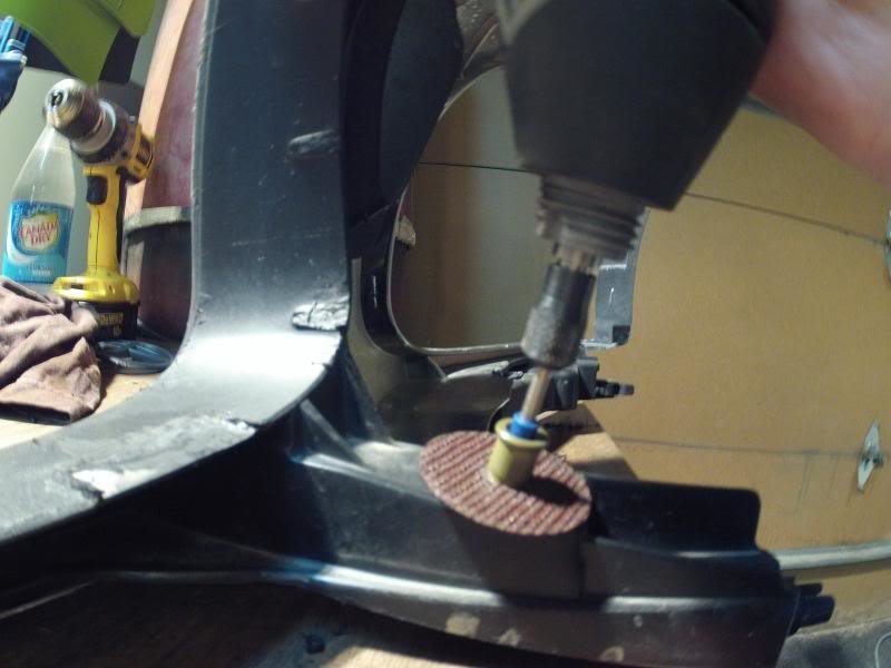

    Sanding Down Filler
    after glazing putty..

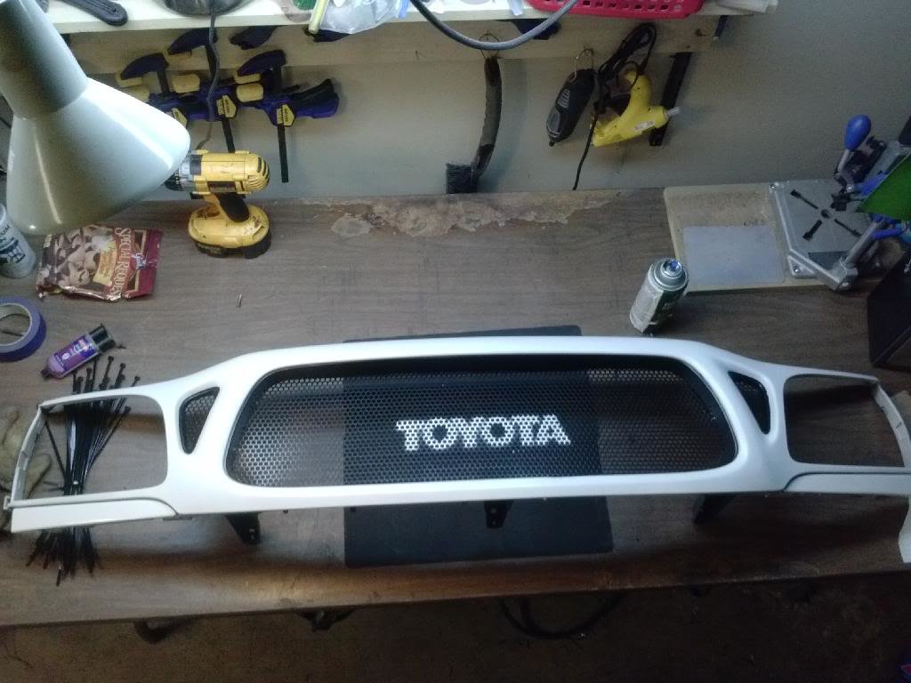

    hi-temp rad paint:
    So yeah you get it.....

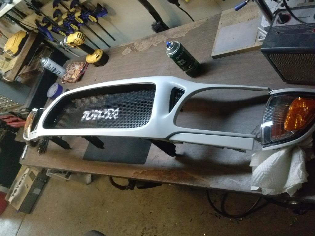

    Final product:
    So yeah, stll needs some touchup sanding and final clear coat.. Hope to find me a mid 80s FJ-60 Toyota emblem to stick up front.. for now.. spray on..
    Hope to have it back on next week, my truck looks a bit faceless right now...\

    Looks GREAT!!!!!!!!!!!!!!! I got Grill Envy.....

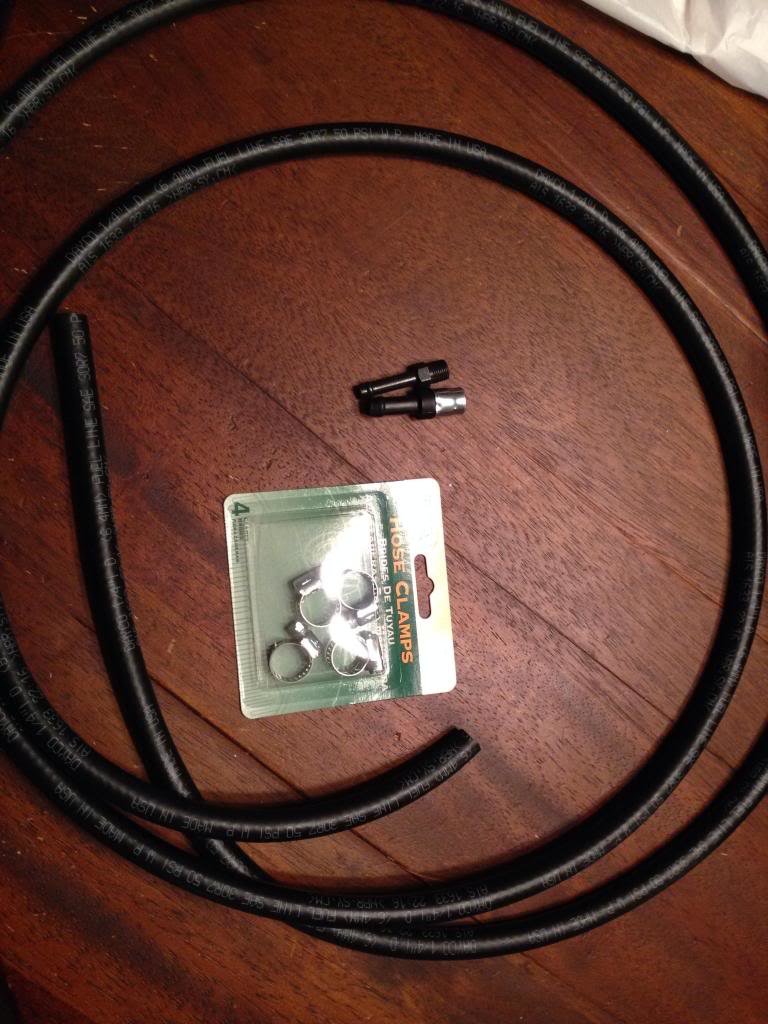

    Dif breather relocation today :turtleride:

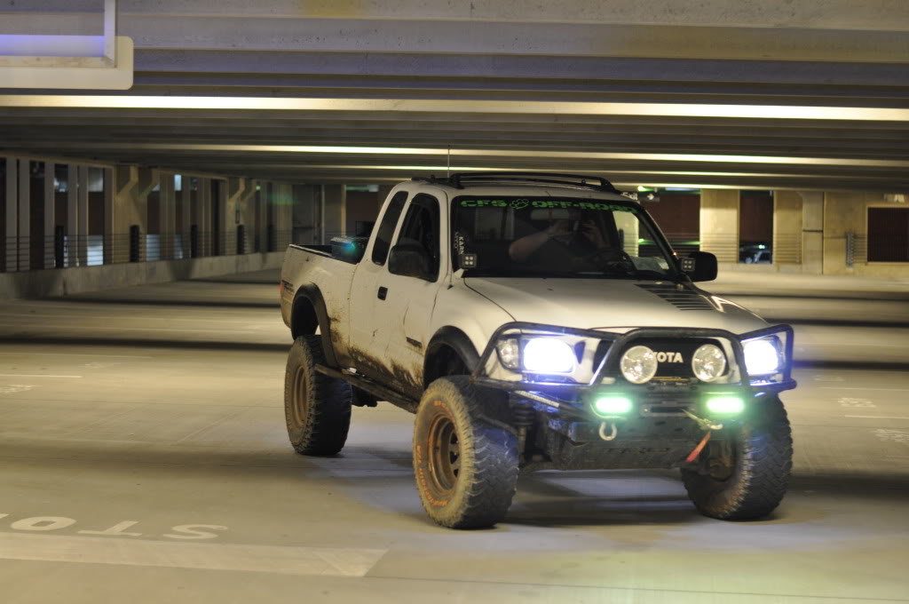

    Had a great day wheeling with a local club
    60fbab78-dd5b-4a53-b440-8316363bb935_zps_ccc8435e98d840d3a4241dd8e7b71d35cb439d5d.jpg
    More pics in my build if anyone's interested :D
