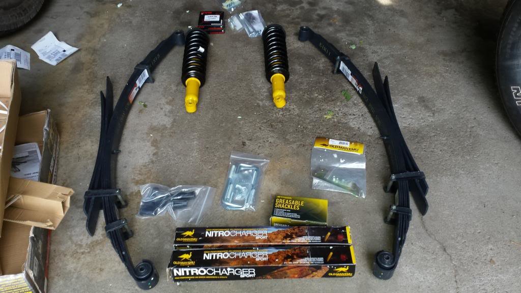

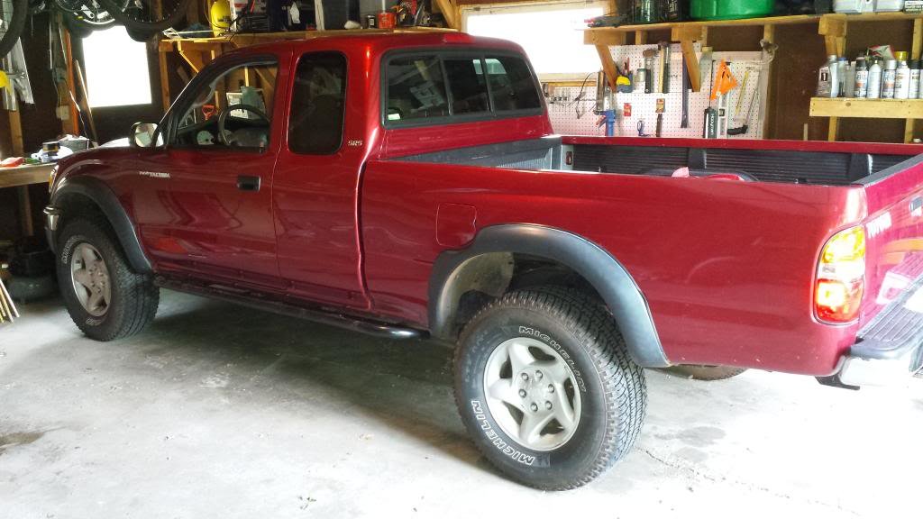

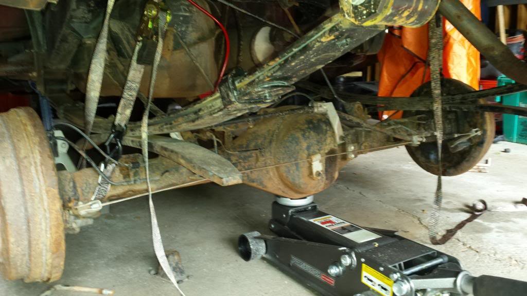

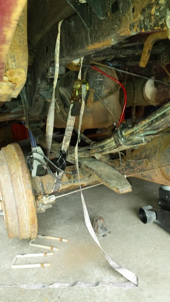

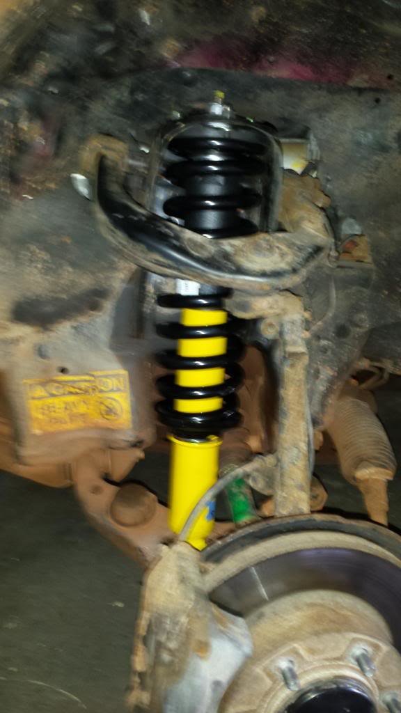

    Okay, these are the pics I have right now. Sorry for the iPotato pic quality:
    Before:
    Lift Kit:
    Front end installed:
    Rearend being taken apart. I don't have any pics of the Dakars yet. I did steal someone elses idea of using ratchet straps to hold and locate the axle during leaf install. Made swapping out leafs a breeze.
