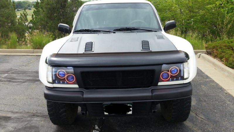

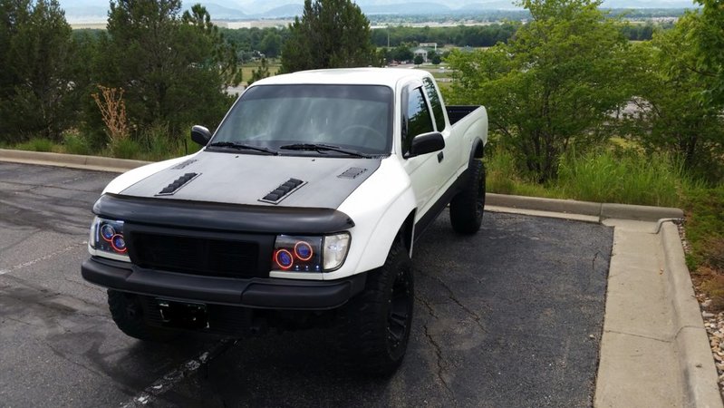

    That hood is sick man. You got more pics on here somewhere?
