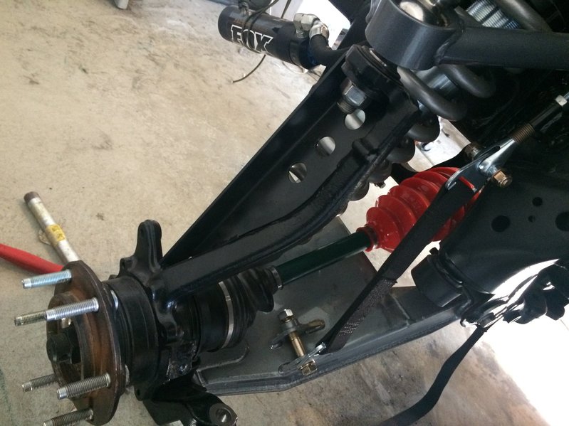

    First White 1st gen I've seen color-matched. Looks awesome!

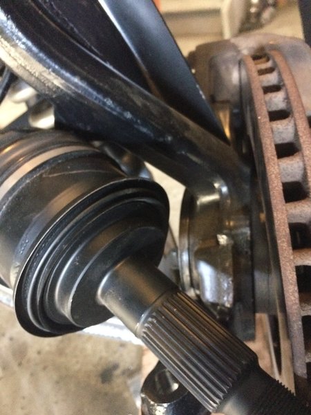

    Definitely add a small amount of grease to the splines to help install. Any lithium grease should be fine.

    I did add a thin layer of grease. Thanks for the help guys.

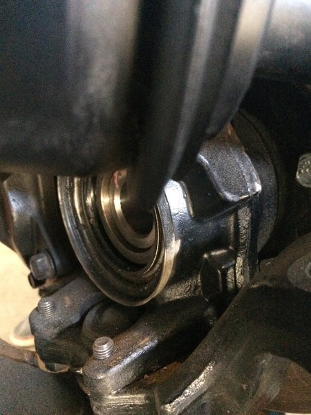

    Never add grease to that it very little if you do. Unlessyou want grease mixing with your diff oil which is not a good thing .

    Use some clean diff fluid on the splines.

    This prerunner now has a front drive train. :dancingbacon:
    Don't mind the limit strap location, missing cotter pin and dust cap.

    No one seemed to notice your pics are of the HUB SIDE. You did good and you want a film of grease to fight corrosion in there. It's far from a waterproof area. More important is a light smear of grease on the TWO seals, one on the shaft end and the other on the hub. These "seals" have no other source of lube and will become worthless in just a few K miles if left dry without that smear of grease. Same thing applies to the rear axle outer seals.

    Yeah I lightly coated those two seals that cup that inner section. I also lightly coated the bearing surface and spines of the cv. I also greased the seals on the diff side too.
