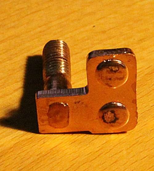

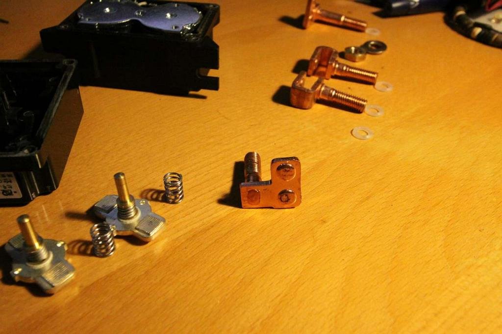

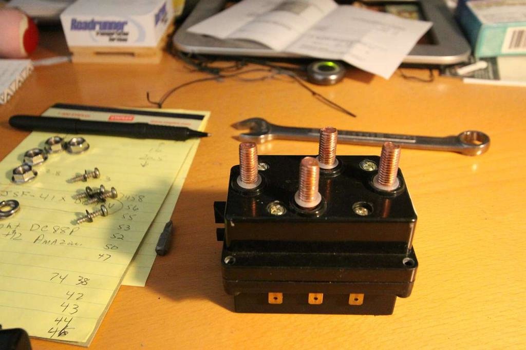

    It may click but could be corroded internally on the contacts. I found this, might help with trouble shooting. The solenoid should show voltage on one leg only until activated then both legs should have the same voltage.
    https://www.tacomaworld.com/threads/sealing-your-smittybilt-xrc8-solenoid-before-it-fails.188351/

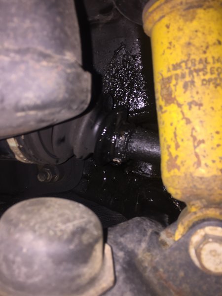

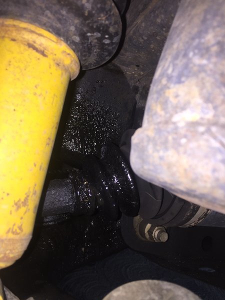

    Axles cant be rebooted?

    yes they can.
    for about 25 bucks.

    yes, I know that. I did both mine. I was just asking how come he didn't consider rebooting his.

    The passenger has been torn for months, driver is more recent. I've been wheeling in dirt, mud, sand, rain & snow since. Surely it's dirty up in there. Plus they're 13 years old.
    It is what it is at this point, it's a super easy job to drop out the old ones and throw new ones in without buying tools I'll use once and getting grease everywhere. Looks like I could've saved a bunch of money that way though :oops:

    Mine (H20 10K) started clicking instead of engaging. Took the contractor apart and cleaned up the contacts. Good as new.
    Deathbysnusnu[QUOTED] likes this.

    Reboot them anyways...spares! Clean them really good

    Definately reboot.
    My last Tacoma went 275k with empty joints. They are quite durable.
    I always figured I would replace them when the joint broke. They never broke. The frame did first. 309k total, I was pleased.
    They clicked a bit when sharp turning.
