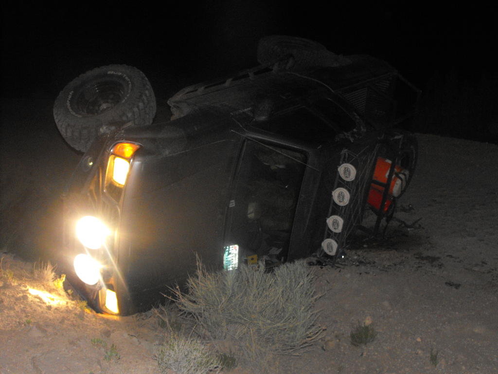

    The roof rack alone was enough.

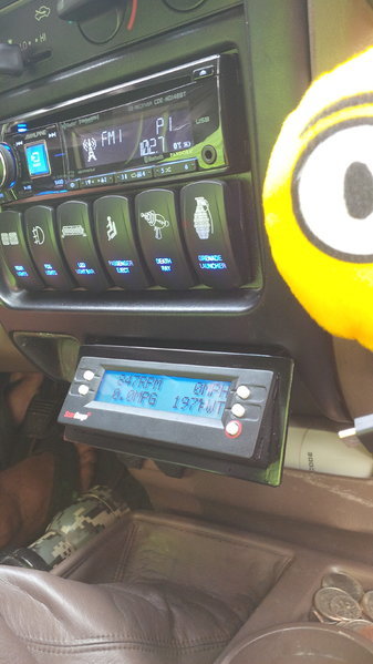

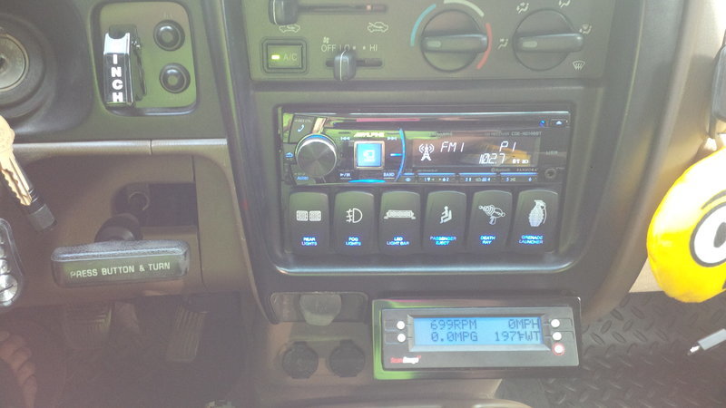

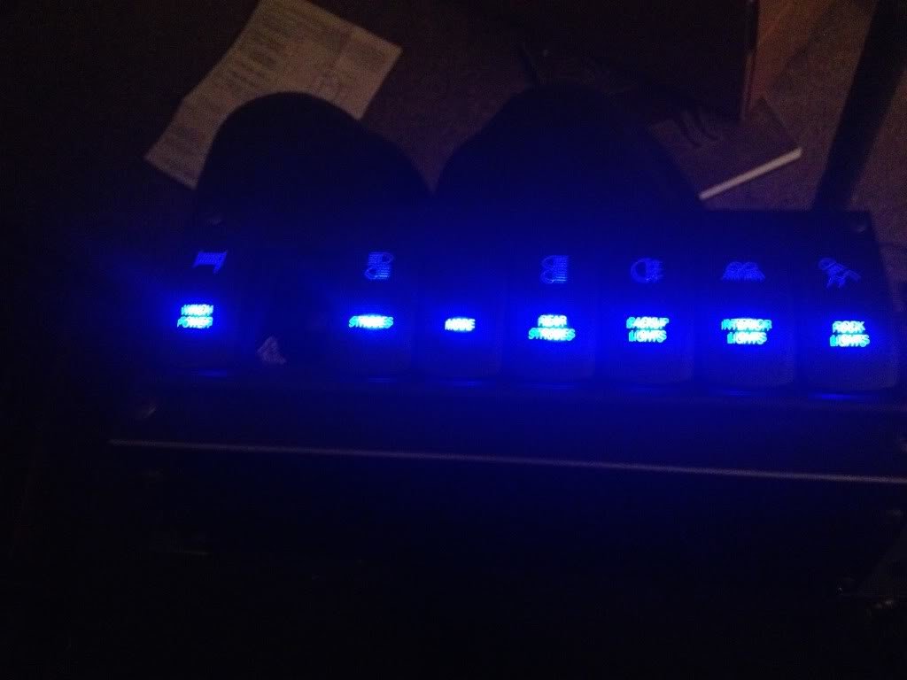

    Does the blue in the switches look so light because it's a day time photo? I'm looking at the OTRATTW switches too and want a blue more like this:

    Yup they are pretty bright at night....the sun was directly behind me as I took that pic, but the pic above is just a shitty photo/out of focus which makes it look like you can see your switches from space :rofl:The OTRATTW switches are awesome
