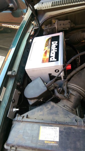

    IMAG3020.jpgSecond battery! Work in progress..

    Why not put it upright ?

    was thinking the same...

    It's a pretty tight fit. I don't think it would clear the hood (might as well check though..). The battery is about 6 inches wide or so, and 8 inches tall with the terminals on top. All the other 1st get dual battery installs on the passenger side like this use sealed batteries laying on their side.
    Edit: I should clarify this is a sealed battery. The Die Hard Advanced Gold batteries from Sears are relabeled Deka Intimidators.

    I have mine there upright but I don't have a core support lol

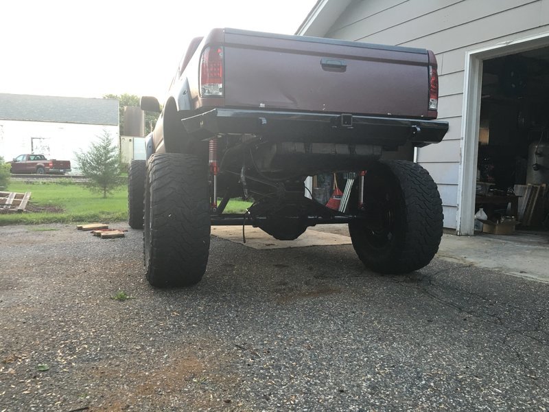

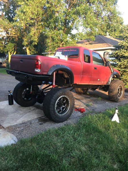

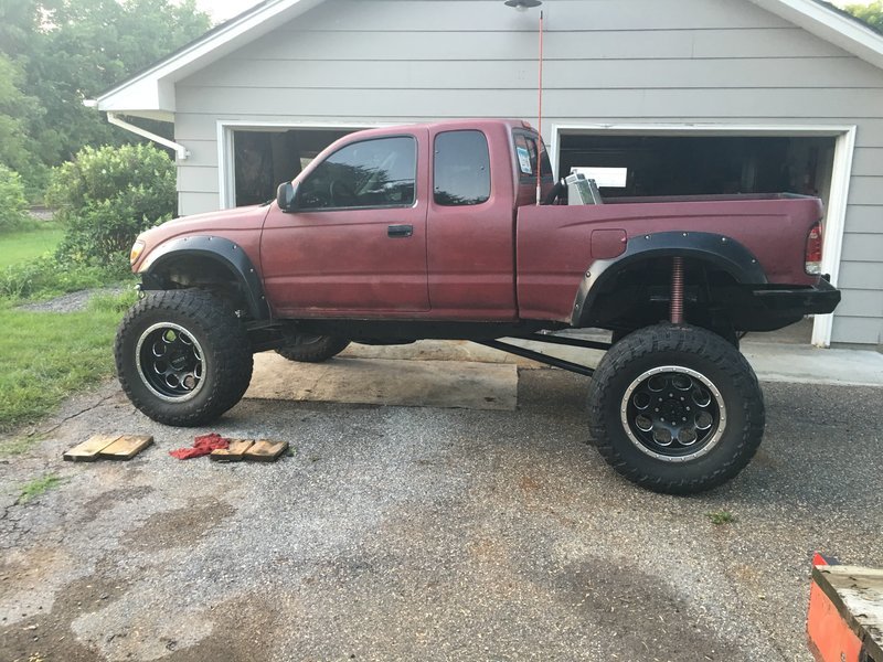

    Got my rear 4 link done and struts on. Sitting a little high right now, but ride height is infinitely adjustable.

    Siiiiiiiiiiiick :)
    Digging the rear bumper. Can't wait to see the front

    I have a yellow top there upright.

    How close is your yellowtop to the hood?

    Damn close. Had to get a terminal that had no vertical bolts

    And I'm guessing your 35 taps the fender right under the battery? Lol

    Which battery..
    But no. Don't think so.

    Passenger side
    Ahh I need to move mine over or something but I think the tire would hit it

    @anthony250f @Blackdawg Your second battery installs look good. I wish I would have seen them before I started the whole process. How are they holding up?

    Just relocated it to the passenger side? What did you use to secure it to the fender? Fender washers and screws? Anything unique?

    Great. No issues
    I welded in legs and bolted in a battery tray.
