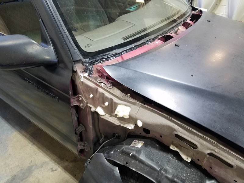

    Had a ton of road/wind noise at highway speeds. Got tired of it so I did this. Crossing fingers that this fixes it. Sealed bottom of windshield. Filled entire frame area with expandable foam and sealed antenna wire20160822_192222.jpg

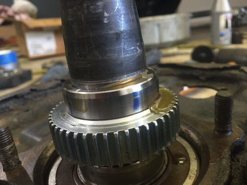

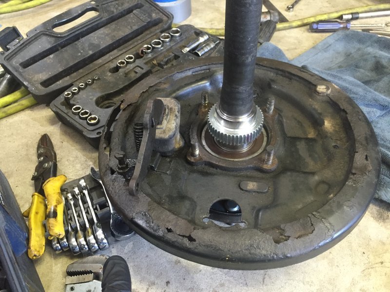

    Wrapped up the axle seal/wheel bearing project today. The machine shop charged me $90 to take the old stuff off and put the new stuff on. So the job in total cost me $90 for that, $120 from LROR for the kit, and $20 for a new set of shoes since the old ones were soaked in diff fluid. Def not bad but could save even more if I get a press and make myself a jig from an old yota axle.
    Used the marker method to make sure the seal was riding on the collar properly.

    I need to do this...bad
    Also I have that abs ring but... the truck has no abs. So could it be left off when I do the bearing? Or does it even need to be taken off?

    The ABS ring serves as a spacer between the bearing lock collar and the ring that the seal rides on. So unfortunately it needs to be there. Otherwise you will press the ring the seal rides on too far forward and the seal will not seal against anything.
    If you have an ABS ring, that means your rear axle housing was machined for ABS and thus your seal sits further inside the axle housing than an axle housing without ABS. Thus, the need for the ABS ring to serve as a spacer. I don't have ABS but still had the ABS ring on my rear axles.

    I recently did real axle seals and bearing and left the ABS tone rings off. No issues and it has been several thousand miles.
    The seal rides on the retainer ring, which can pressed on to any point.

    It wasn't just the alternator, the radiators all got filled up with crap too.
    I suspect that mud pool had not been disturbed for a while before we went through it. I'm guessing the heavy stuff had settled out quite a bit. When I went through, it had been stirred up pretty good for me. It was pretty obvious from the results that it was not the same for you guys.
    This is the best explanation I have heard on here.
    I too recently did rear axle bearings and seals. I did not do it my self, instead opted to have Toyota do it. I was told the exact same thing by the Toyota tech who did the work. Even though my truck does not have ABS, the tone ring has to be there.

    I was under this impression as well. You will still need two retainer rings, one for the bearing and one for the seal, but like Brett said you shouldn't need the tone ring. That tone ring isn't a spacer by any means because it doesn't butt up to the second retainer ring/c-clip. There is a couple millimeters gap between them. The only thing that matters is the location of the two retainer rings.

    Without ABS there is no need for the tone ring, it is a waste of time and money.
