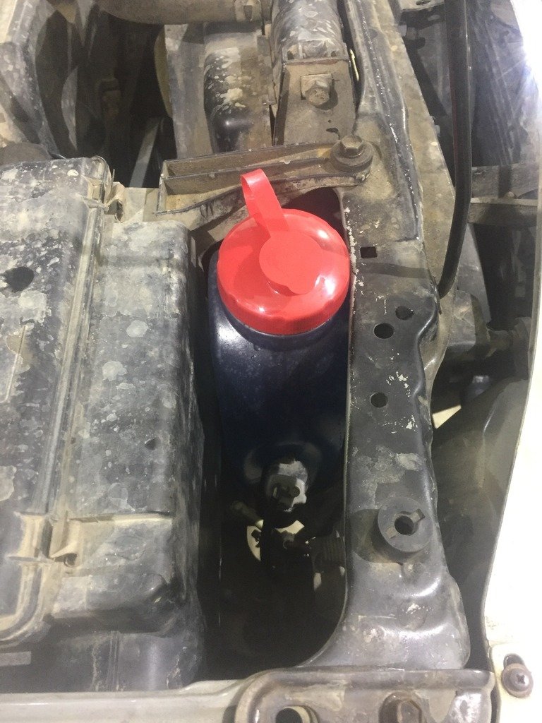

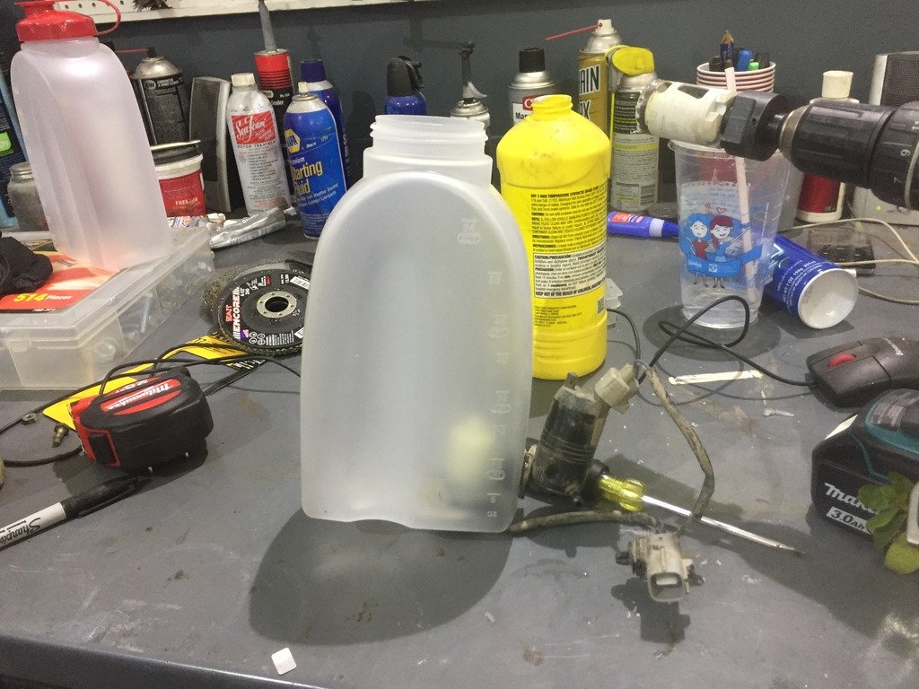

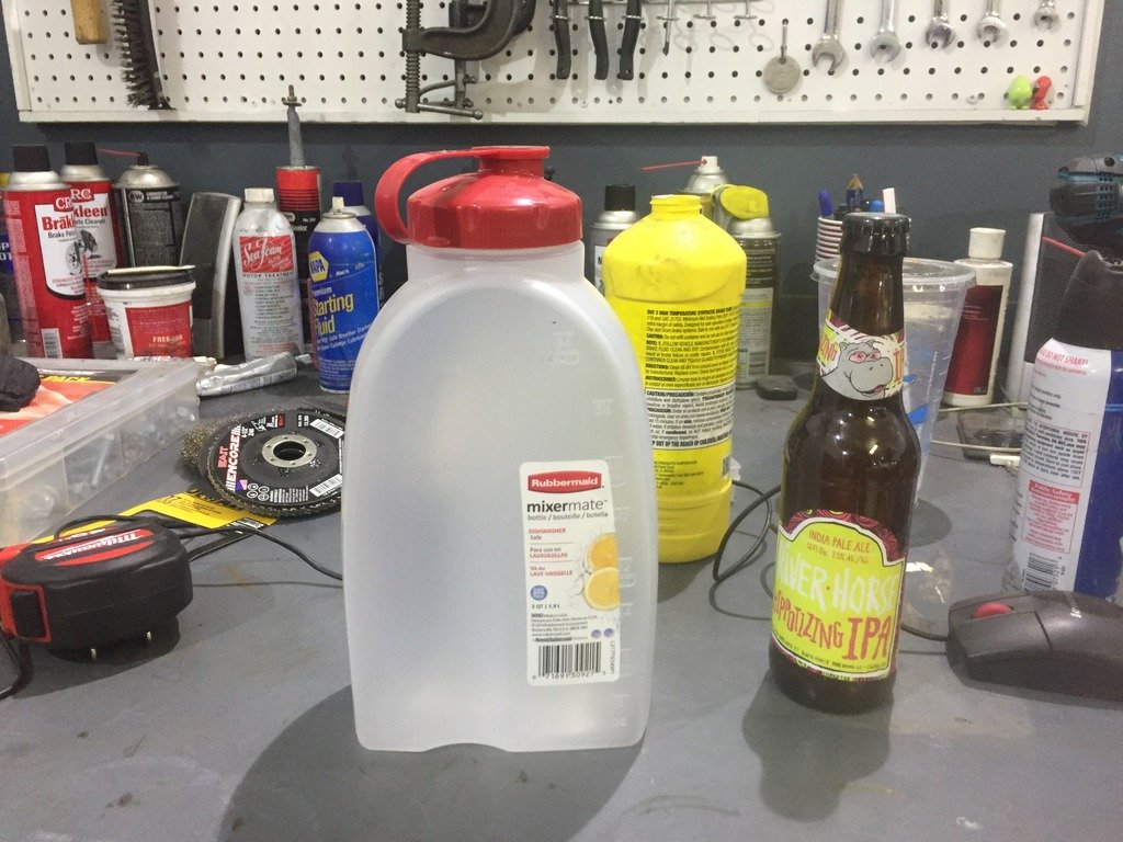

    Fawk yes! I used a Nalgene water bottle, but removed it shortly after because of a bad seal. I'm rolling around without a reservoir like Monte :anonymous:

    Bad seal using the old grommets or did you seal it with like a plastic glue or something of that sort? I put waterproof grease on the rubber to liven them up a bit. Gonna keep an eye on it and see how it holds up.

    My issues was that the pump was unsupported leading into the bottle. Once the glue setup it wasn't enough to keep the pump from moving around and breaking the seal.

    That was a fear I had, so when I put the zip tie on I wrapped it around the pump to hold it against the bottle. But I think the rubber grommets let me have a little more flexibility too. Any reason you didn't re-use the rubber from the original res? Seems like most people don't for some reason.
    EDIT: Just saw you used a zip tie too :anonymous:

    Yeah, I zip tied as well. I didn't use the grommets because the reservoir got tossed before I could get it from the shop I left it at. I did a pretty poor job on it initially. It's one of those mods on my list that I need go back back to... Pretty far down on the list now :oops:
