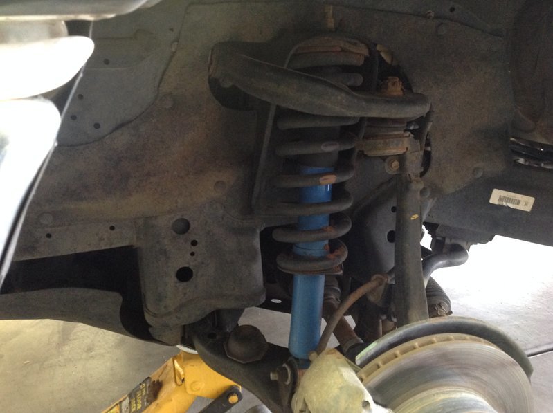

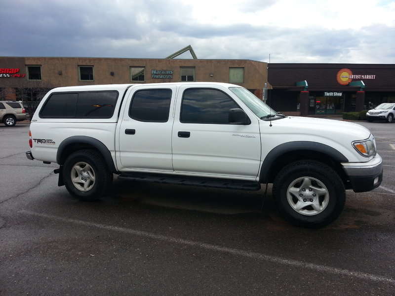

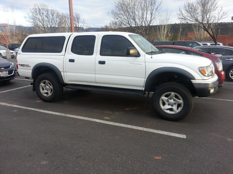

    OME 3", diff drop, exhaust relocation, and alignment. Shoes will be next on the list but the 265's don't look too bad.
