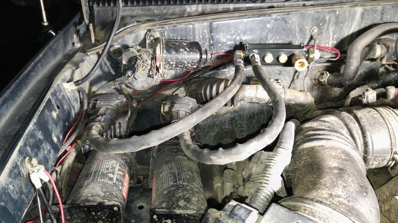

    Decided to do some truck stuff however minor it may be. After putting the winch solenoid in the OBA manifold was in the way so I relocated it to the firewall. That's about all I did but it took time to get it all figured out. I'll be remaking some of the wiring harnesses soon to clean everything up since that is an activity I can do indoors.
    To this...

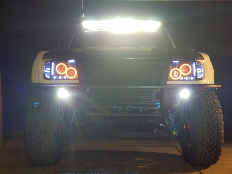

    Any suggestions from anybody with turbo knowledge on here...... I put on a new intercooler that is way smaller than my other one. 7" now vs. 12" tall. Now my afr dropped from 11.2 in boost to 9.8 which is dangerous. I adjusted my ebc duty cycle upwards and brought the afr to 10.5 and I'll tune the ebc some more after work. So why is putting a smaller intercooler making such a huge difference in afr? Am I getting more lean due to hotter intake temps? Any suggestions on remedies? I can fine tune my ebc to get it where it needs to be by adjusting my duty cycle, gain, and or spring pressure. Mainly super curious why this happened from reducing 5" off the IC.

    You're going more rich, not more lean, so increased intake temps doesn't really make sense. It looks like you're getting it back to where it needs to be, if you can tune it back to where you want it then there's no problem. I'm not sure why that would happen either.

    how's your pressure now? Changing the IC can do a few things. If it's not a high quality product the boost drop can be as high as 3psi. Did the thickness change? The IC could be restricting air flow more then the larger one now as well.
