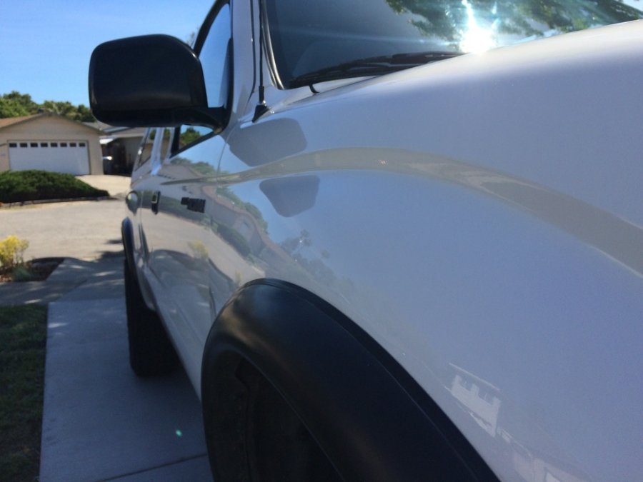

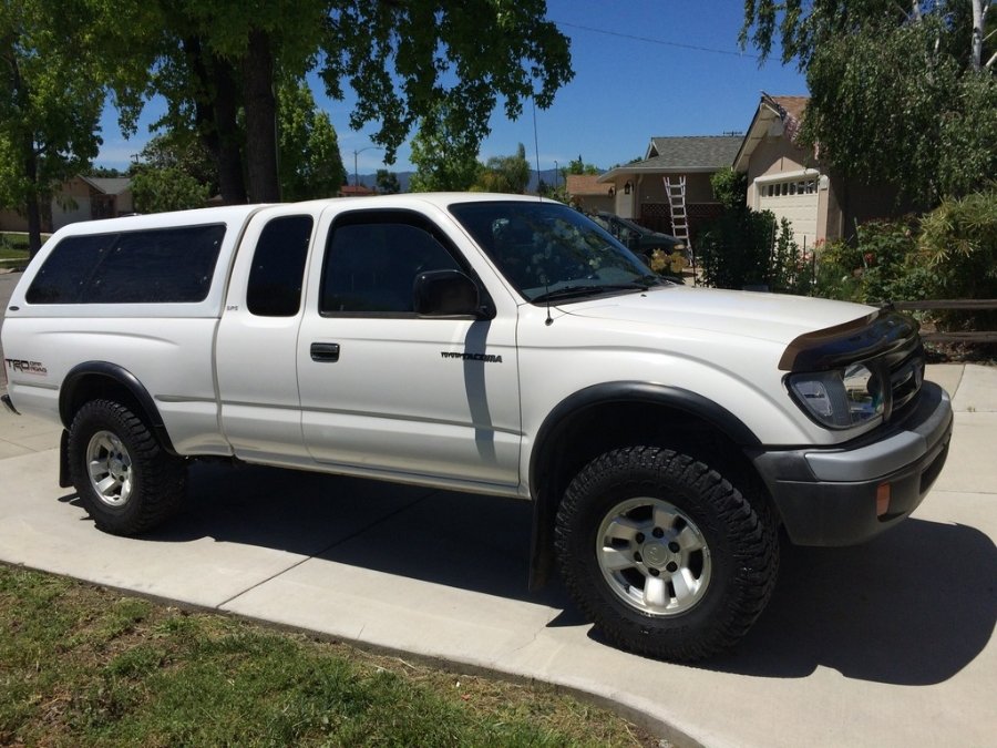

    Washed, clay barred and applied Griot's one step sealant with a polisher that I picked up from Harbor Freight. I typically wax once a year to keep the clear coat in decent shape, but the waxes do not stay on that long. The Griot's has a synthetic polymer added to the sealant and they state 'long term protection'.
    First impressions are pretty good, it leaves a very shiny look and feels very smooth. We'll see how long it lasts...
    Hard to believe that this truck is going on 17 years... (purchased in 2000)
