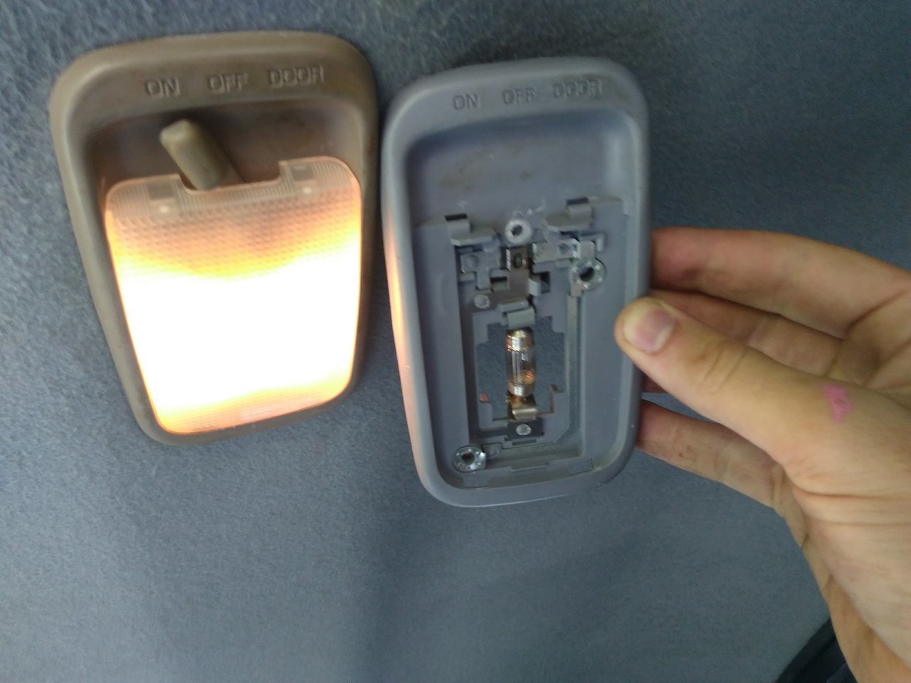

    1. Swapped a broken vanity light with one from an '01 Tundra: (Tundra is the brown one that doesn't match) :)

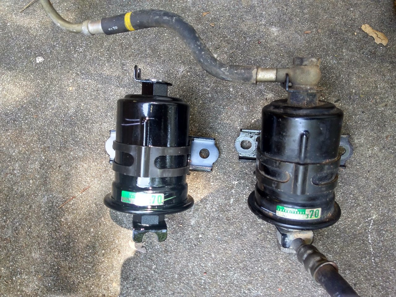

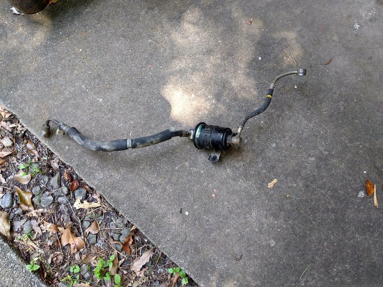

    2. Replaced my Fuel filter (biggest mechanical feat I have ever attempted, It took me several hours and I'm very proud of myself.) 2.7-pain in the ass to remove. I think I learned some new yoga positions. IMG_20170708_133649576_HDR.jpgIMG_20170708_133710413_HDR.jpg
    Special thanks to Moco (don't know how to tag members) for the writeup on this! I didn't remove the wheel (didn't have the proper lug nut thingy with enough leverage) but overall followed his advice.

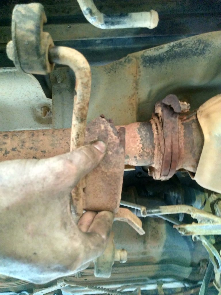

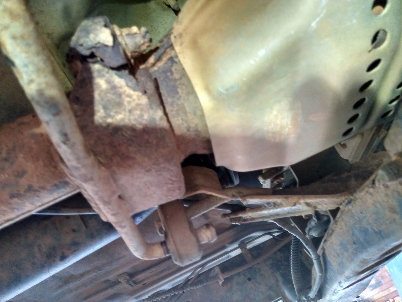

    3. I found the source of a rattling noise that would occur when I started my car and it got louder when I would reverse backing out of my drivewayIMG_20170708_144945037_HDR.jpg
    The back end of the guard covering the catalytic converter had rusted through and the two halves were rattling and grinding together. So I just cut it out! My exhaust system is the only rusty part of my frame (thank goodness) but it will probably need replacing soon.

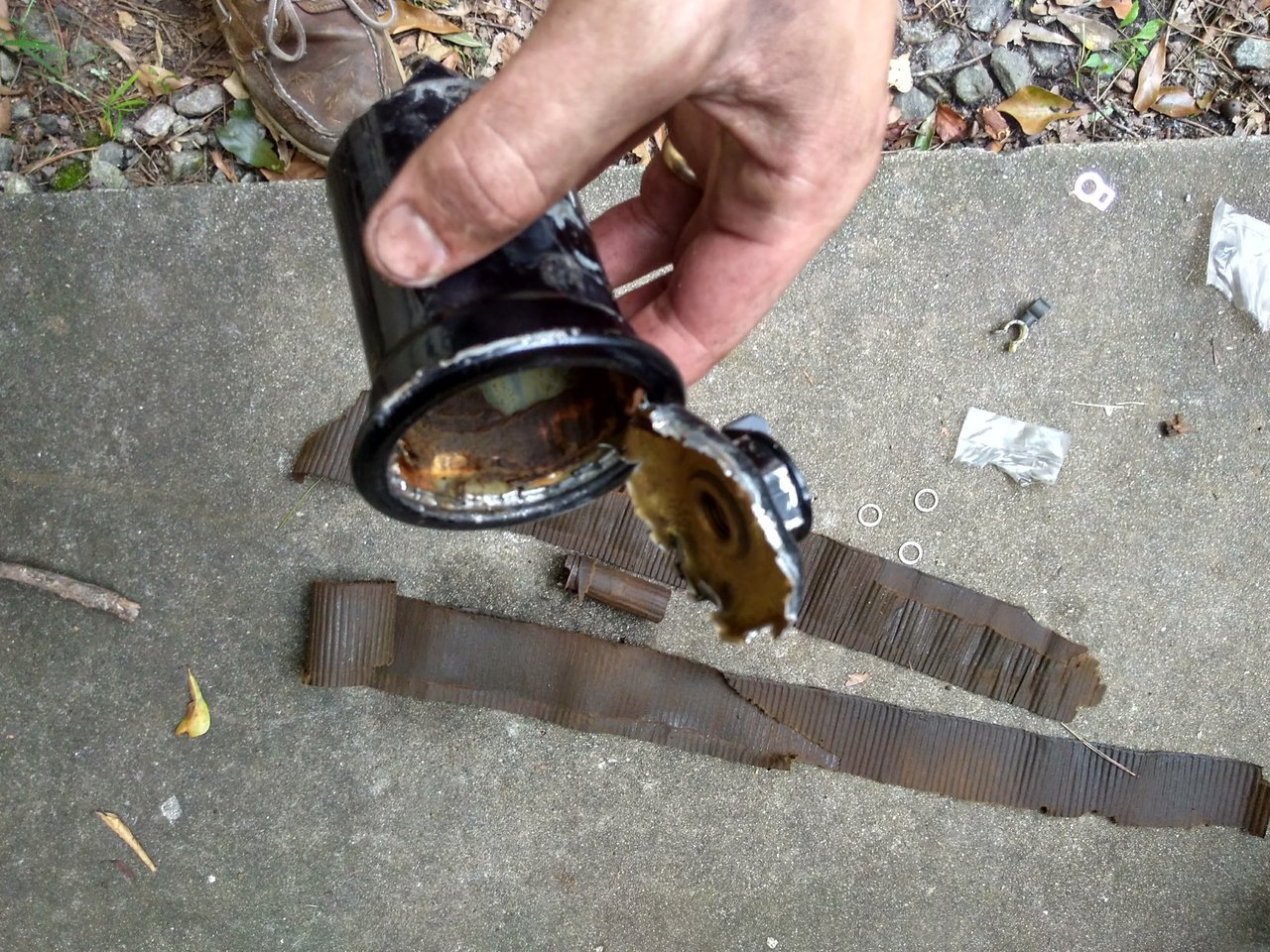

    I also cut open the filter to see how dirty it was:
    It was the original filter, 17 years old and 205K miles. I've seen dirtier fuel filters.

    Funny, I just cut that shroud off the wife's Tacoma a month or so ago.

    Oh! is that the proper name for it? You mean the thingy that covers the catalytic converter thingy? :)

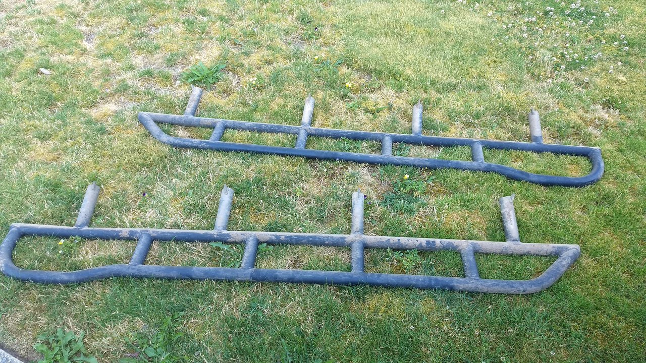

    Also I clearly bent one in the rollover, but it's minor enough to not fix

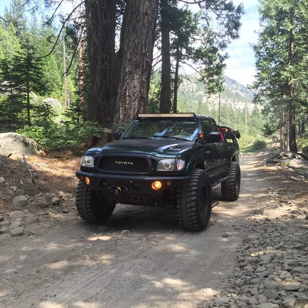

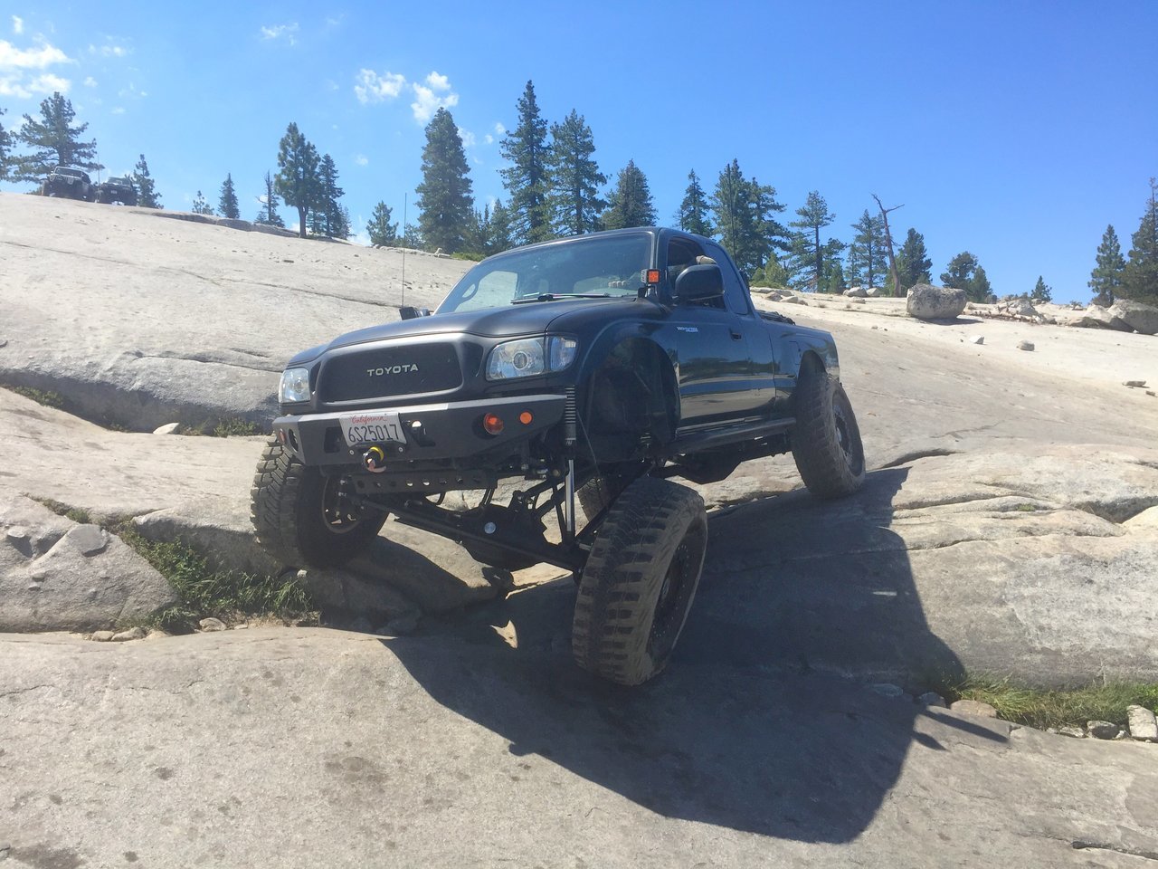

    I was super low when I had the 35s on, loved the look! This is still my favorite picture from that setup because the tires look so huge!
    That combo is long gone now though, here's a pic from Thursday on the Rubicon. 37s and Trail Ready beadlocks.
    Thanks for the reply!

    It looks epic. I'm just on Billies and armor now but thinking of going scs sr8s with this set up. How much cutting did you have to do with the Icon 3 inch and uca? Was it a lot of rubbing?
    New set up with the sas is pretty awesome btw.

    Fitting 35s requires tubing..aka...cutting the firewall back a lot and welding in now sheet metal. It also requires regearing if you ever want to use the truck nicely again.
    Its a 3000 dollar mod easily to do it right.

    Oh ya, it rubbed a lot. Look how close the fender is to the tire. Monte is right I did have to tub. Although now I wish I had never done that because the front is so far forward now from the SAS its not even close to the firewall hahaha.
