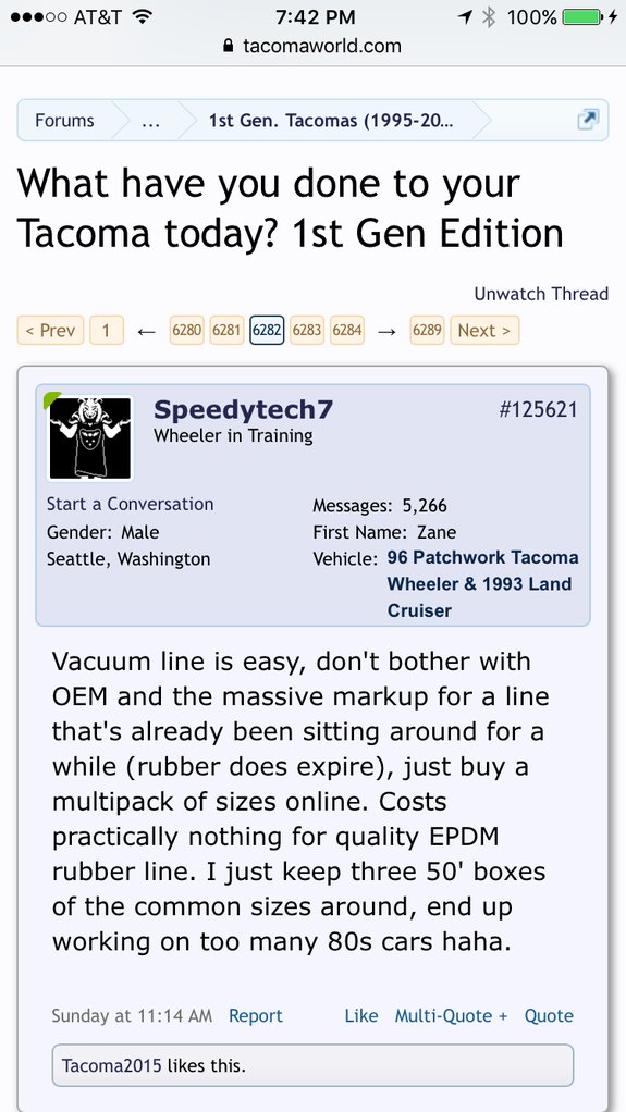

    That's a new way to quote haha, but yeah save some cash and just match the inner diameter of the vacuum line and order a 10ft roll for cheapo.
