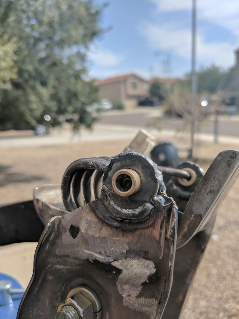

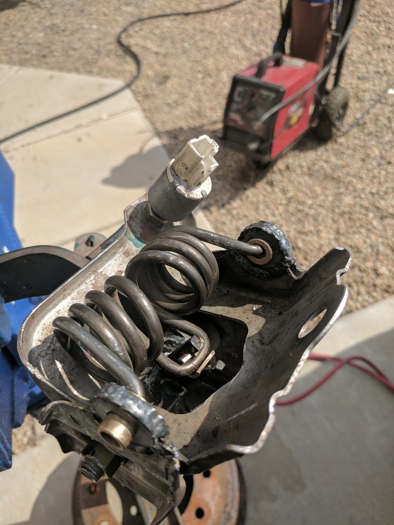

    Mini writeup of my adventures.
    Had to replace the clutch pedal bushings again, and as this was the third time it was extremely straight forward and I knew what to expect.
    Because it was the third time, I decided to try brass bushings instead of plastic. Big improvement and I highly recommend it. The spring itself had worn through the stamped steel bracket so some welding was required. I used washers that were a thousandth smaller then the O.D. of the bushing. I had the bushings on ice so when the washers were welded on, I just dropped the bushings in with the bracket still very hot from the welding and when the temperatures equalised, it was like I planned it. Worked well.
    I do not like the center bushing, but it took me three trys to get this one to work. It still has a crack in it, however a I ran out of material and cool Arizona morning weather. I initially wanted to solder or braze it in, but I used oil impregnated bushings, and lets not forget that steel/brass dont like to be brazed (by amateurs)
    I also had to use 1/4 I.D. bushings because of cost. They are too big. The correct size is 7/32 I.D. the cost difference is bout 14 dollars. Each.
    Disclaimer: Excuse the booger welds.
