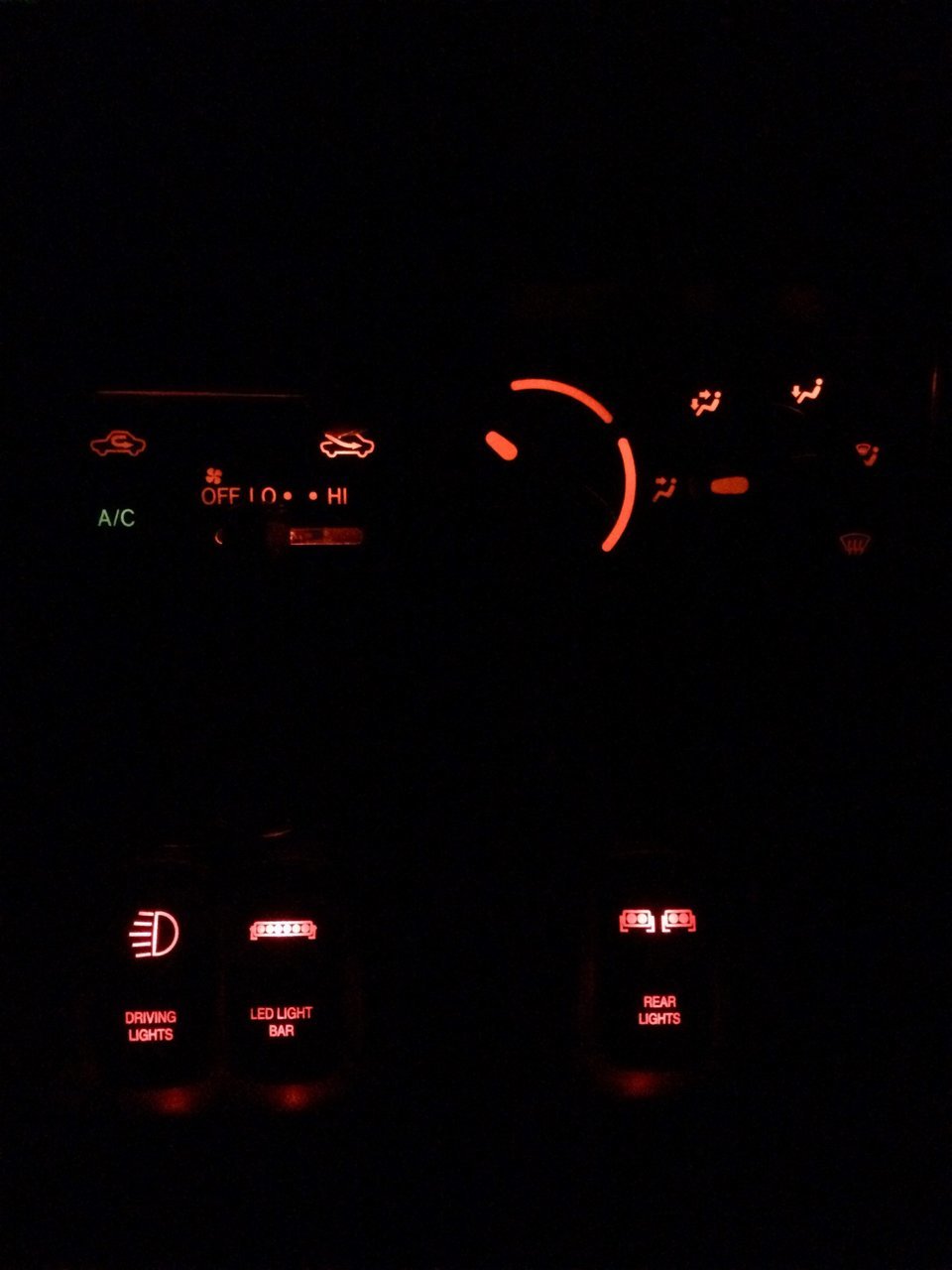

    The A/C control panel used 3x NEO4 from SuperBright Leds. The switches I used the same NEO4 bulbs x3 but modified them, write up here. On the dash I replaced all the red warning indicators except low fuel with these from Amazon and the actual instrument cluster lights I used these from Amazon they also work in the third brake light. For the shifter I used this one from Superbright.
    For the cup holders I drilled a 1/16 inch hole then glued a small white plastic spacer with an 1/8 hole in the center to the backside of cup holder. like this one, I picked them up at ACE hardware.
    2 12volt red LED's like these from Amazon drilled the spacer just a little so bulbs fit snug. Wired them into the shifter light.
    The backup bulbs are the ones I linked to in my original post.

    Interesting with regards to the "cold" range on your temp dial. Do you have light transmitting through that section or is that just glare?
    On mine the blue paint completely blocks any red light transmission:

    Hm, mine don't shine all the way to the right and one didn't work from the get go. Yeah, I turned it 90 and 180. Yup bought it from superbrightled's.

    There just that bright the make it glow.

    So light shines through?

    I received 1 that didn't work and 3 the wrong color. But superbright took care of it no question asked.

    I think it bleeds around it thru the plexiglass
