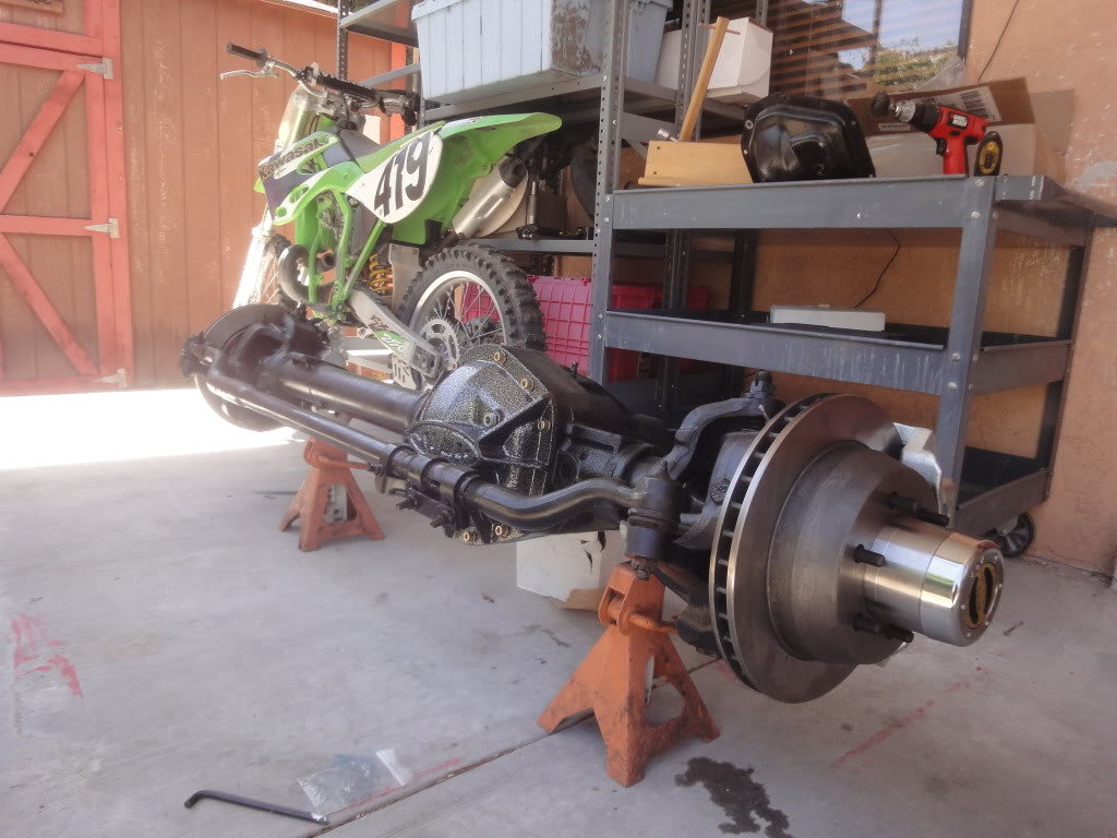

    here we go. Ford 9" rear after breaking 5 sets of gears in the stock yota 8.8, 5.13 gears with a detroit hard locker, 63" chevy leafs and custom hangers, sky's front spring hanger with sky's extream hysteer and PSC hydro assist ram and PSC pump. welded front spyders in the f-550 front dana 60 with warn hubs, pico brake lines and hoses, elecrtic fan, TRD supercharger with URD 2.1 Pully, URD Map-ECU2 and cage built by me. wide band a/f by inovations, lots and lots more...........
    DSC02776_fa03cf7eb7dd4667f0d5439758c7f721b2e33831.jpg put this together

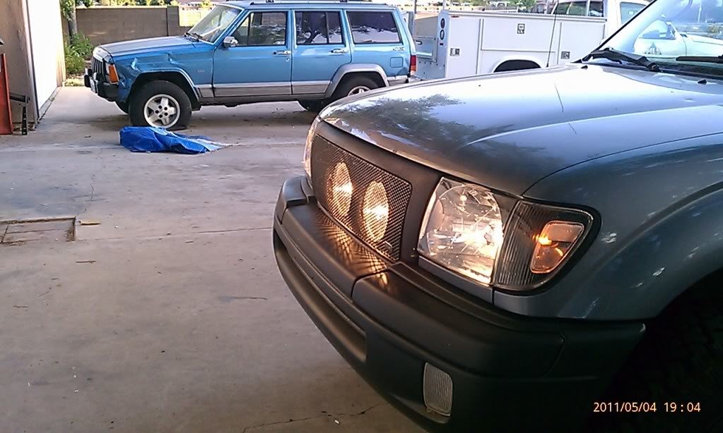

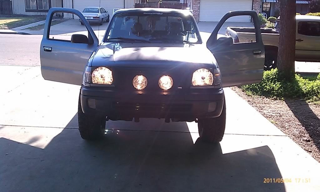

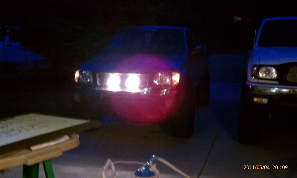

    installed hella 500ff behind grill

    Tht looks good

    now thats badass. didja do a write up?

    well they're hanging upside down i made a bracket with the help of THExBUSxDRIVER we used to factory condensor hanging bolts.... ill try snapping some pics

    Looks good! I see you gave up on finding a light bar ... :rolleyes:

    ya pretty much, i didnt want to fork over the $250 for a defiant, plus i have something in the works for a new front plate bumper, therefore light bar would be obsolete, so this will work for now :D

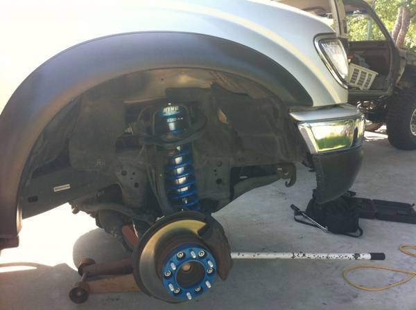

    Putting these in before work. Thanks DSMS

    That looks sweet!

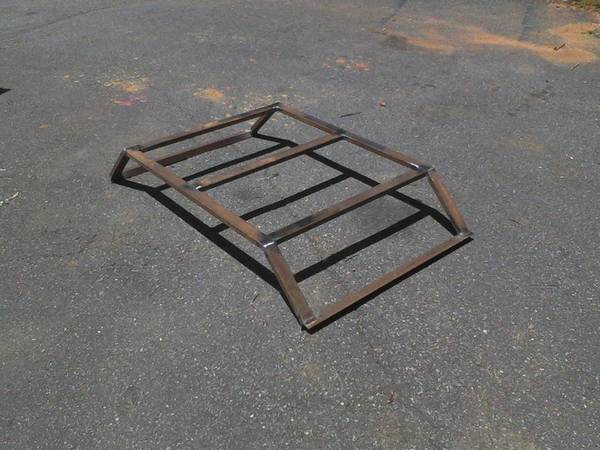

    decided to finally build the baja bed rack i have wanted so badly. didn't feel like spending $600 on one so i gather some steel laying around the yard and got to it. here it is half way done. when finished it will have a spare tire mount underneath and tool mount on the 40 degree legs made out of rail road spikes. gonna also use blue lexane i have as a bottom for the basket. cant decide if i wanna put sides around the top thought. thought about using rail road spike for legs and threaded rod for the basket sides. opinions?
